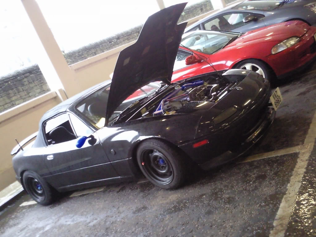

Well I'm not a great fan of the stealth look I seem to be taking on, but I'm not sure which colour I want to use on the '5? It will only be in small areas like the wheel centres and strut brace and maybe the rocker cover (which is purple atm). Any ideas or shops to see what colour would suit it best?
Any help would be great guys, thanks.

hadnt really considered blue, mirrors will be staying black and it would be the whole centre of the wheels not the hub bit, but blue looks good mate cheers!

Blue looks okay but i'd go red!
Also get some wheels done in Red!
  LY R26
the mugen reps mate,
the wheels do have stretch but the profile is high, might look for thinner tyres but these are basically brand new that i got for nothing so will do for now.
think red is the way it will be heading!
