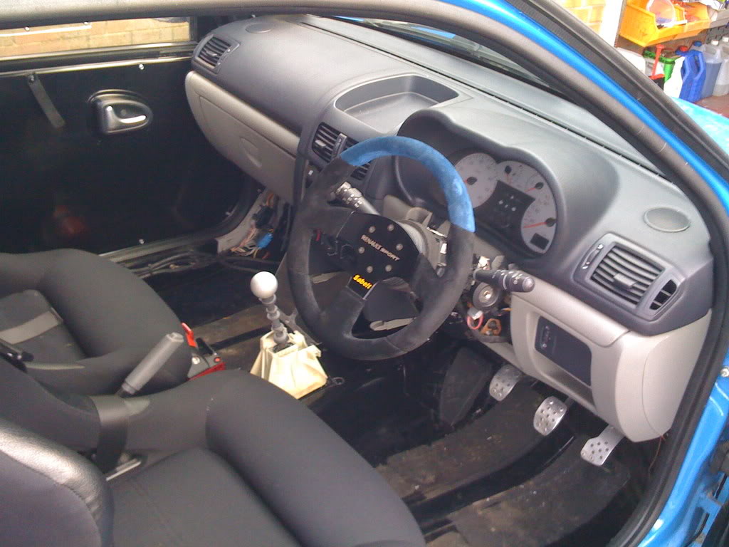

now got a Cobra Evolution for driver seat
  Clio 172
From reading the handbook it says the car weighs in at 1035KGs. The car has had all the rear stripped out, 2 buckets in the front and steering replaced with lightweight sparco, so not really extreme stripping, but would like to think its somewhere under a tonne.

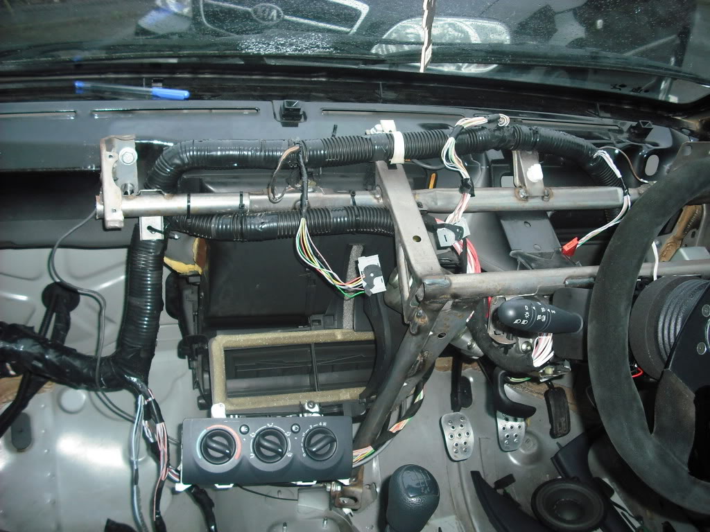

I'm glad dash is going back in....think they look fecking pikey when left out. Turner left his out on mkI Astra.
Dash flocked?
