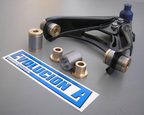

Clio solid wishbone bushes
  Clio172cup rally car
Just seen these
Was thinking of putting them on the rally car, but would they be to much??
Ye was thinking that, I've already got powerflex bushes and I ruined them in one event, so was thinking of getting these or the pure Motorsport ones, but if I do change to solid bushes will I be putting to much stress on anything else?
  Dodgy one
Id have though the brass bushing wouldnt last long, IMO someone needs to come up with a design that has bearings in,
I'm not that impressed with my polybushes tbh i had to shave the sleeves down a smidge due to being paranoid about them cutting subframes, i kept checking them then after a few week once they settled a bit the sleeves got very close to the subframe and would knock when braking, standard ones are pretty good though they last a while but arent stiff enough
Did you not weld the sleeves in place?
