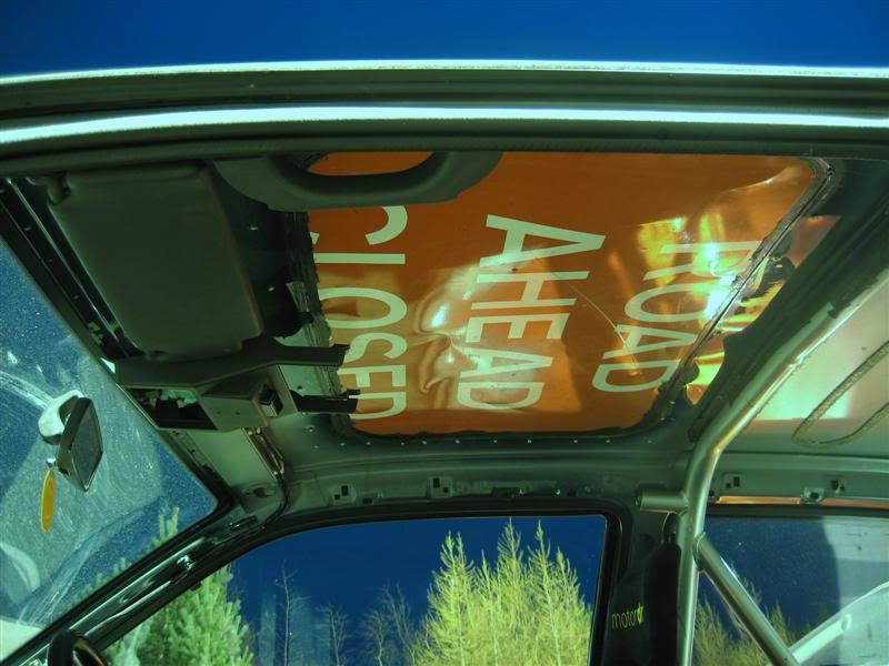

Best mate Djw Dave did.....
Pop rivets and silicone

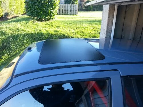

Most of the time people seal the sun roofs up and forget that its the Ariel base thats leaking!
Yeah i have, had a panel laser cut and powdercoated to suit...... then fixed with water tight rivits.

Ah ye thats mostprob why water still got in and wrecked the immobiliser . Did they use the sunroof as a template to cut it ? I want a finish without rivets so could be worth fibreglass and then skim with filler to get a nice finish

you could try to skim the roof, but there is ALOT of flex in it so it would end up cracking. Many have tried and failed, and you cant hide what has been done.
My option cost me about £45. You could buy an entire roof skin from Renault.....but thats 4times what you paid for your entire car.
Or you could buy a Carbon roof panel...but thats even more!
