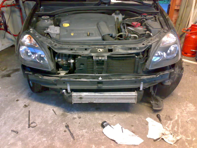

Yeah no A/C to worry about here I/C and remap here i come lol You got any pics of it fitted or dimensions of the I/C at all
Reckon any I/C will do ? off he pops to look on ebay and googles how to fit I?C Edde ???
dcioffice.net is down i'm going to contact the owner and see whats going off, that had a lot of good info.
here is a pic of the intercooler:
custom brackets were made, very easy tbh just a stick of metal bent at 90 degrees in a vice and some holes drilled through.
any IC will do you just need to make sure the pipes are going to fit.

Just priced up injectors OMG £470 for four Rip off Renault lol
Modus IC on ebay just not sure how it will fit different shape to yours Mac
