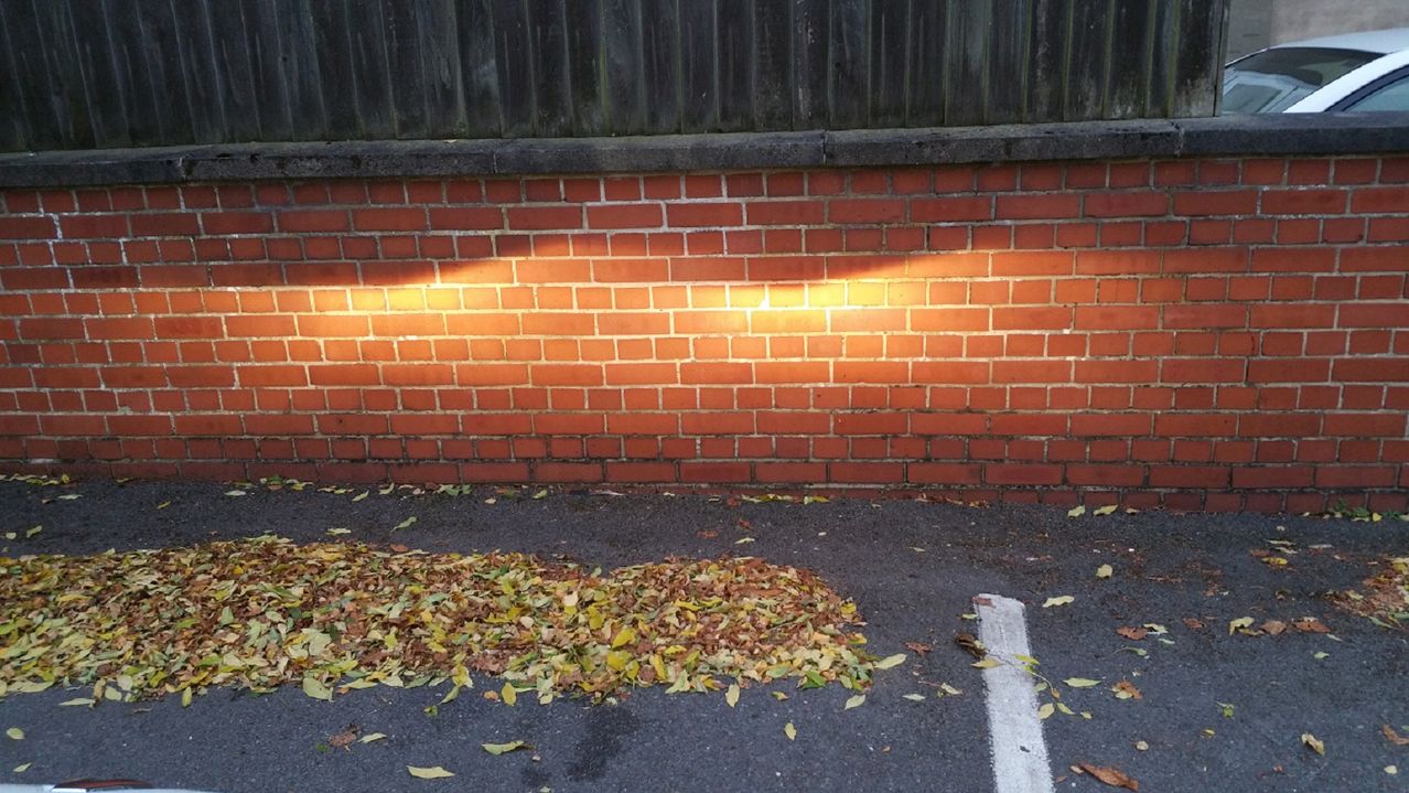

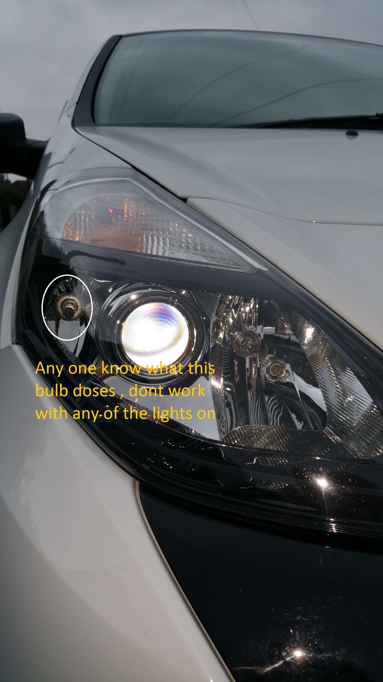

Hi don't know if its me or something wrong the headlights on my Clio 200 seem to be lighting up the opposite side of the road more than the left side any help would be great pic of the lights on the 200 attached i will attach another at night as well
  Clio 200 Turbo
ive took a picture at night against a wall you will see what i mean lighting up wrong , if anyone could take a pick of there 200 beam pattern would be great

They're set up for LHD. You may be able to swap it over using a lever inside the headlight, if the Mk2 Ph1 headlights are anything to go by.
Unused bulbs are cornering lights, have to be activated in CLiP.
I'm guessing your car originally had reflectors, and someone's retrofitted projectors, but they've bought some from france or somewhere else LHD.

Thats what i was thinking , dam ill have a look to see if i can adjust them , what would the leveler look like?

just got a brand new set of projectors and fitted beam pattern is spot on now , if anyone wants some projectors that are made for right hand drive country's let me know

If you find someone with a clip, they might be able to turn the cornering lights on for you.
