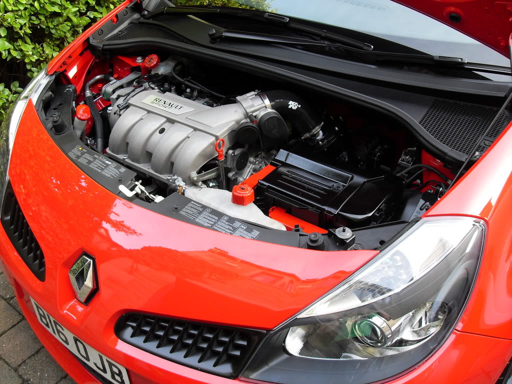

Car was standard running 192bhp yes, to get 211bhp i had cams, decat and yozzasport exhaust and matched inlets with PTFE gaskets to suit.
Induction setup is standard airbox with Panel filter and heatwrapped, slight gains to be had from Induction kit but its alot of money/hassle, best speaking to kevo about that.

Had the Apollo myself, well bought it but never fitted it. Was told it actually lost bhp.
How did you find it after fitting, it looks the tits but dont wanna risk power loss.
  Clio RS 197
i didnt think it was any worse!
but the noise would make up for a slight loss IF it did loose anything!
get it wacked on!
not considerd the 3.0l air box?
