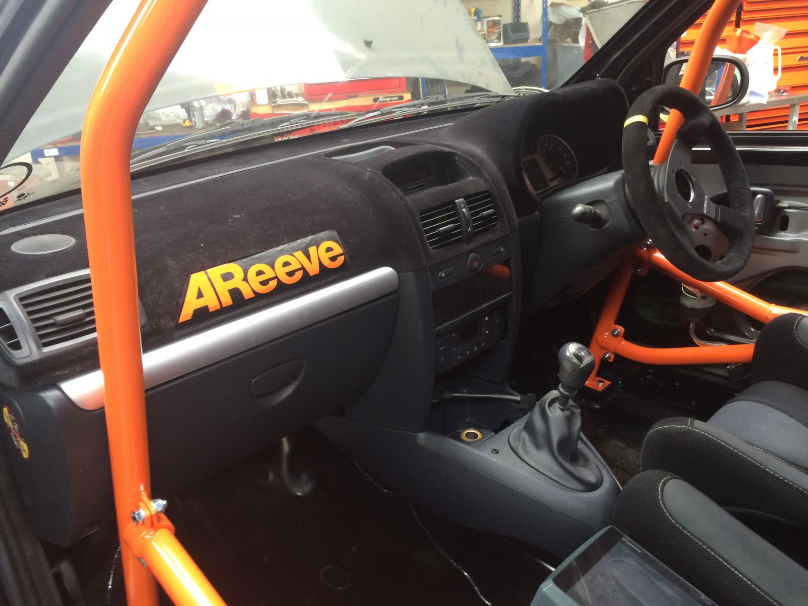

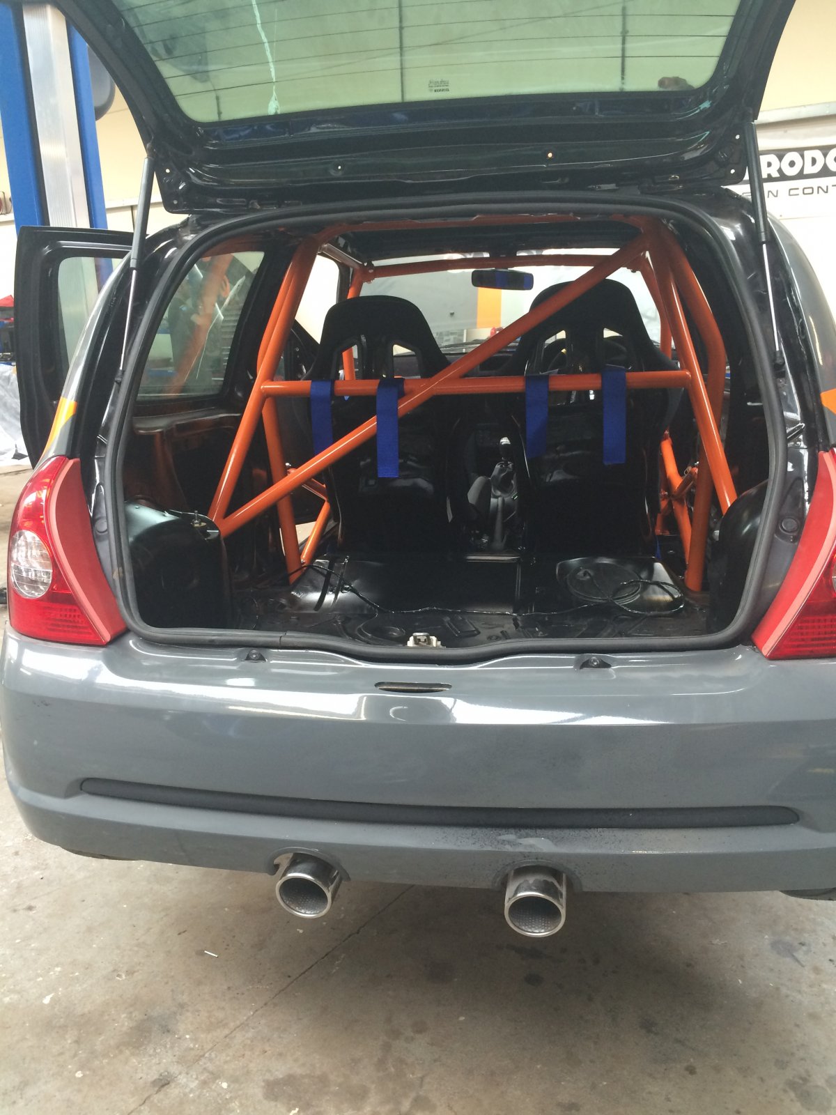

This is my Clio 182 track car (non-road legal).
Spec is as follows:
- Carbon Lorraine RC8 front pads
- Carbon Lorraine RC6 read pass
- Braided brake lines
- Dot 5 fluid
- Standard discs
- Stud conversion kit
- 8 team dynamics wheels (1st set with Dunlop direzzas & 2nd with Michelin PS3)
- Spax coilover kit - 750mc spec http://www.k-tecracing.com/show_product.asp?id=4776&appid=2
- Ktec solid top mounts
- Powerflex black series bushes inc dog bone mount
- TTV flywheel
- Gripper diff
- Helix organic clutch
- High lift cams
- Enlarged throttle body
- Ported/ polished inlet manifold
- ITG Panel filter

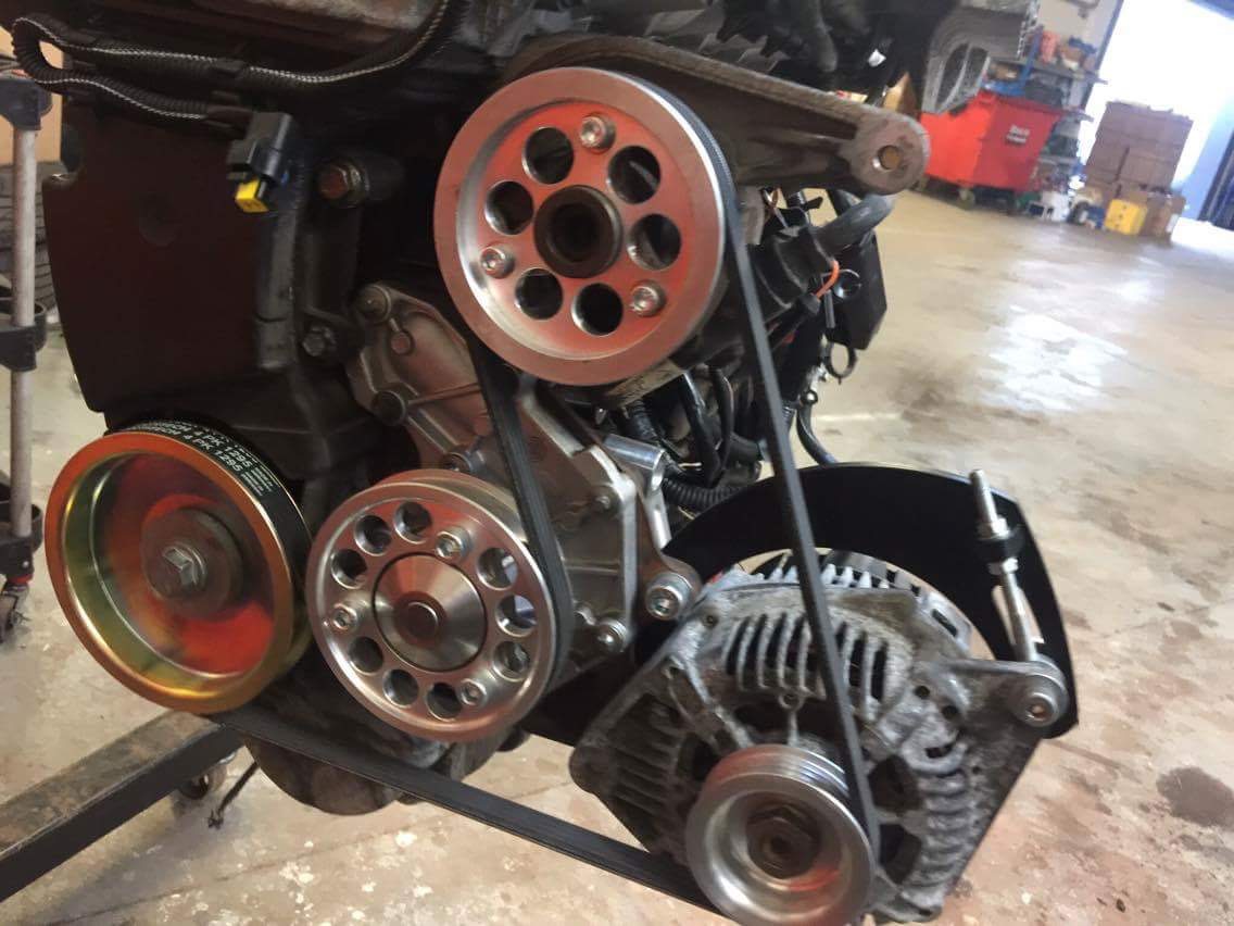

- PMS AC delete inc lightweight pulley
- Yuasa battery
- Miltek decat exhaust
- Flocked Dash
- Oreca steering wheel
- Stripped wiring loom
- Safety Devices cage
- TRS harnesses
- Cobra bucket seats

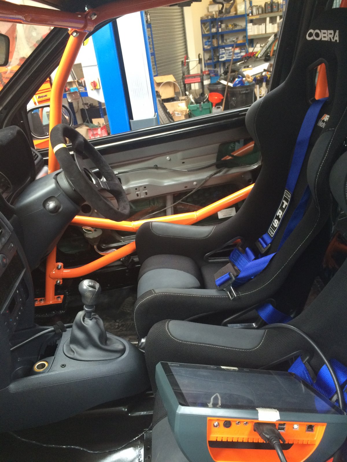

- All interior stripped, brackets removed and interior sprayed/ lacquered
- New track rod ends LH/RH
- New lower ball joints LH/RH
- New calipers NSR/OSF/NSF
- Full service (spark plugs, oil & filter, belts, water pump)

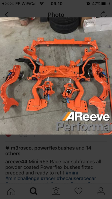

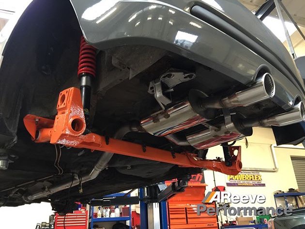

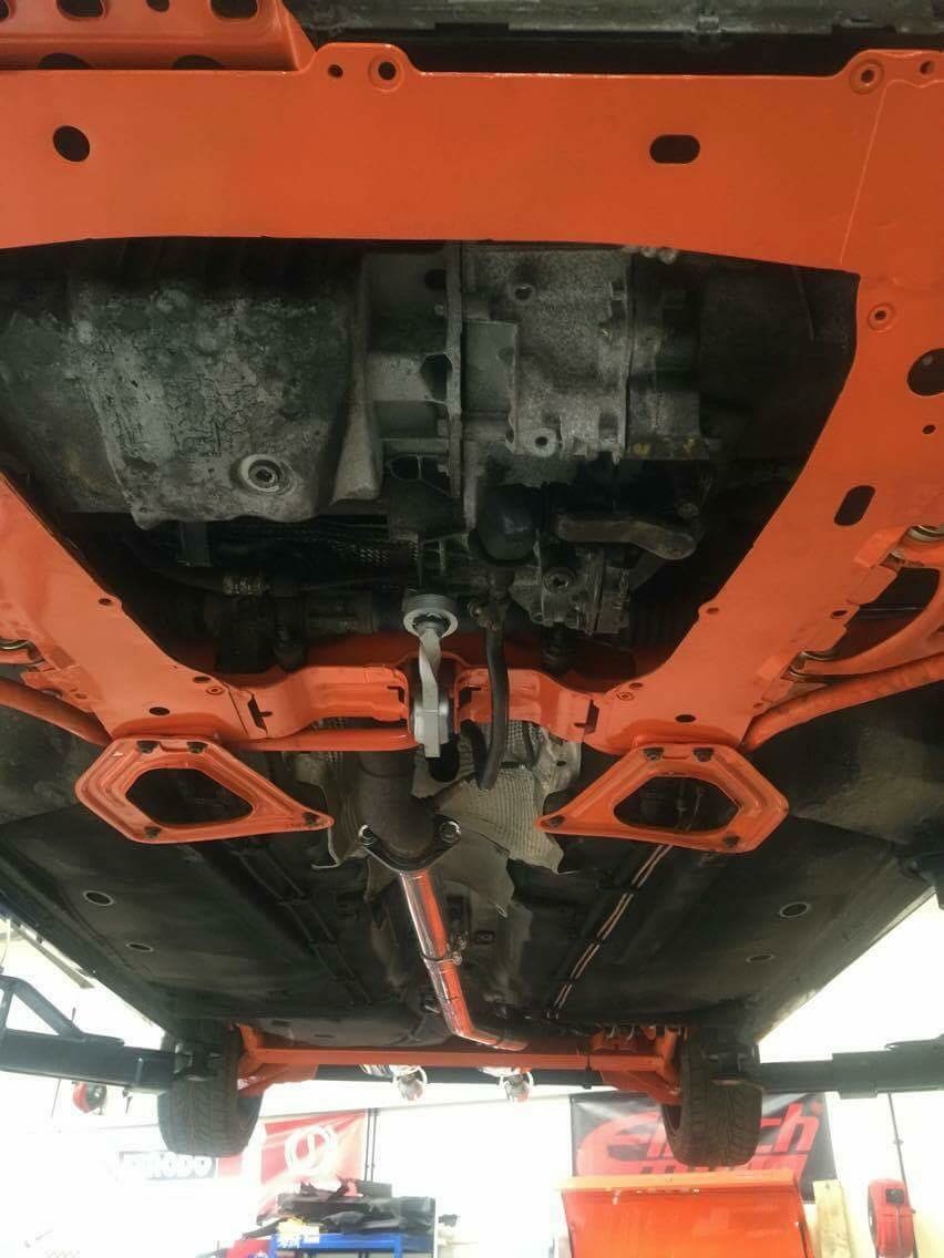

- Shotblasted & powdercoated subframe & rear beam (inc roll cage)

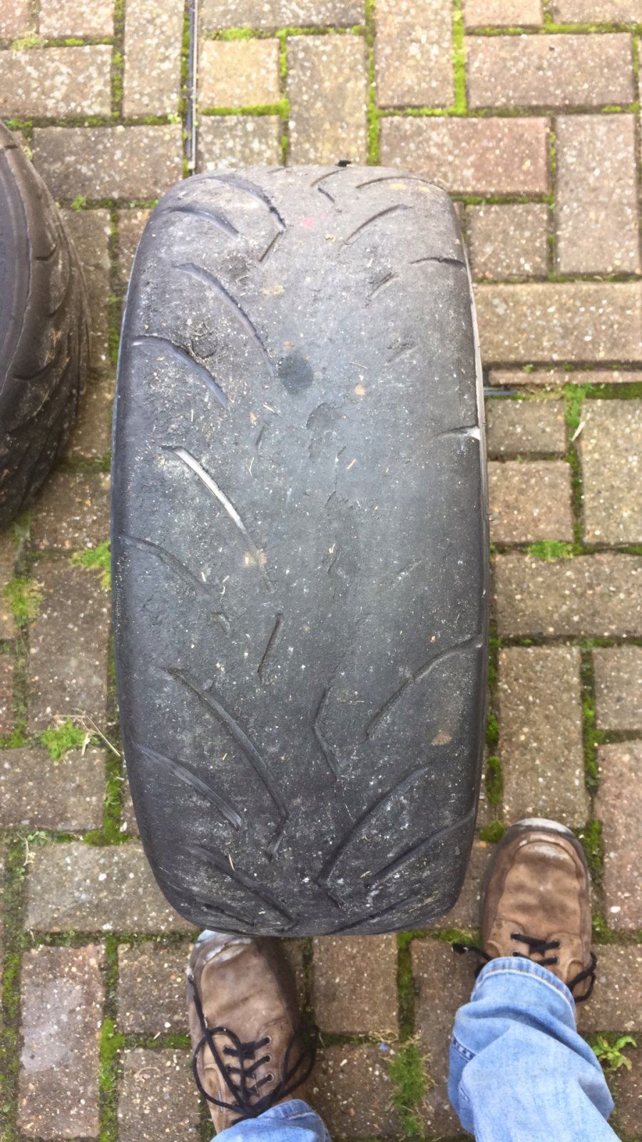

I was up Snetterton yesterday on the 200 circuit, not as fun as the 300 but stil good. Flat spotted my fronts though :(
  Clio 172

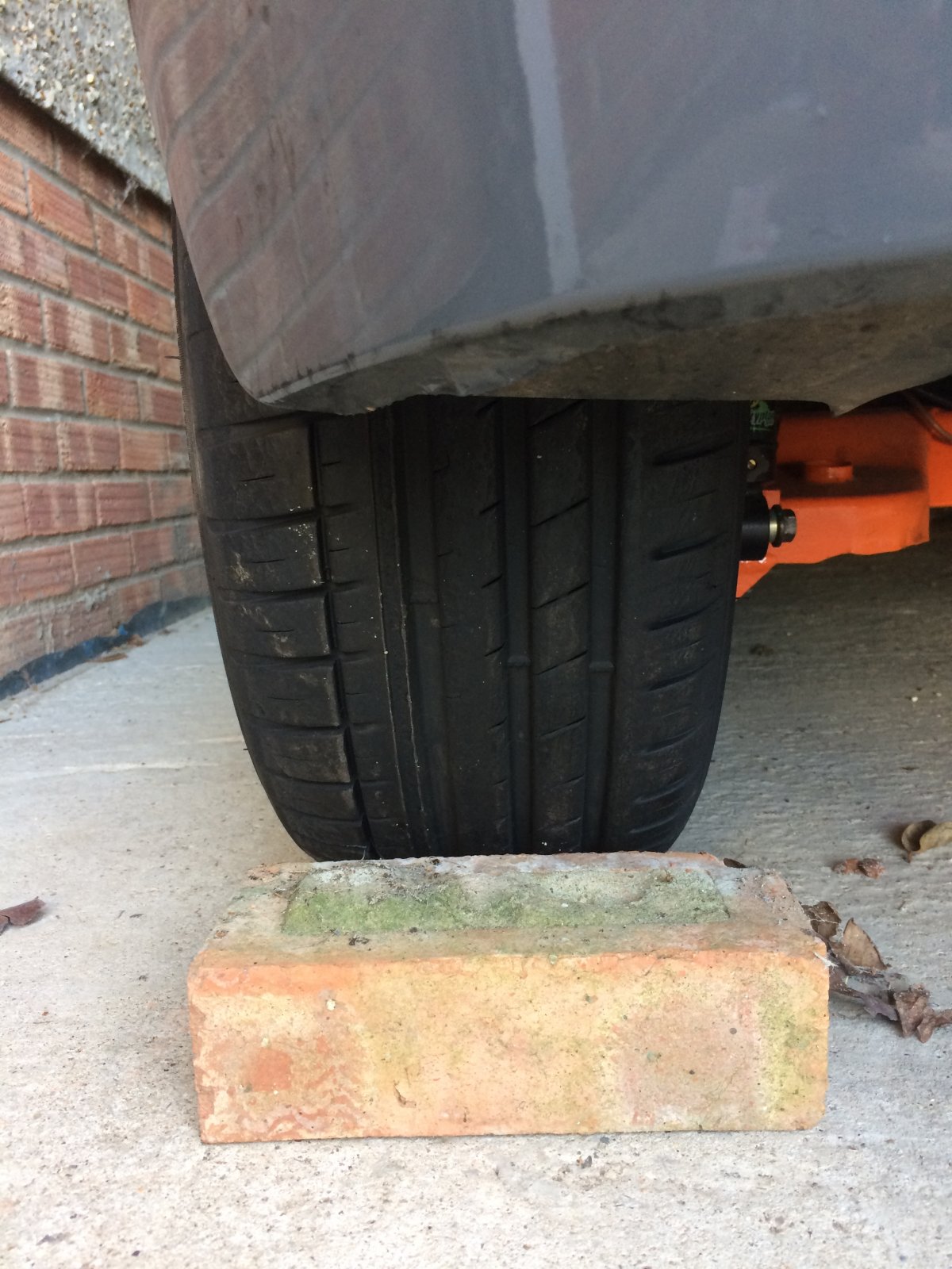

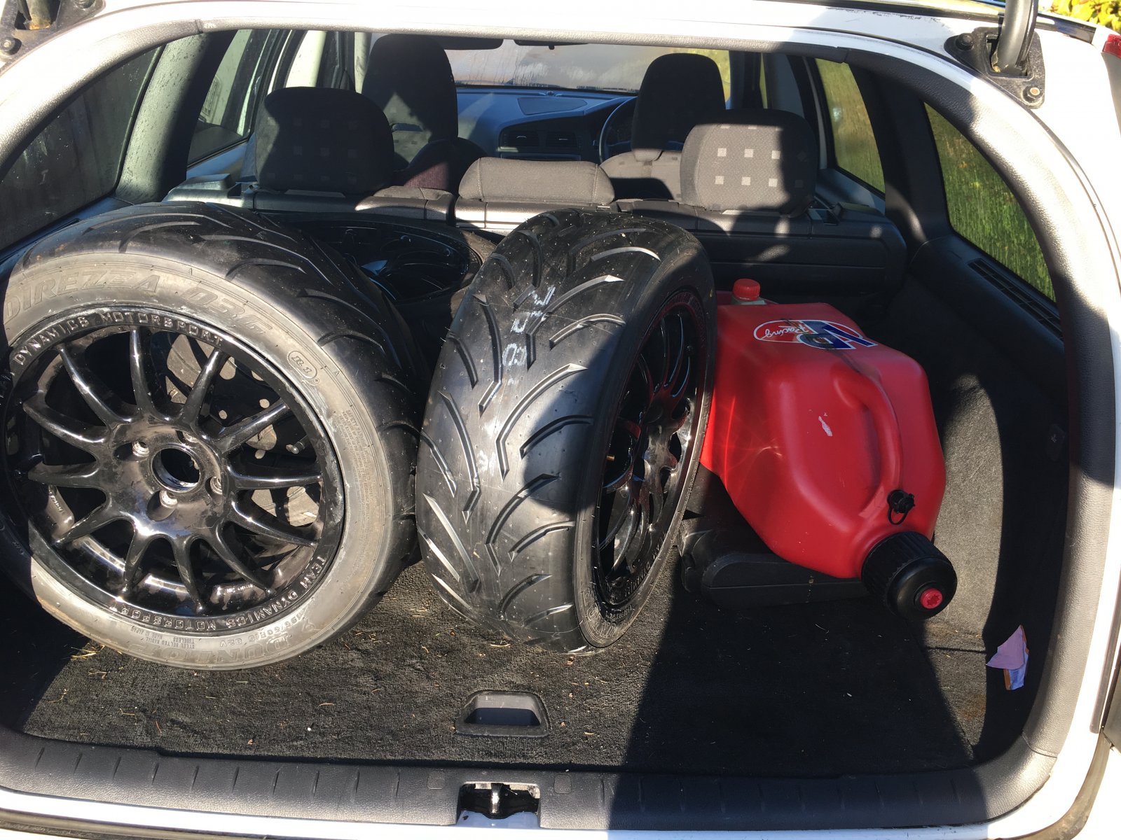

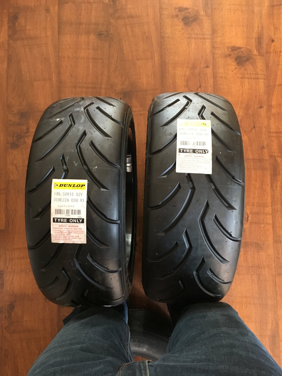

Flat spot tyre from Saturday, only been out for two trackdays:down:
Wet tyres fitted in anticipation for November

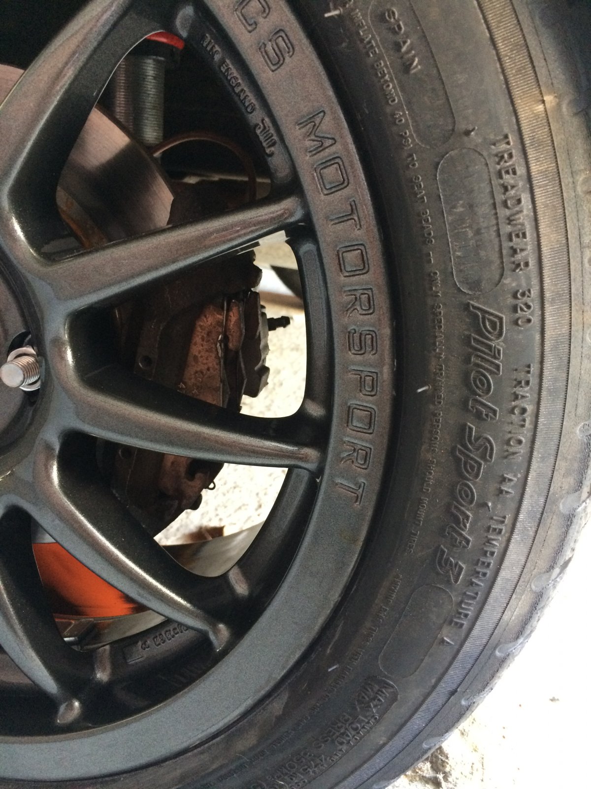

Had new tyres fitted to my wheels, one of the old tyres I was able to keep as it wasn't in too bad a condition

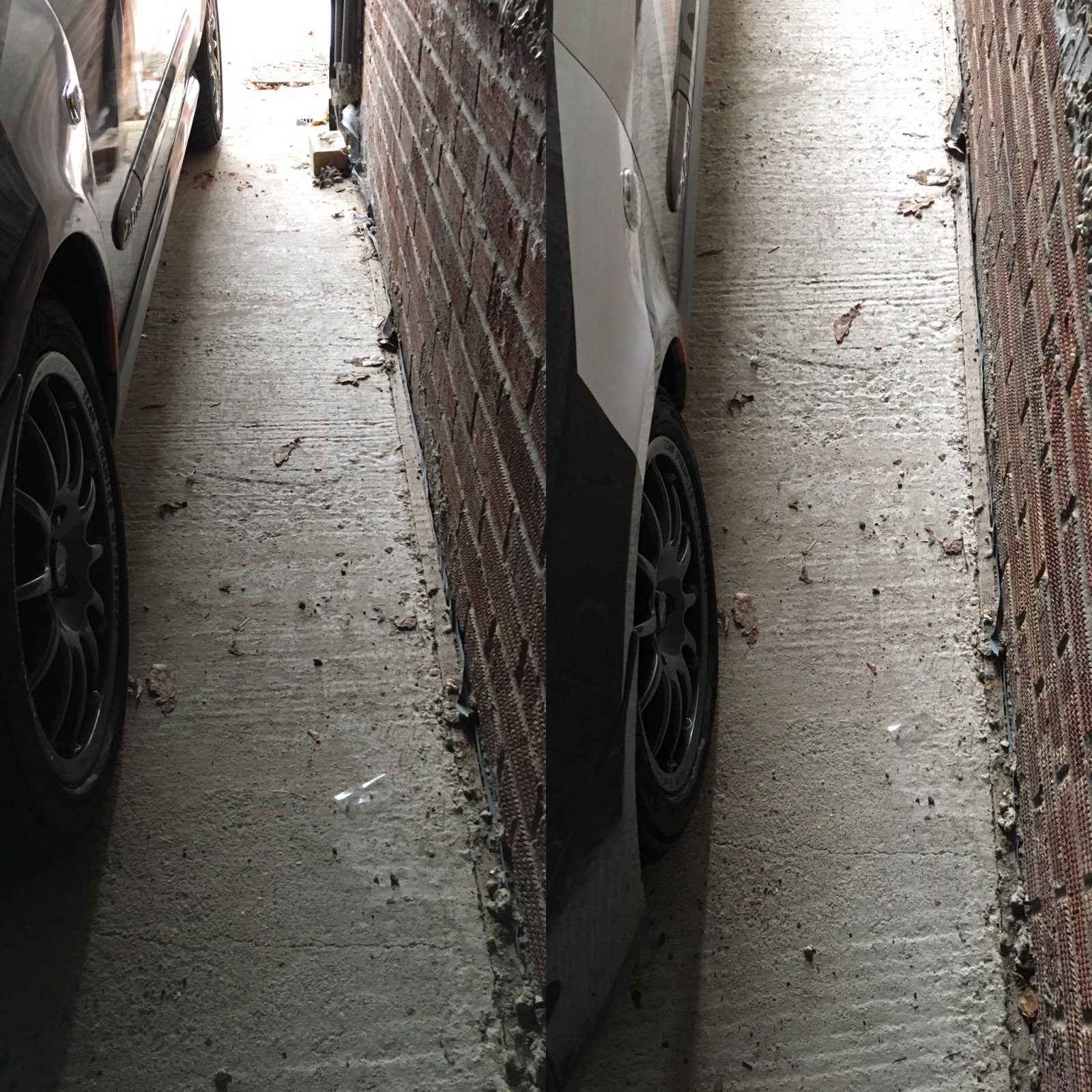

Replaced the passenger side CV gaitor clip yesterday as the old one wasn't tight enough and not very wide and added some fresh grease. Bit of a tight squeeze getting in though with the space between the car and wall so a had to sit on floor with legs stretched out and head under the wheel arch lol :laughing: whilst the wheel was off, I also re-loctited the wheel studs as they were loose and also did the driver side ones aswell.

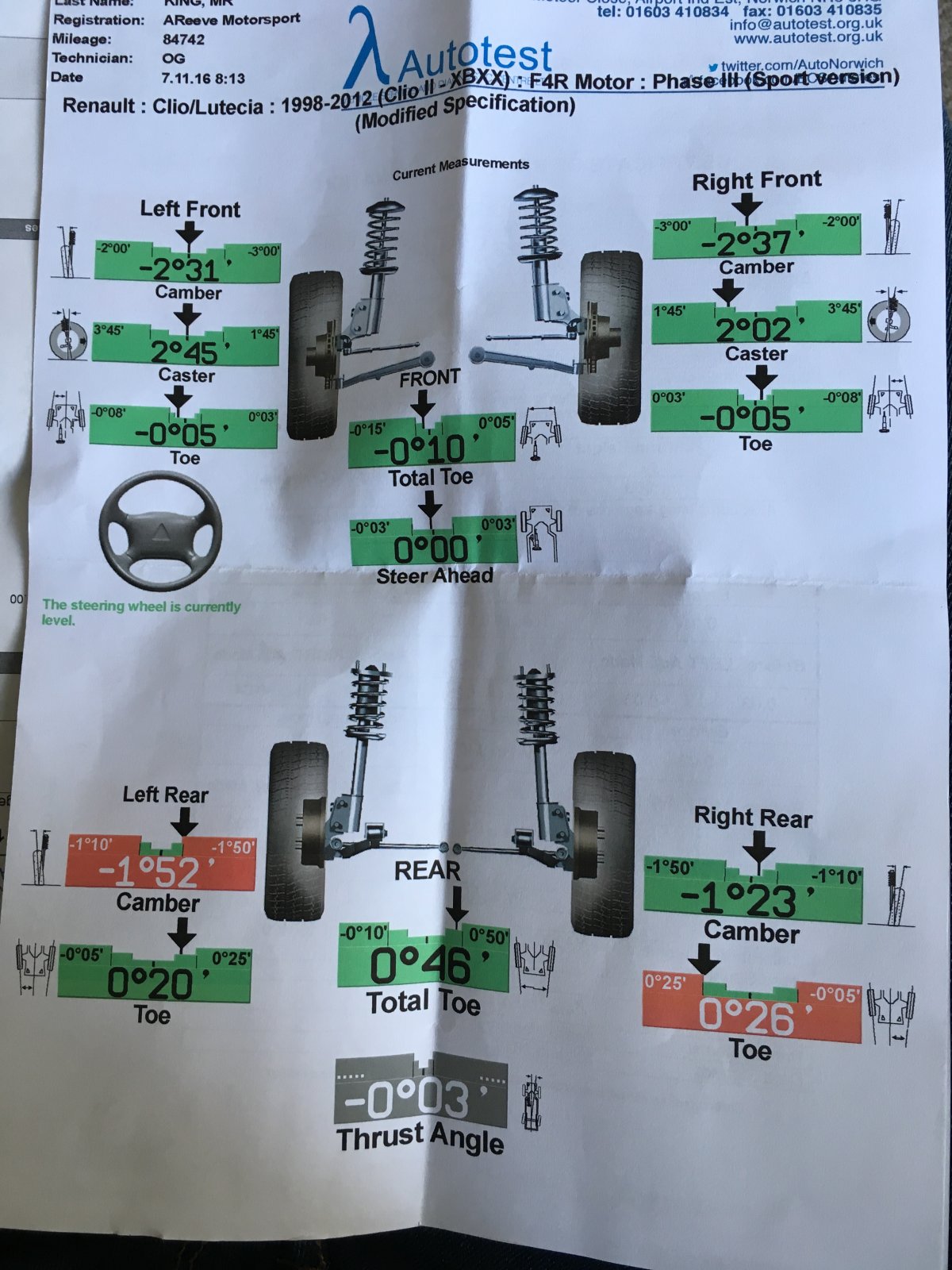

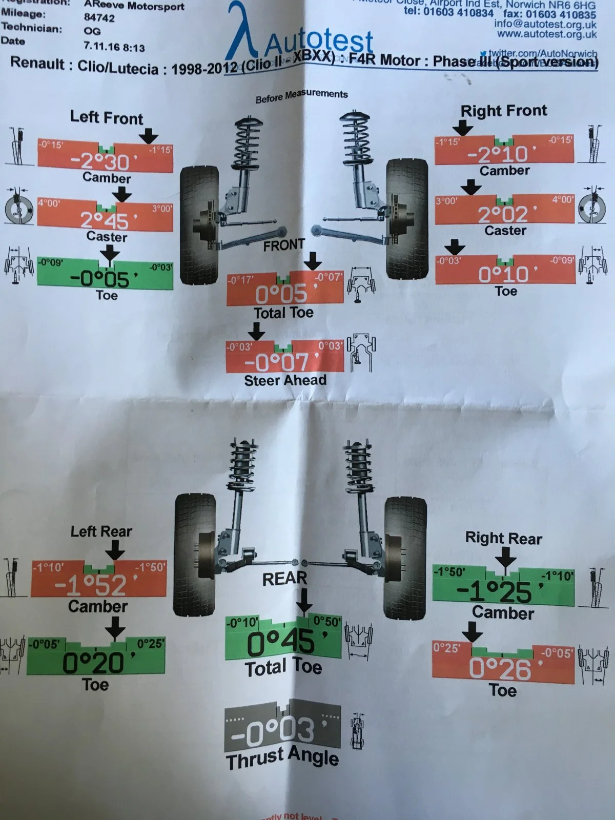

Had wheel alignment checked today, slight adjustment needed on camber and toe
Before:
After
All filled up now and ready for Snetterton on Sunday:tongueout:

Just ordered the pure motorsport rear toe/camber shims 0'20" to get the rear toe from toe-in to neutral

So I ordered 20min toe/ camber shim from PMS but I only ordered one lol. Just ordered the 10min toe/camber shim:tongueclosed:
When fitted, I'll have 0'10" toe-in on left rear side and 0'06" toe-in on right rear side so close to factory settings.

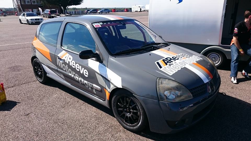

2 photos from Sunday at Snetterton

I've also ordered the 30min shim from PMS.
So in all, the 10min shim will be fitted to rear left for the toe and the 20min shim will be fitted to the rear right for the toe along with the 30min for the camber.
In total, it should give 10min toe in left and 6min toe in right and -2degrees camber both sides

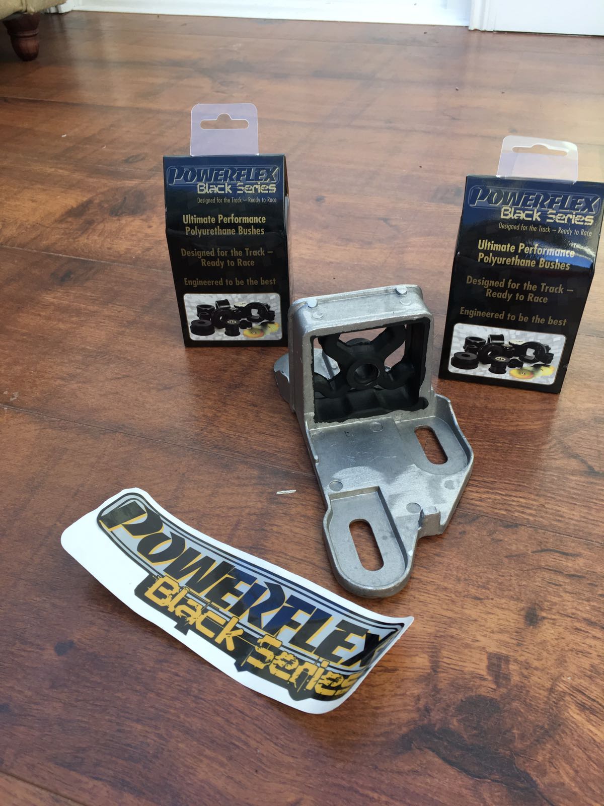

Fitted puremotorsport shims to the rear RHS of my Clio 182 track car. However when removing the stub of the axle, 2 of the 4 heads on the bolts were fubbard! Must have happened during the build:down: not happy after money spent to find this! Going to order new set of belts from PMS to replace bolts on both sides. Only fitted 2 bolts atm as needed to put wheel back on to get car into garage. Will do the LHS shims/ bolts along with the RHS bolts when get back offshore in 3 weeks.
Also, when doing the shims noticed that the bush on the exhaust is also fubbard and it's only got one mount on the rear:down: again, not happy to have to get another mount And bushes! Will order a new mount aswell and 2 powerflex bushes.

New exhaust bushes and new exhaust machines mount has been delivered at home, so will fit these when get home from offshore.
