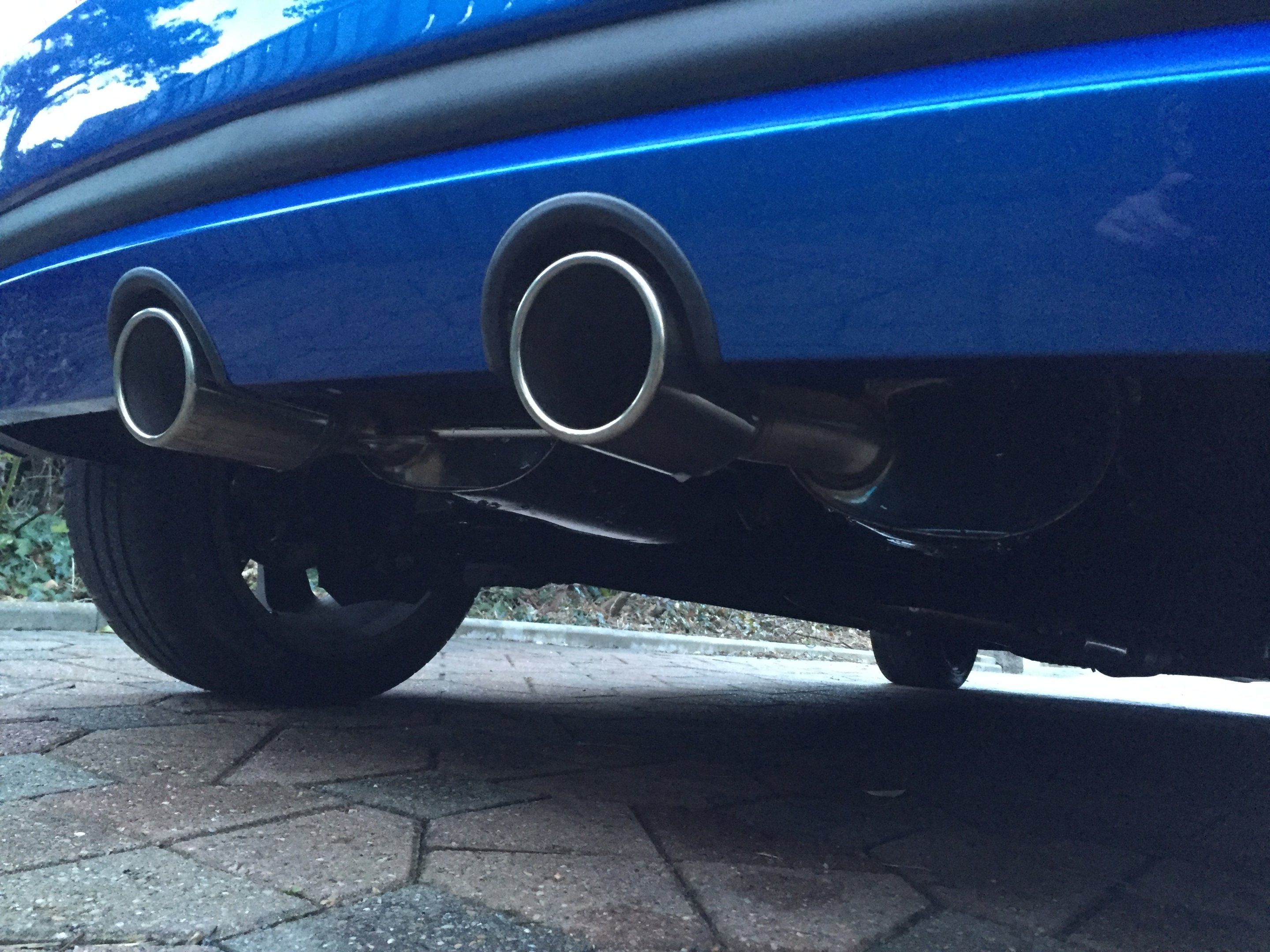

Having a failed attempt at lining up the exhaust myself, 6 months down the line the brand new standard mounts have gone already!
Does anyone know a local garage around West Yorkshire that will fit polybushed exhaust mounts and line it up for me?
Thoughts on decat too?

I spent hours trying to line my RS 192 up right. I'm not sure it's possible 😂. I fitted a new centre section so had the whole lot off. You need to set the lh pipe right first and clamp it tight then fit the rh silencer and set that right. Then stand back and swear because it's still not how you want it!
Try going to an exhaust place or a local garage who may be willing to let you get under and help so you can say when your happy with it. Good luck.

It is possible to get these on and lined up spot on. I fitted/ hung the back box first with new genuine mounts, lined up the tailpipes by adjusting on the mounts/ brackets, then slid/ rotated the centre box/ pipe straight (found this wanted to twist because location of mount on centre box) before clamping them together. Have had it on for 18 months now and hasnt budged.
