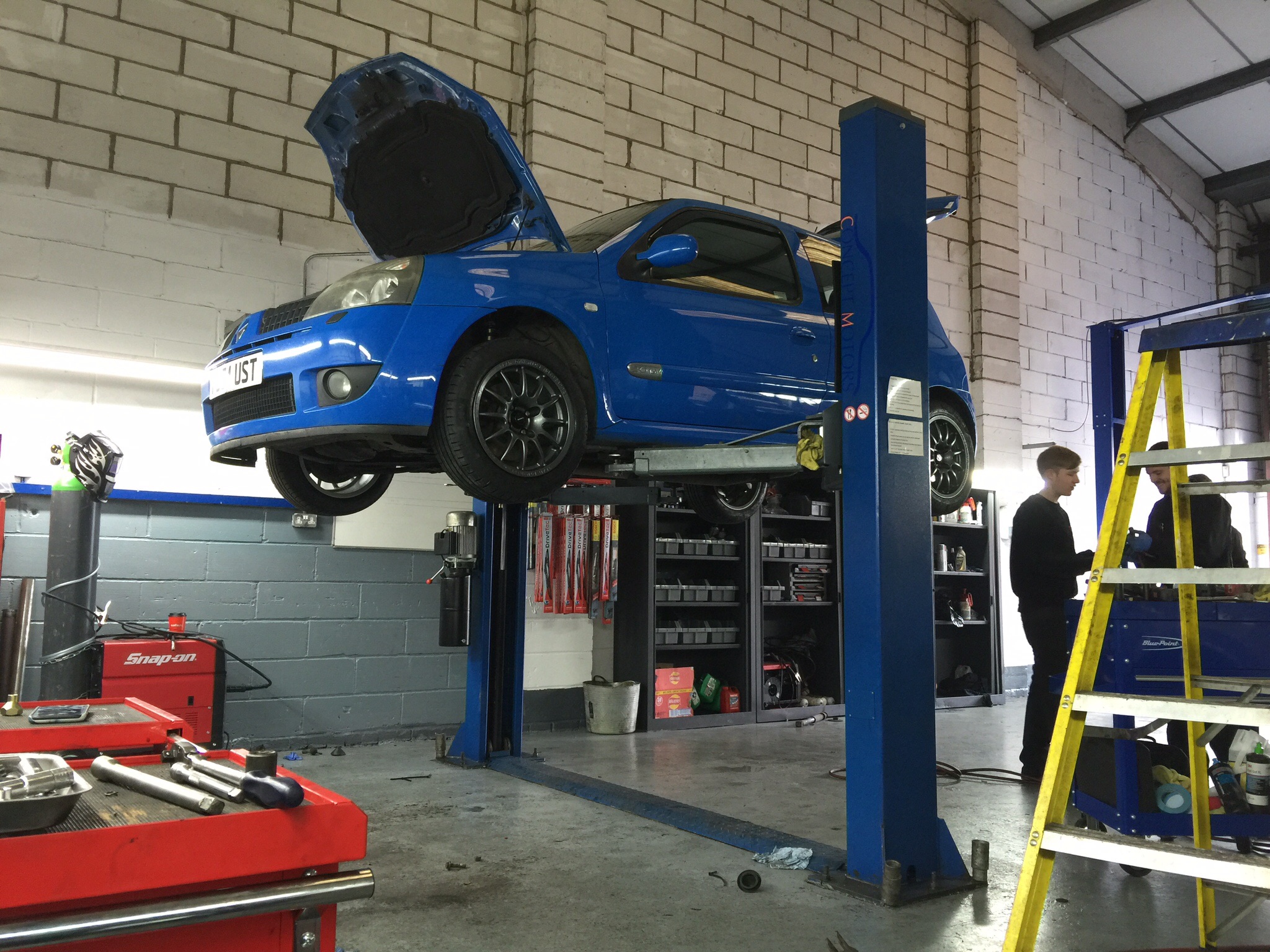

Ok so we have had this car for about a year and its run relatively standard up till recently. The car has 120k on the clock and only mods are cheap Coilovers and exhaust.

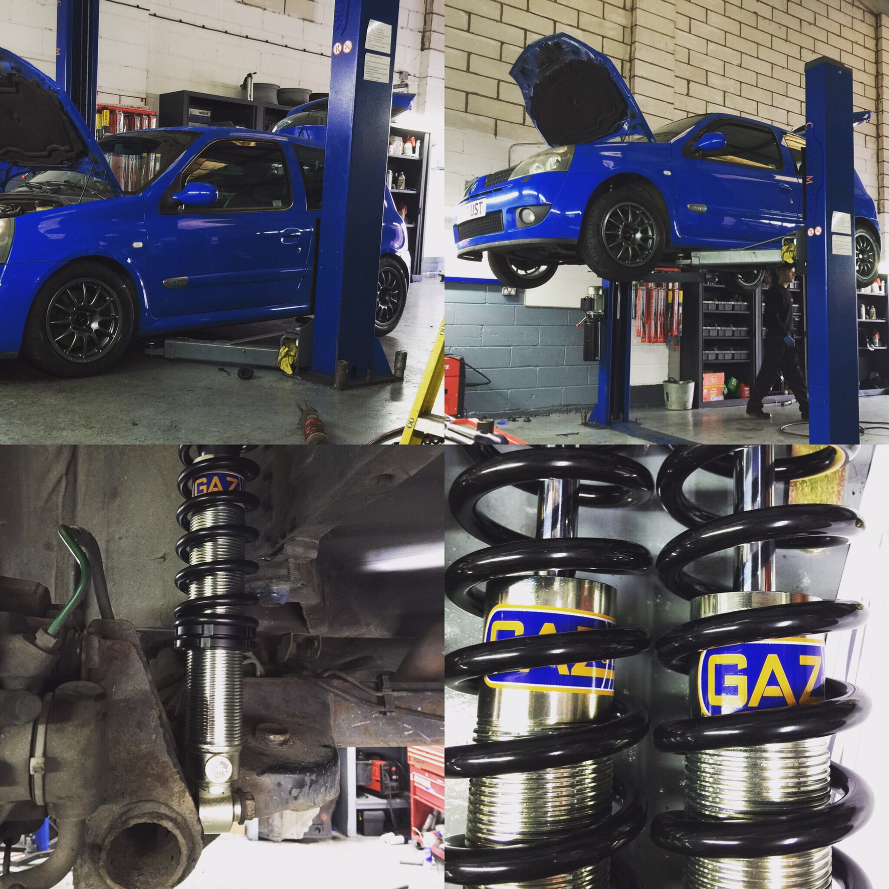

In the last week we have removed the cheap Coilovers as 3 out of 4 of them were bust and the car was running pretty poor on them. We have replaced these with some GAZ GHA Coilovers which are a lot better as they are adjustable dampening and they convert the rear strut and spring setup to full Coilover..

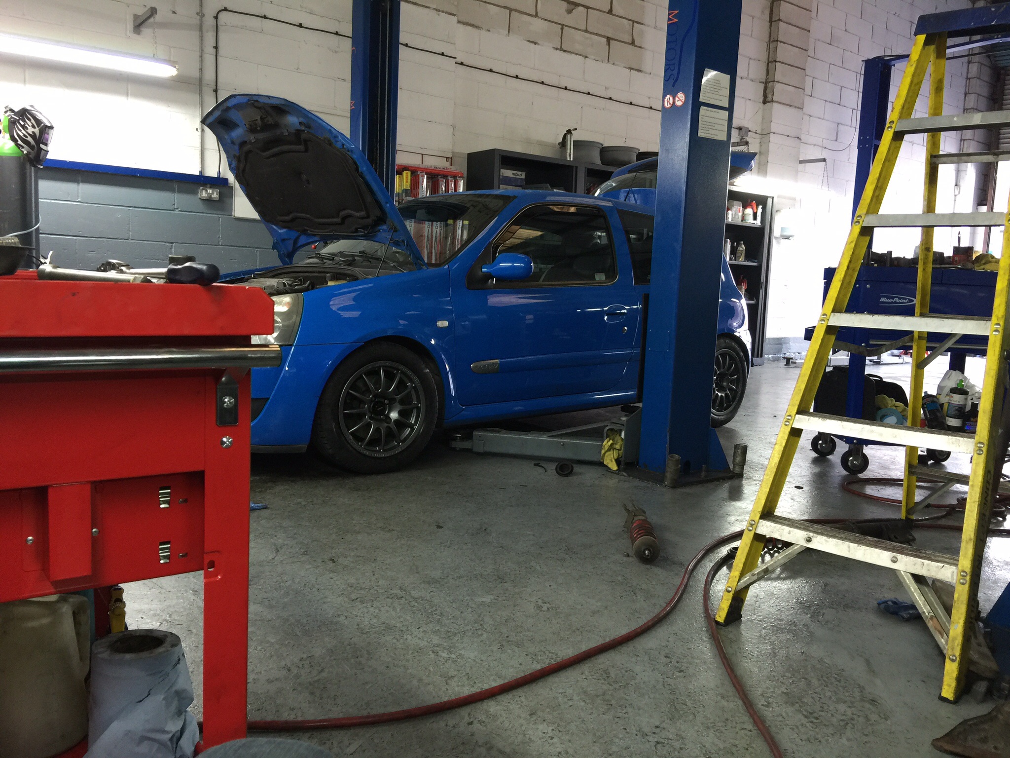

Also whilst we were at it we fitted some team dynamic pro race 1.2.. These were the wrong centre bore size so we had them machined out and had 5mm removed off the back to change the offset to let them fill the arches better..
