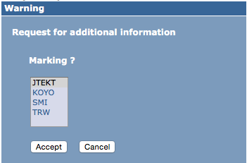

You need to know if its a SMI or TRE rack as there was a choice of 4 but the SMI & TRE where the two used in the Uk (I Think)

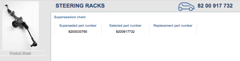

The part number in your first post comes up with nothing as in the picture below but it has changed as seen and the number its changed to comes up with nothing either.
