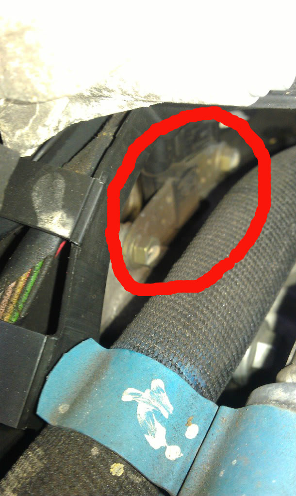

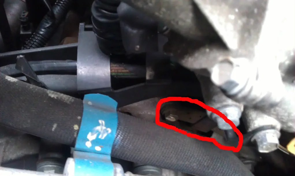

Should be top of the gear box close to the block, will have to remove airbox first for access. If I think on tomorrow I'll have a look at mine and get some pics.
Matt Cup
  Leon Cupra
Thats the crank position sensor.
