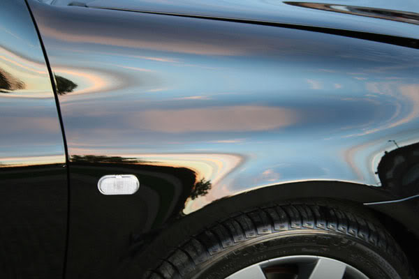

That what i've got today in the post m8, Megs clay, AG Super Resin & Extra Gloss, P21s wax. Gonna be doing it tomorrow, can't wait:eek:. How hard to you rub the clay bar on the surface m8? Yours looks superb!
  106 GTi
Cheers - Let the clay glide over the surface and it should do its job. No need to really scrub at it.
