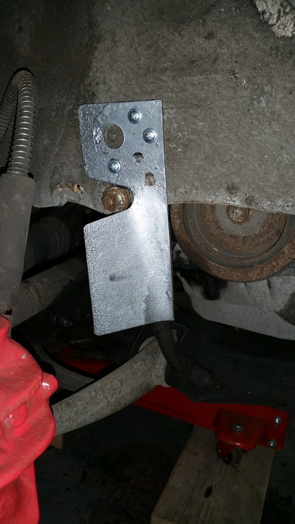

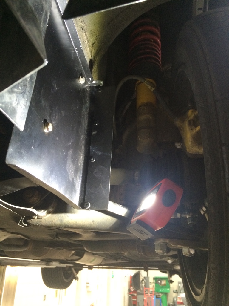

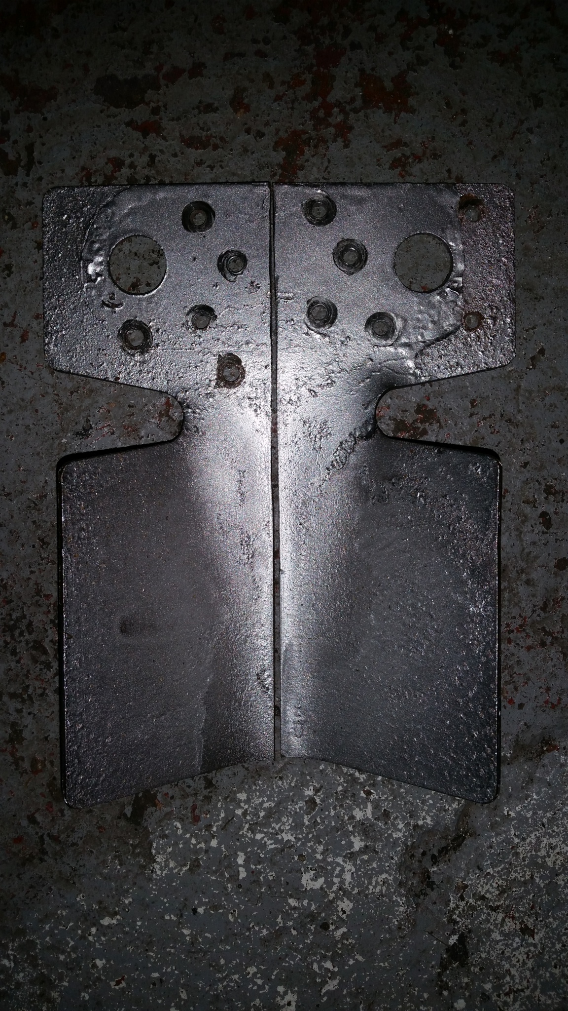

Hi All, Thought I'd post this up as I TOTALLY DESPISE 'Brand Name Rip Offs'

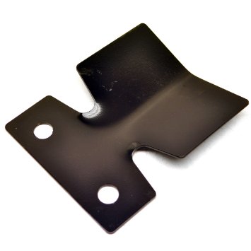

I used a 'Tow Bar Bumper Protector' as seen on eBay for a princly sum of £3.95 inc postage. (LINK BELOW)
http://www.ebay.co.uk/itm/TOWING-TR...171002?hash=item5afeb28cfa:g:XCEAAOSwBLlU42YW
Simply cut straight down the centre line and you're done. Already has the angles you need and a cut out which neatly fits around subframe support
Just attach with 'Jack Screws' which are the little self tapping screws with a drill starter. I used these already and have had absolutely no brake issues at all on track hammering it with standard pads.
Hope this helps and saves you some hard earned cash.

I'll get a pic up later this evening, no problem.
As regards paying more for correct part, they're virtually identical. Some people just like brand names and bigger bills I guess.
I'll always take an engineering perspective over a brand name perspective.
If it's useful to just one person, job done. Each to their own.

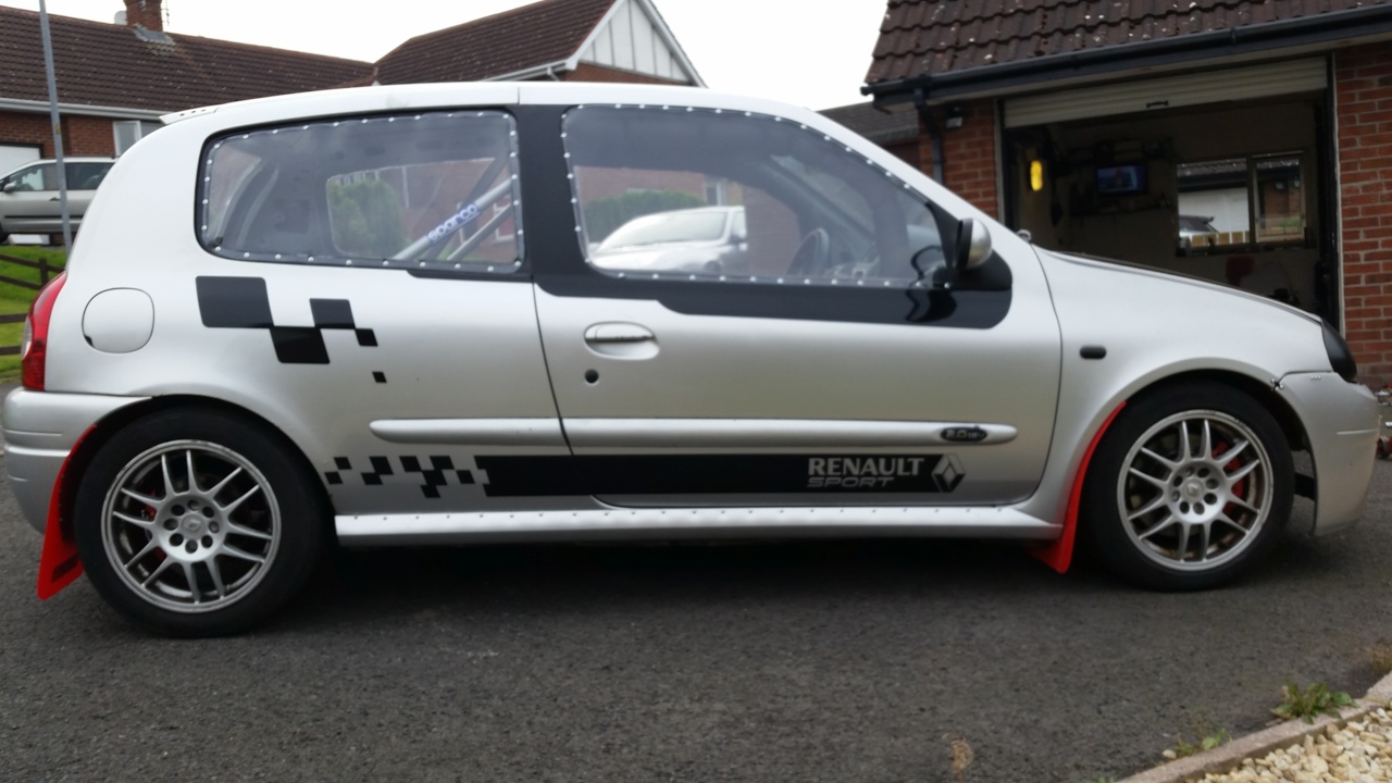

My own car...

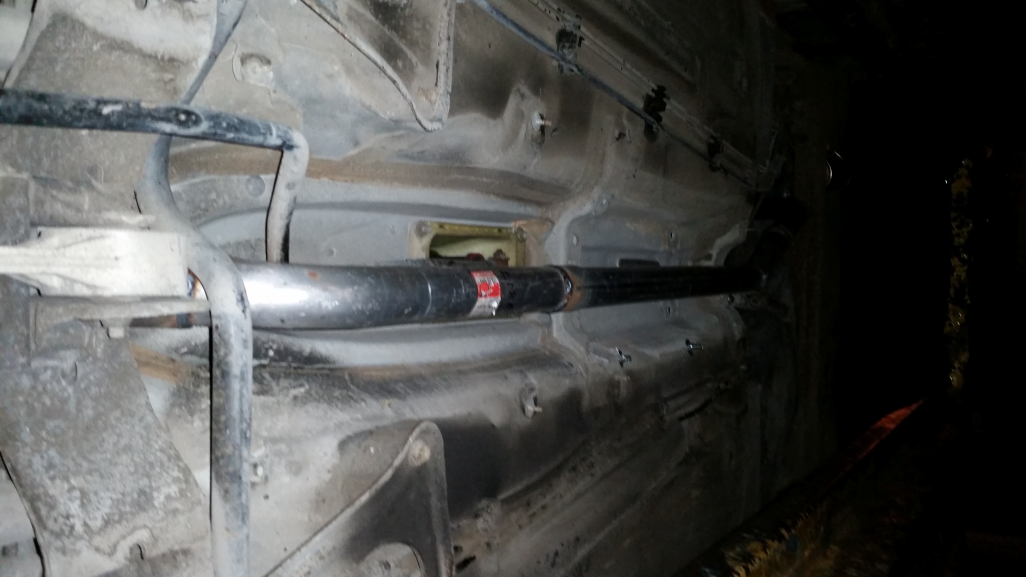

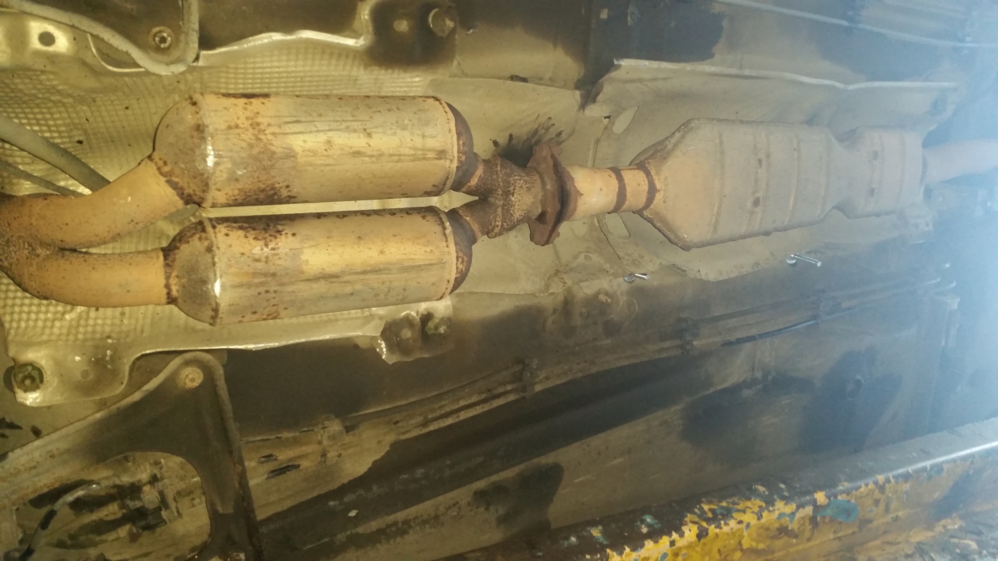

I've had the correct part (Brand Name) discussion before as regards exhaust. Priced up the usual suspects for a system costing hundreds
(If memory serves me correctly I think it had a 2" square brand tag on it somewhere it would never be seen)
Anyway, had my own 2.5" custom built locally for £100. See before & after below...

NON Brand Name 1mm polycarbonate windows, self cut and fitted with 'Jack Screws'... Cost £40 all in
Purchased from local plastics supplier - look for perspex merchants etc...

As regards engineering know how, this is the reason for post. So others can do likewise and save cash, simple procedure really. I'll get a few pics up when I get home. Cheers
  172, BMW 650i & X5

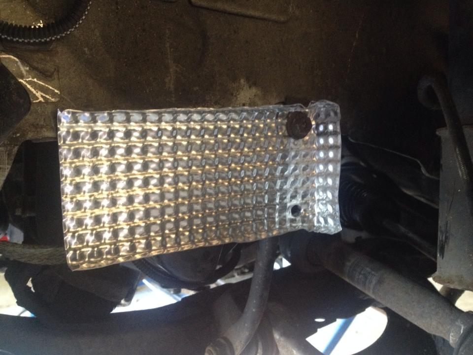

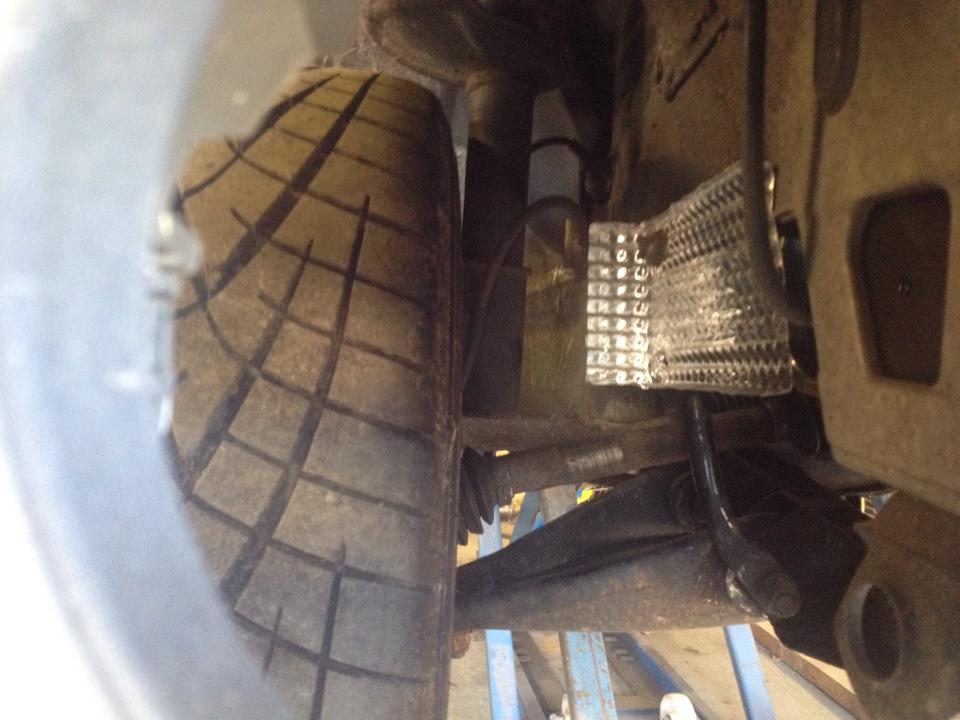

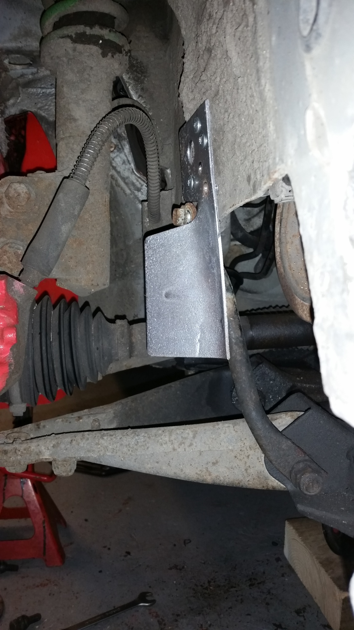

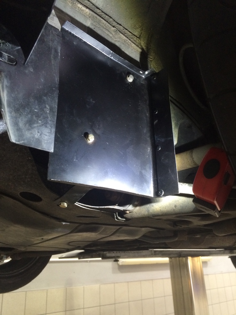

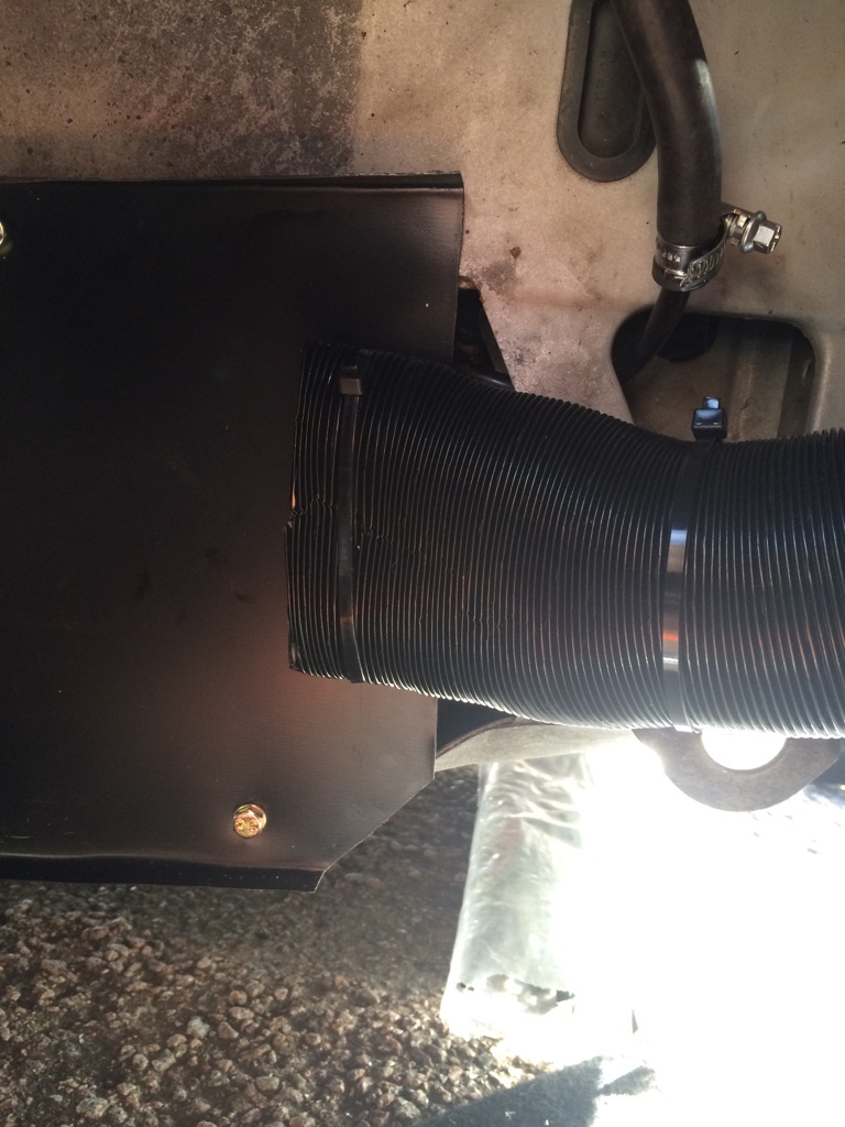

Below show pictures of the 2 halves together, and fitted to car. Cost £3.95
Also is a Brand name version at a cost of £190.80. These come with ducting pipe and inlets (you have them on your car already if you remove fog lens), I'm sure the ducting certainly costs the extra £186!!!
You decide...

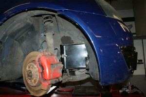

  Volvo S40

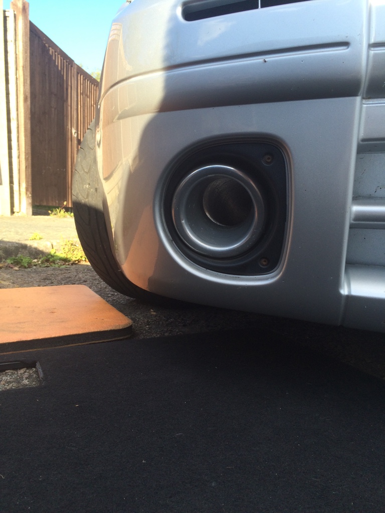

Thanks for posting this. I was considering the full ducts and ducting kit that's on eBay for ~£70 but instead I opted to buy some plastic bass ports and some ducting separately for the princely sum of £20 that will do the same job. These will go with it perfectly!
  172, BMW 650i & X5
In fact I don't actually understand why that would make me a chav? I think they look fantastic and very bare when missing.
I like them too but mines not a road car, doesn't even have any lights on the front. Gutted the headlights and left covers. Passenger cover is honeycomb drilled and air intake sits behind it. Could've bought expensive brandname ones but you know me by now...
Fair play. I admire when people think outside the box and give things a go.
I personally reckon you could have bought an offcut of steel and made larger versions and bent them yourself in a vice or something for similar or even less cost. From the pics the surface area appears slightly too small.
I agree it's always satisfying to find a solution, and very similar, even sometimes the same items with branding added for a fraction of the cost. I did the same with my oil cooler set up. I bought components separately and saved a fair bit. The hydraulic hose specialists I tried were actually overkill/dear so managed to get some made through eBay for just £30 a pair.
