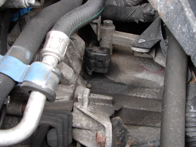

changing gearbox oil on ph1 172. please confirm pictures asap
  ph1 black 172

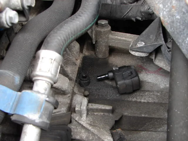

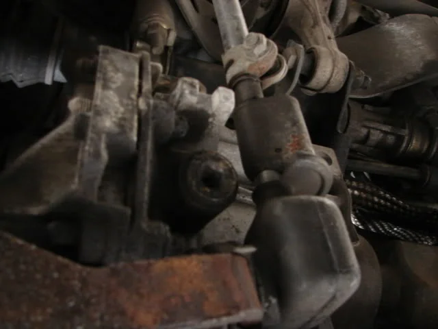

removal from the sump style plug in the pic here.
refilling in this hole. cant see a wingnut but found this.
  ph1 black 172
found it. thanks. draining now and oh boy it pours out!!!!!!!!!
