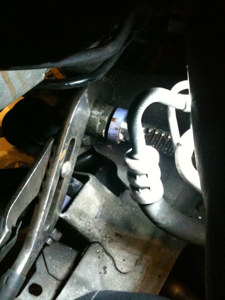

I've got the tool that slides over and you put you ratchet or bar on and crack it off but you can change them with a set of stilsons.
I purchased the kit cause I use it quite a lot, the most awkward bit I find on these is refitting the new boot over the rack, especially at the drivers side lol

Anyone know torque setting for inner track rods to steering rack please?
  330i. E30 Touring.
Nip them up. Then 1/4 turn.
No need to be super tight, but you don't want them coming loose.

Will do cheers. If you see a new thread saying sudden loss of steering in a week, we know to maybe do 1/2 a turn once nipped up in future lol.
