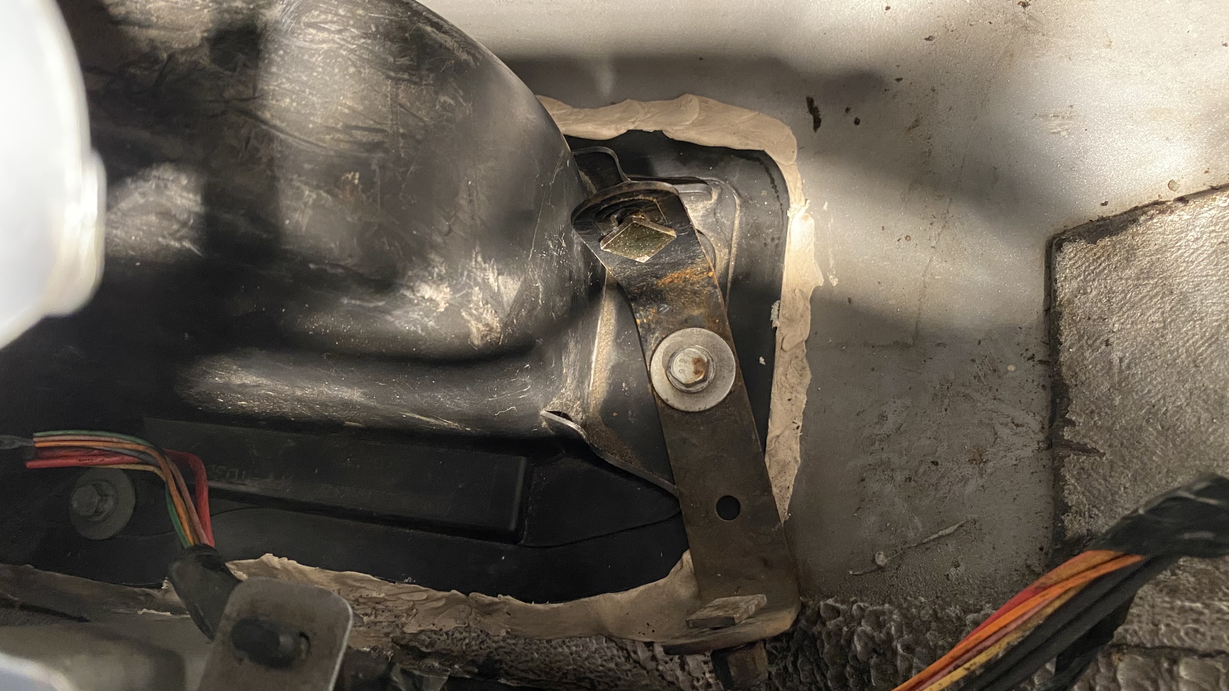

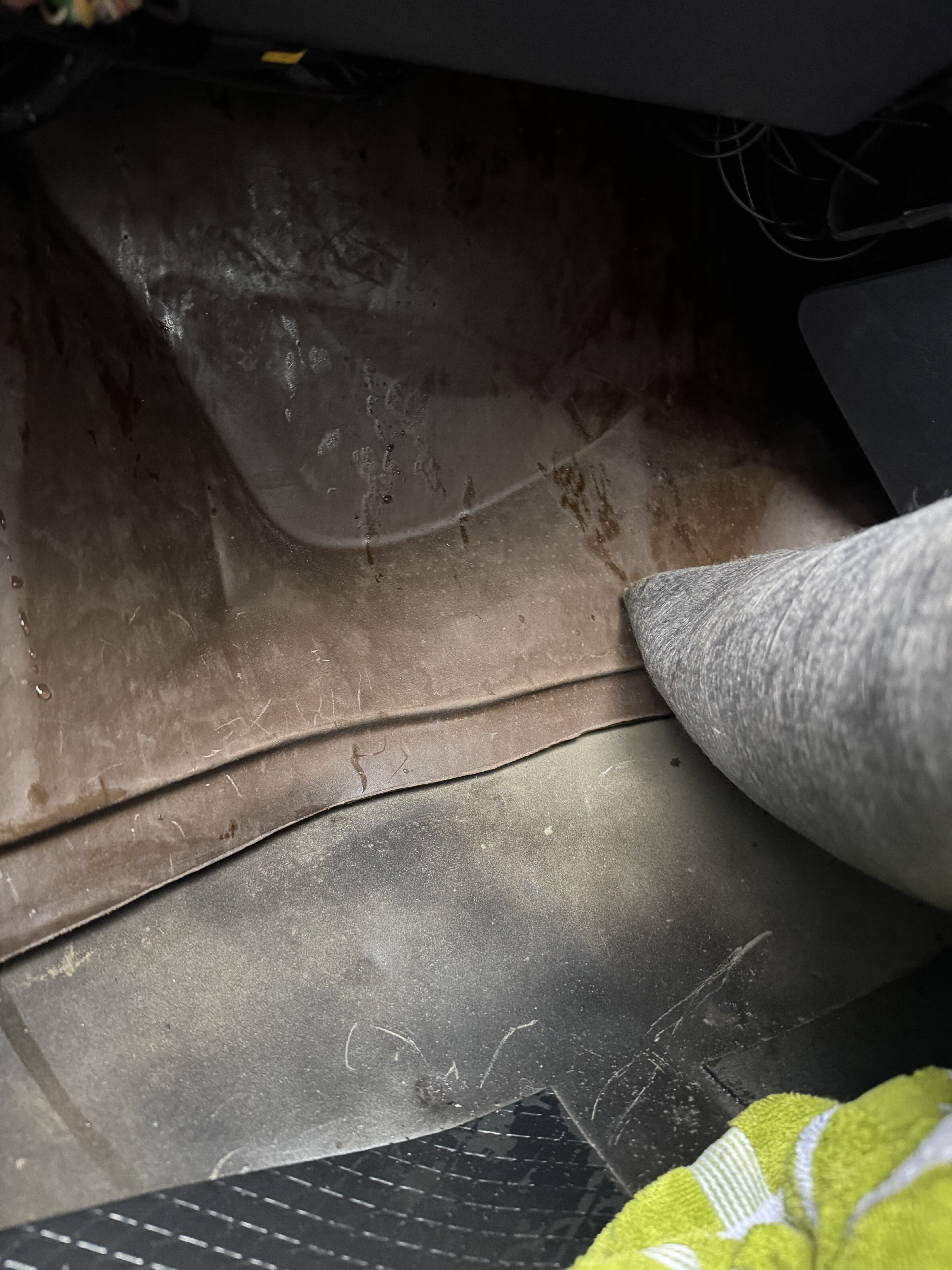

So, I’m addressing some of the water ingress in the front passenger footwell.
I’ve taken the sponge out (pissed wet through and sopping) - but noticed the backing on this brown sheeting section is very wet on the back of it. Press it and some drips run down.
Is it possible to remove & dry it? Or is it a dash out job to get to it?
All scuttle drains now cleared out and removed of excess water.

Thanks all. Got a dehumidifier here - I'll chuck that in over a days and nights.
Any ideas how it will have gotten wet in the first place? Heater matrix pipe leak possibly? Or could blocked scuttle drains do similar?
