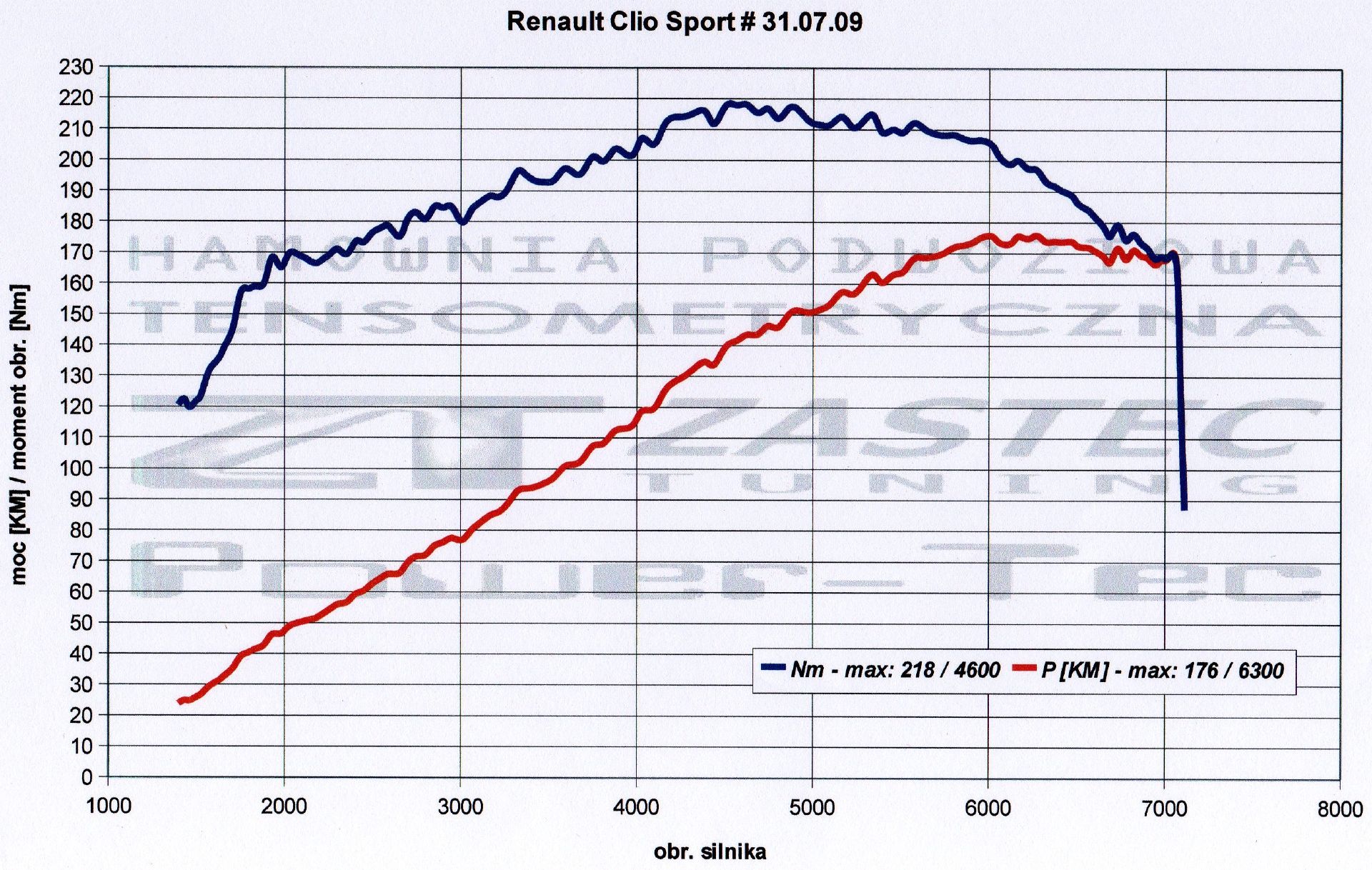

CatCams 421 / 182 exhaust manifold / few other mods
Can't complain for low down torque and power :) I eat Cupra 183BHP for breakfast :) But I was certainly counting for a better top end power output (looks like another calibration is needed)
  Clio Sport 172 ph1
I forgot to say it was made at 5 gear (maby thats why its nasty, slower more accurate) in 4th it spin up to fast and RR was interrupter at about 4k kick
