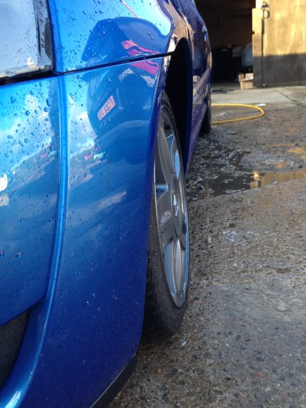

Currently we are struggling to get any extra camber using our current camber bolts.
After messing around for a couple of hours the best we could get is 1.7deg -'ive drivers and 1.2 deg -'ive

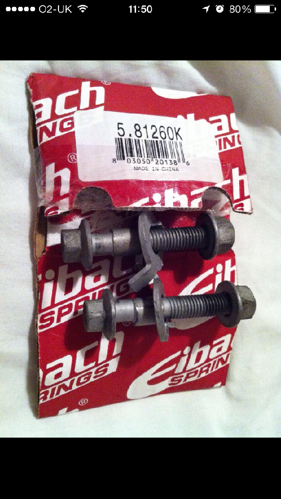

Are these the washers I need to remove??

The washers help stop the bolt from moving, partly cause they are dimpled to grip well and partly because the presence of the tab in the hold means the bolt cant move across.
I would keep them personally given that they are useful, just make sure they are orientated the correct way of course.

Tab on the washer should not be facing down for max camber.
It should be aligned horizontally.

Or just stop fannying about and bin the washers! The bolts won't move at all as proven by every single Clio I've ever setup (that's a lot) including James' race car, you won't be anywhere near the loads he puts on them!

Do NOT bin washer. The inner tab on washer is critical to how they work.without it you will not achieve the full amount of camber and the bolt will move around in the hole. To set them properly the little tab that faces inward must be in exactly the opposite direction to the cam lobe. I would only use a camber bolt that has these washers on both sides of bold not just one. If you let the washer spin wherever it wants your wasting your time. Put some tip ex on the head of the bolt at the peak point of the lobe and set the little tab opposite the tip ex mark.

How do the bolts "move around" exactly? They're torqued up to 140nm from memory! We race on them and they don't move at all?
Simple. Only the lobe is the size of the standard bolt the rest of the bolt is smaller and the reason he washer has the inner tab takes up that free movement and compensates for the size difference. Even if you torque it up enough to not move under he forces of cornering then how are you in control of setting camber accurately with a ill fittin bolt. You obviously have no clue how they work so just binned them. It's not rocket science to be honest and I'm shocked at how bad that advice was
  Lionel Richie
the size difference is the whole point of why you get more camber, the strut hole rests on the bolt as you adjust it (unless you're setting the camber with the wheels in the air?) as you rotate it with the wheels on the ground the cam lobe pushes on the hub forcing it outward to give less negative camber
no need to insult me fella, its just the internet! We've setup race winning cars WITHOUT the washers, if you read the box they come in it states "Volvo/Subaru" they might be required on them, but IN MY OPINION you can bin them when used on clio's, also WIHTOUT the washers i believe you get more camber from my experience
