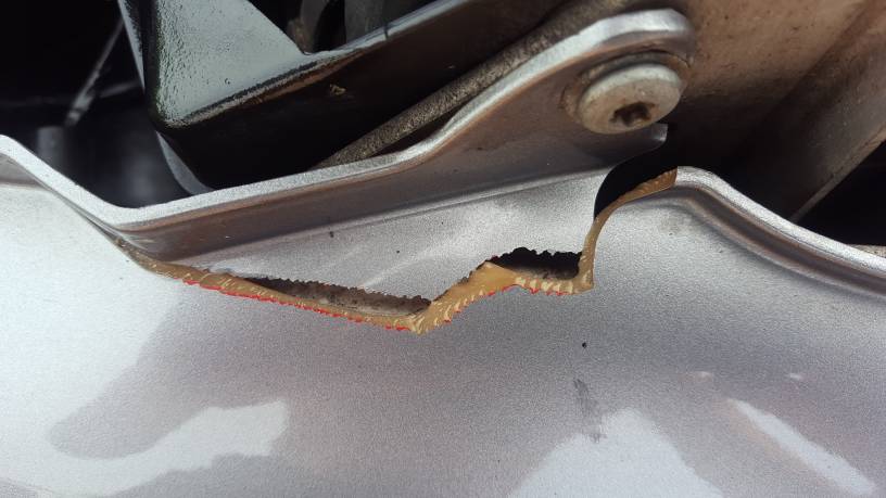

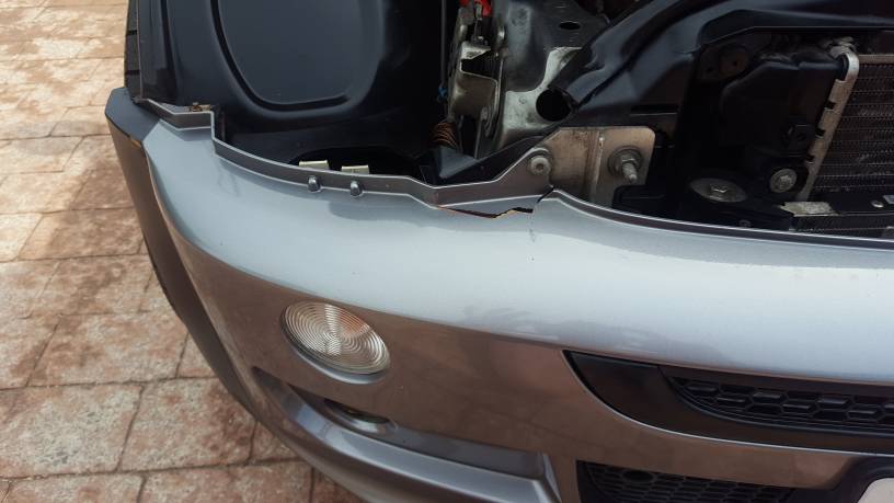

Thoughts on this please? Can it be repaired or is it new bumper time?
Rojer
Yes that can be repaired, it could be plastic welded or you can use some epoxy glue and a bit of filler etc.

  535d / t5 caravelle
Going to get it plastic welded all being well, not cheap these bumpers!

Brigsy
  T.Turbo
Bodyshop will be able to repair that no problem. Theres a mega strong trade adhesive/epoxy for stuff like this possibly made by 3m from memory.
Gally
Everything can be repaired... To what standard is a different discussion. Those bumpers are pretty cheap though, buy second hand straight one.
I’ll try and get it repaired, if it’s a decent standard, happy days! If not, new bumper time, there around £300 quid second hand,then I have to find one in the right colour preferably, then it has to be local enough to pick up, there’s only one on ebay at the minute, and that’s in white and 95 miles away, £285 plus £25 postage, plus respray, that’s got to be near £500, it’s a jcw/aero bumper not a bog standard s one.

1985michael182
I work for bmw as a Senior ATA Panel Technician. Yes it can be plastic welded, hot stapled, epoxy glued, reinforced with matting behind it .... but... with it being a mounting point with the 30 torx bolt in it the chances are it's going to break off again. Depends on how good of a job you want really. R56 jcw? You got a reg I'll see how much brand new
Much appreciated! Car reg is ym05 wbo r53 cooper s, the bumpers a jcw/aero bumper though, suppose I’d just be happy with it being reinforced at the minute till I source a new/used one, the cracks out of sight when the bonnets shut, just sags a little on that side.
