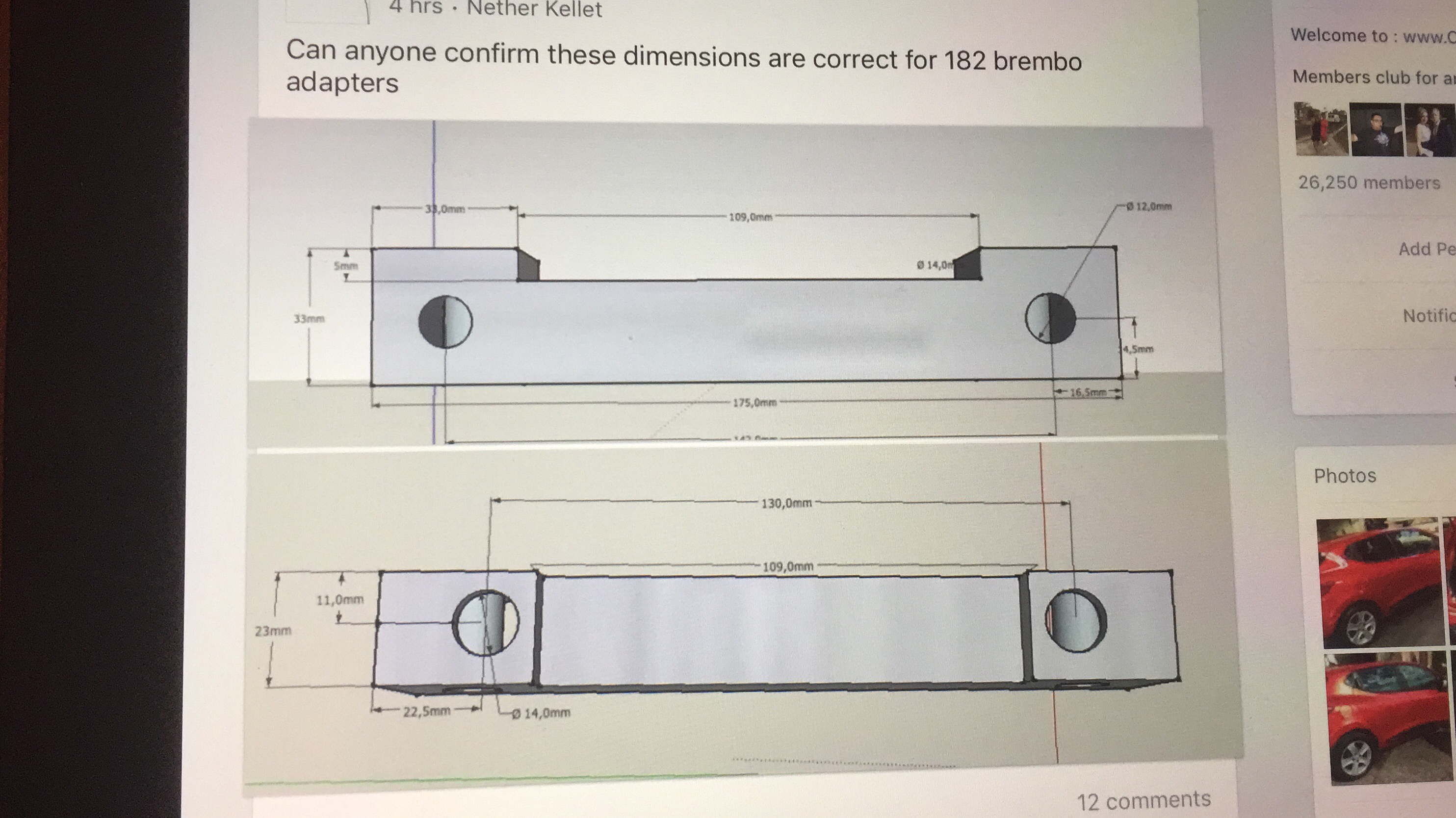

  Clio 182
Other than the picture I don't know much more on this.
If it is indeed correct then it'll serve to save members a few quid on brackets.
