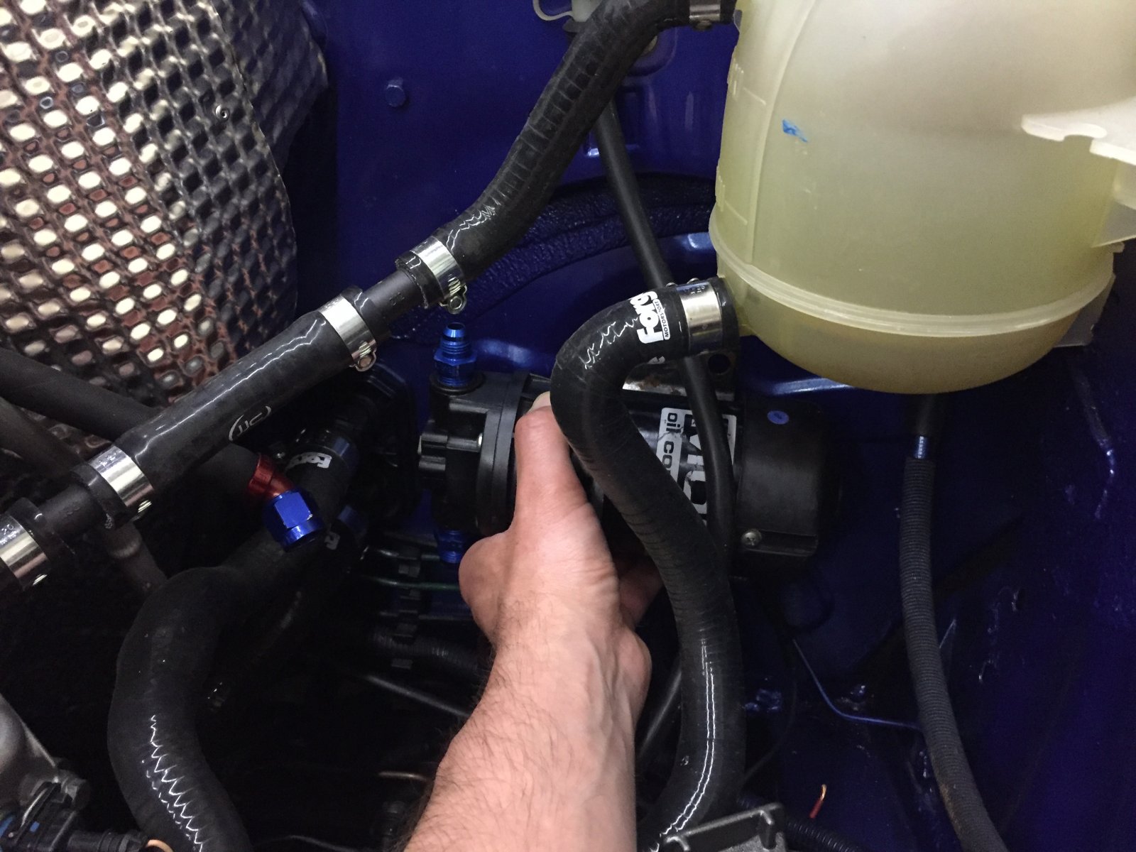

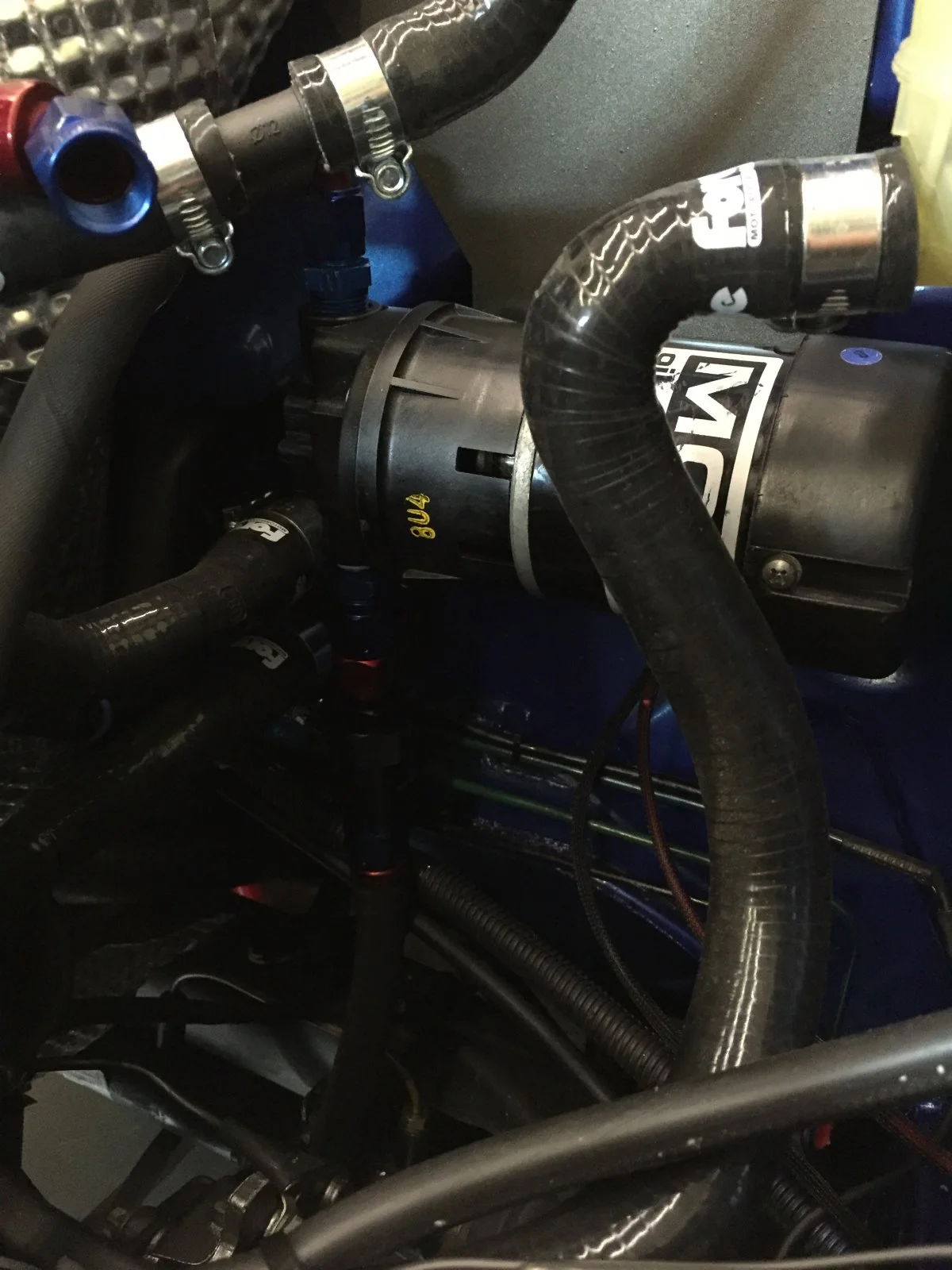

New laminova arrived today.

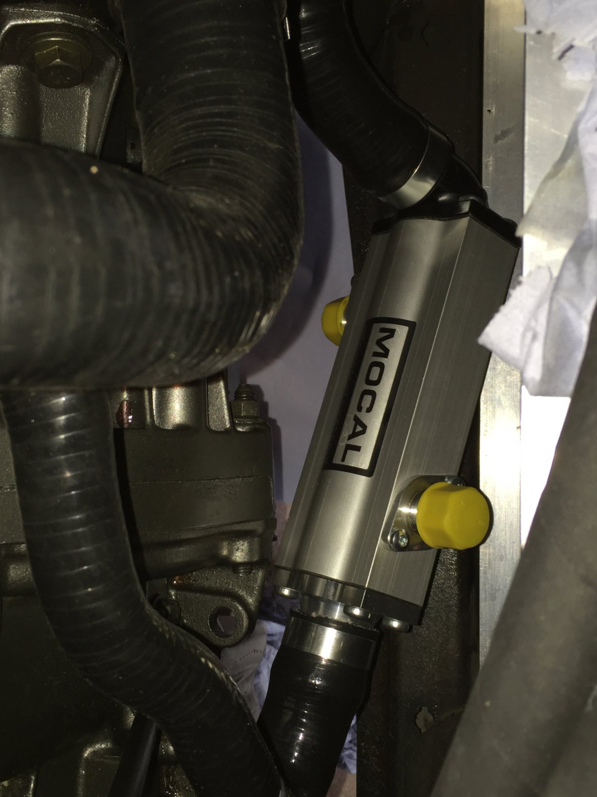

This one has a 180mm long core. The old one was only 90mm, so it should bring the oil temps down significantly. I also opted for a forged 90 degree elbow and offset oil ports.

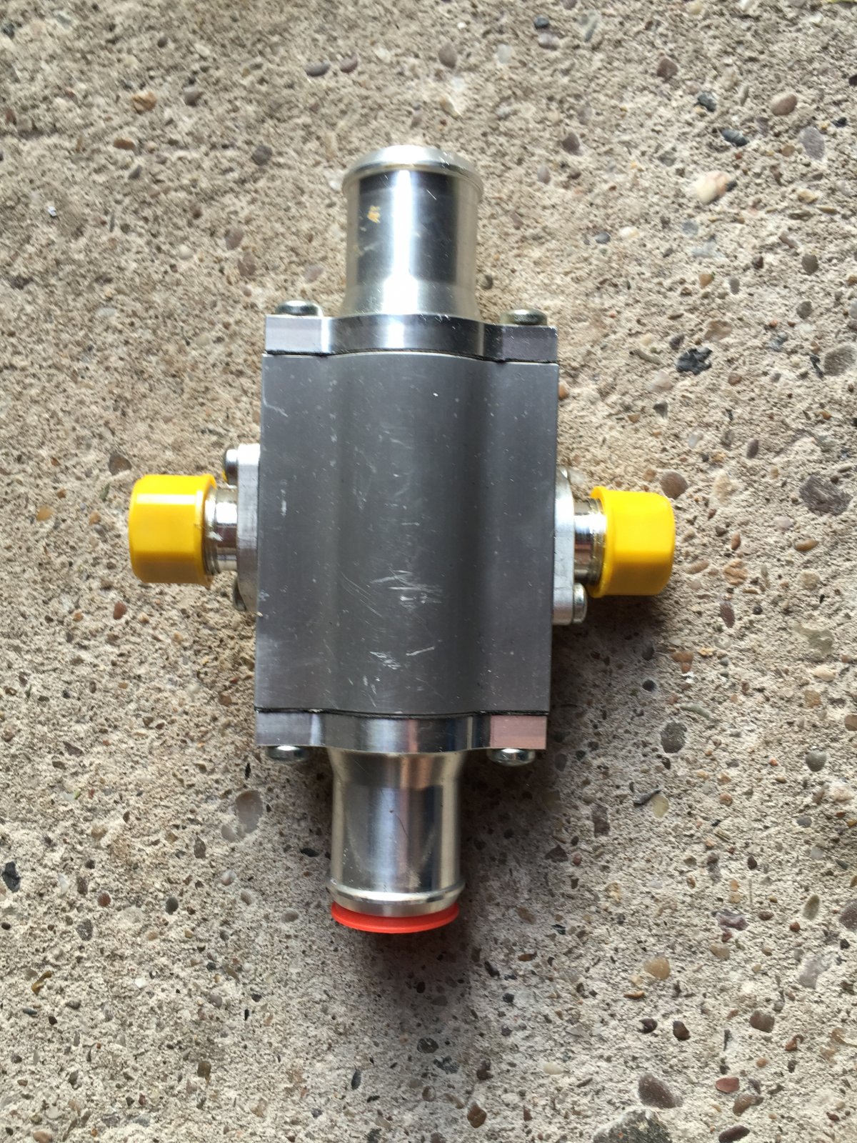

I'll order some 16mm hose ends for the old laminova so I can fit it in one of the other coolant lines in preparation for the gearbox cooler as well. No point dropping the coolant twice!!
The new laminova is all fitted now, but I might consider getting a custom aluminium bottom hose made up. Just the oil pipes to re-jig and fit.
More to come.

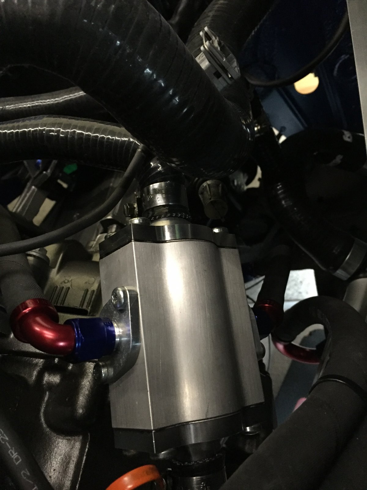

NorthloopCup

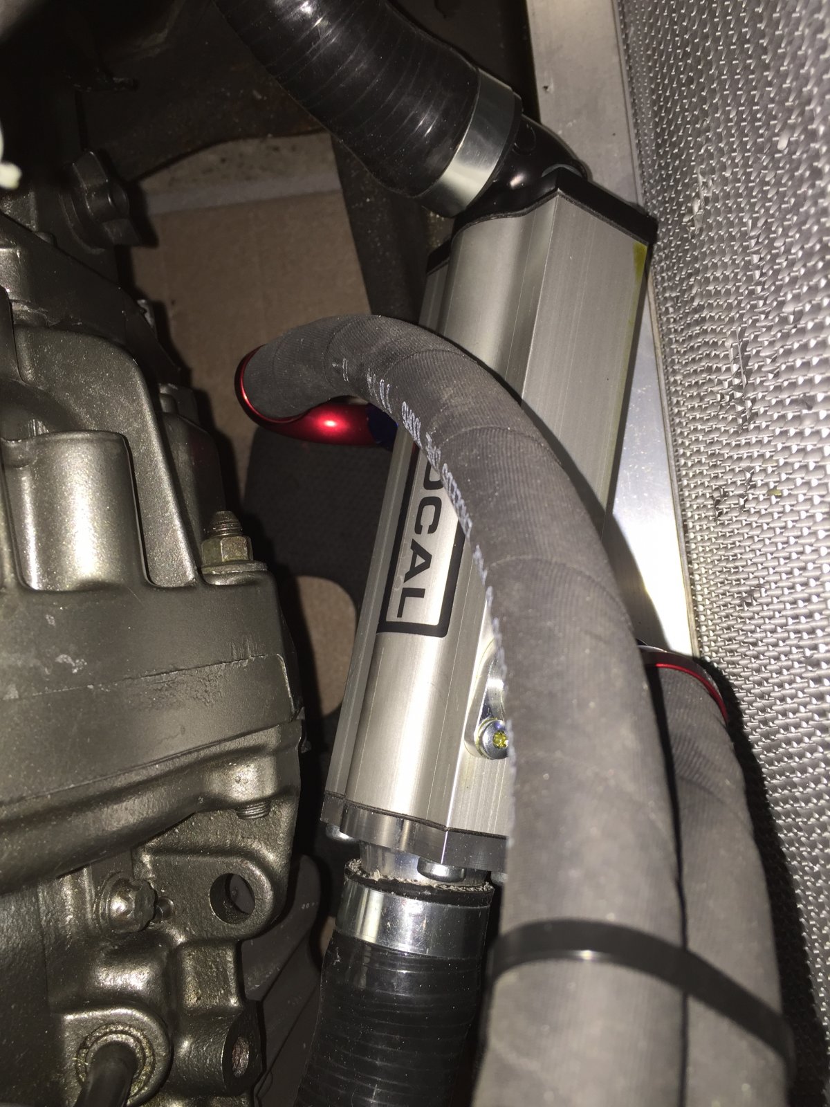

Time for another little update! The new laminova is all fitted and piped up, along with the 197 thermostat.

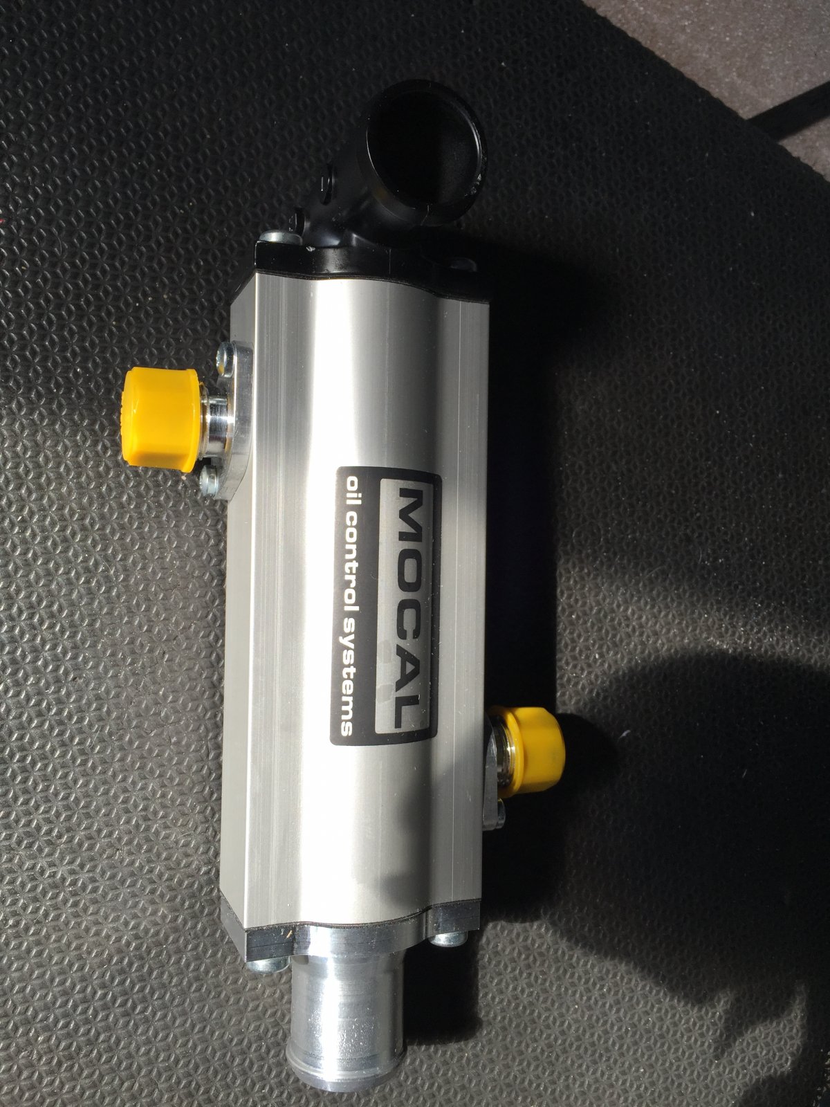

I've been accumulating a few other bits and pieces for a spot of gearbox insurance as well. I'm pretty sure that this will be a jc5 first on Cs as well?!?!

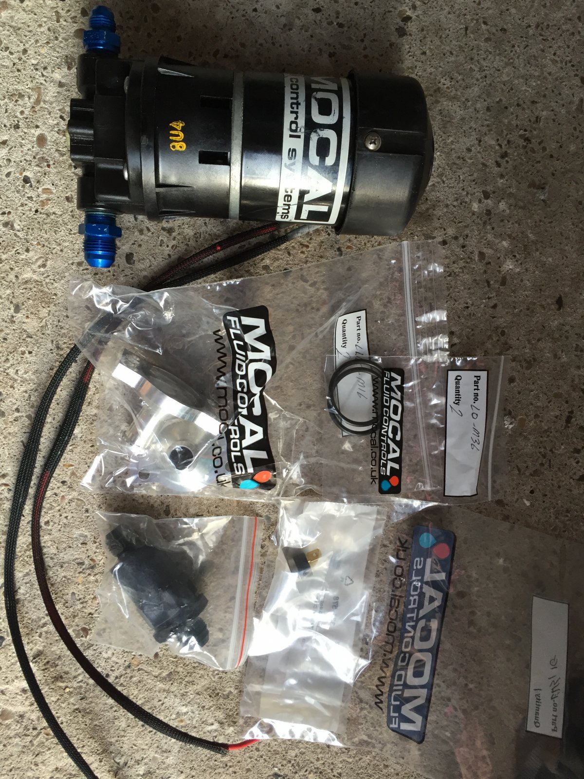

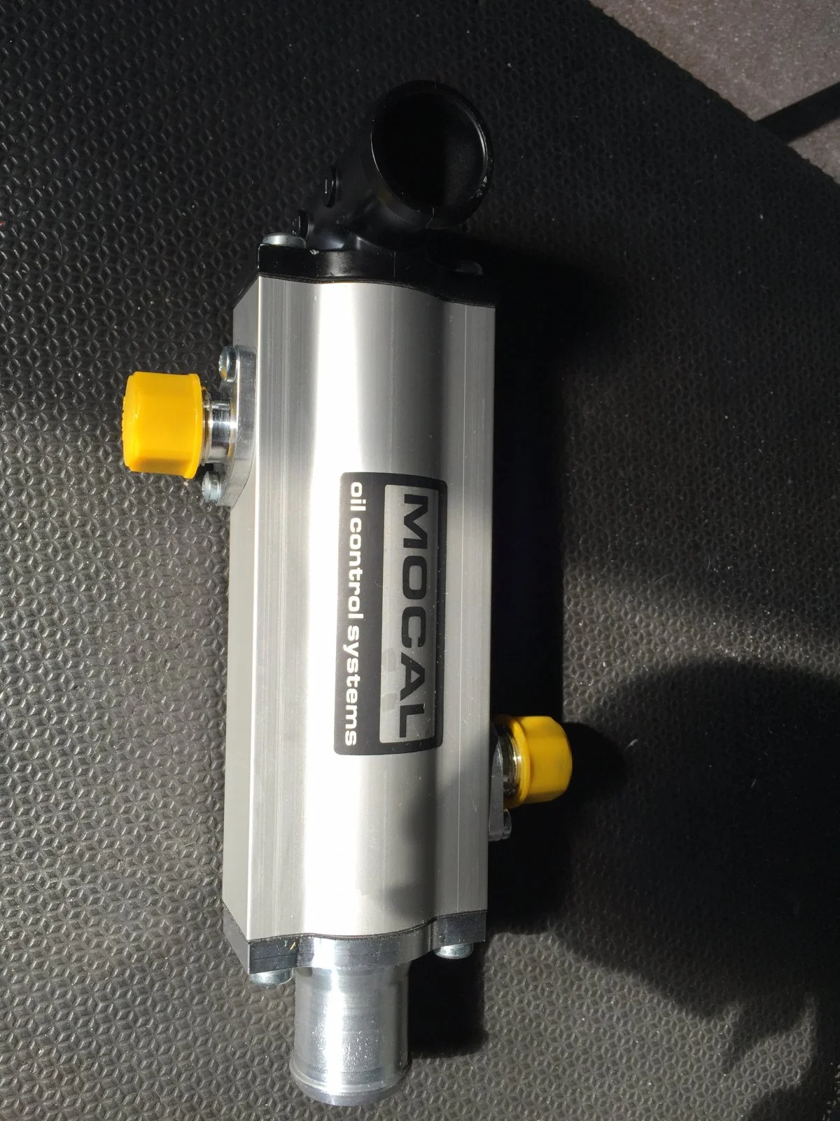

What you can see here is my mocal oil pump along with some new ends for my original laminova, a 100 micron filter and a surface mount temperature switch.
The new smaller ends will be going on to this and I'll be doing a cut and shut on one of the other coolant lines so I can use this as my gearbox oil cooler.

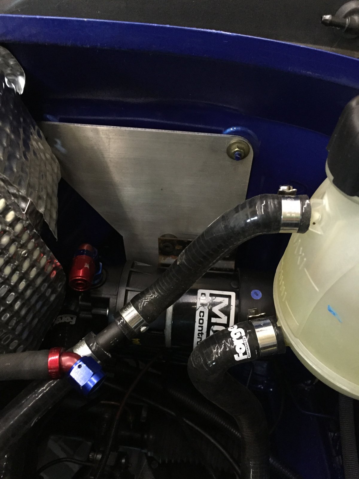

Finding a spot for the pump to live has been a bit of a challenge, but I've now decided on where it's going to be living.
I'll make a bracket to mount it off the bulkhead so I don't have to support it with my hand and arm. Lol!

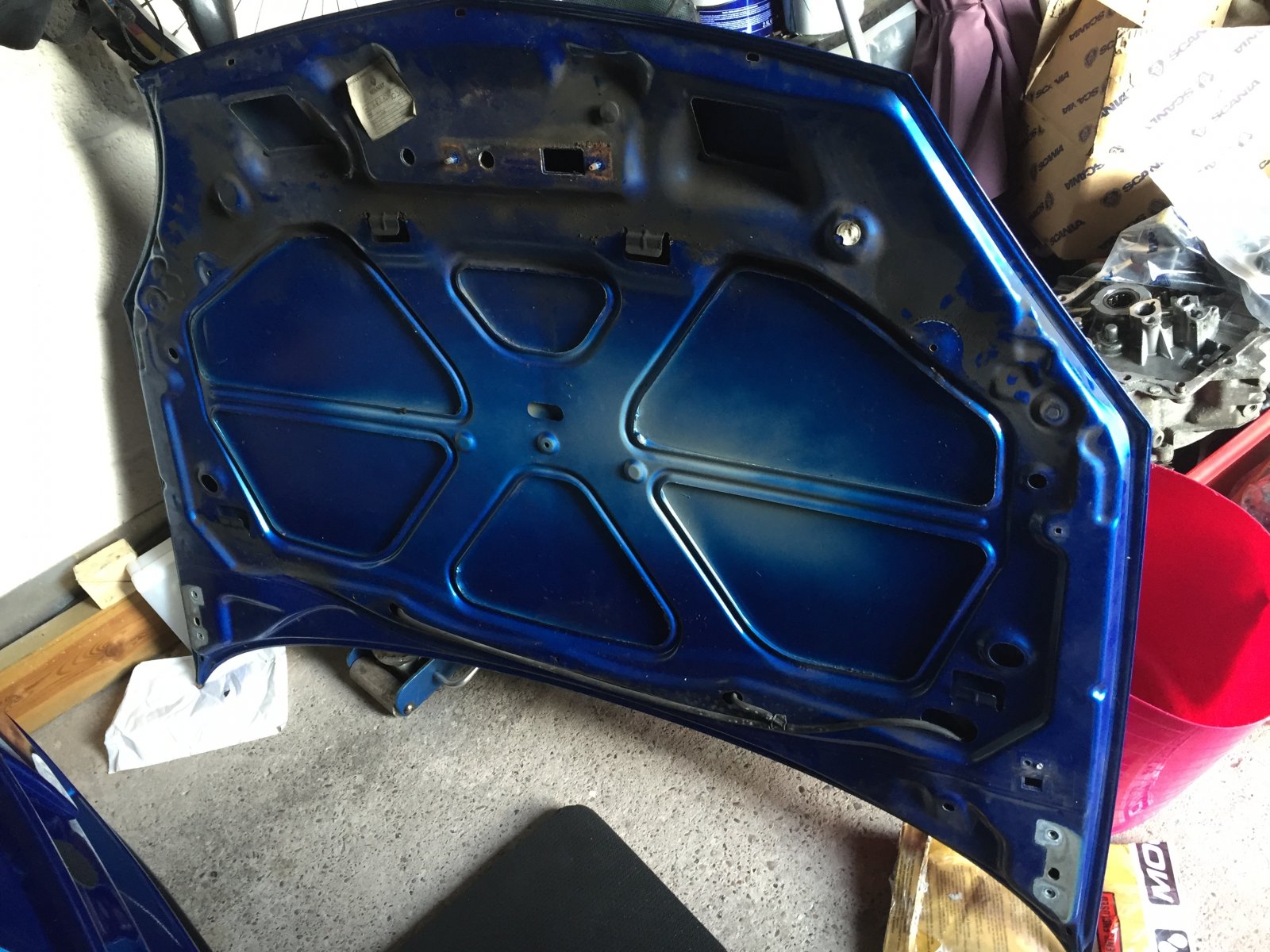

And finally, I've got another bonnet to de-skin. Mine has a crease in it from when I attacked it with my nibbler the first time around and it's always pissed me off, so I'll be be doing something a bit different with this one.

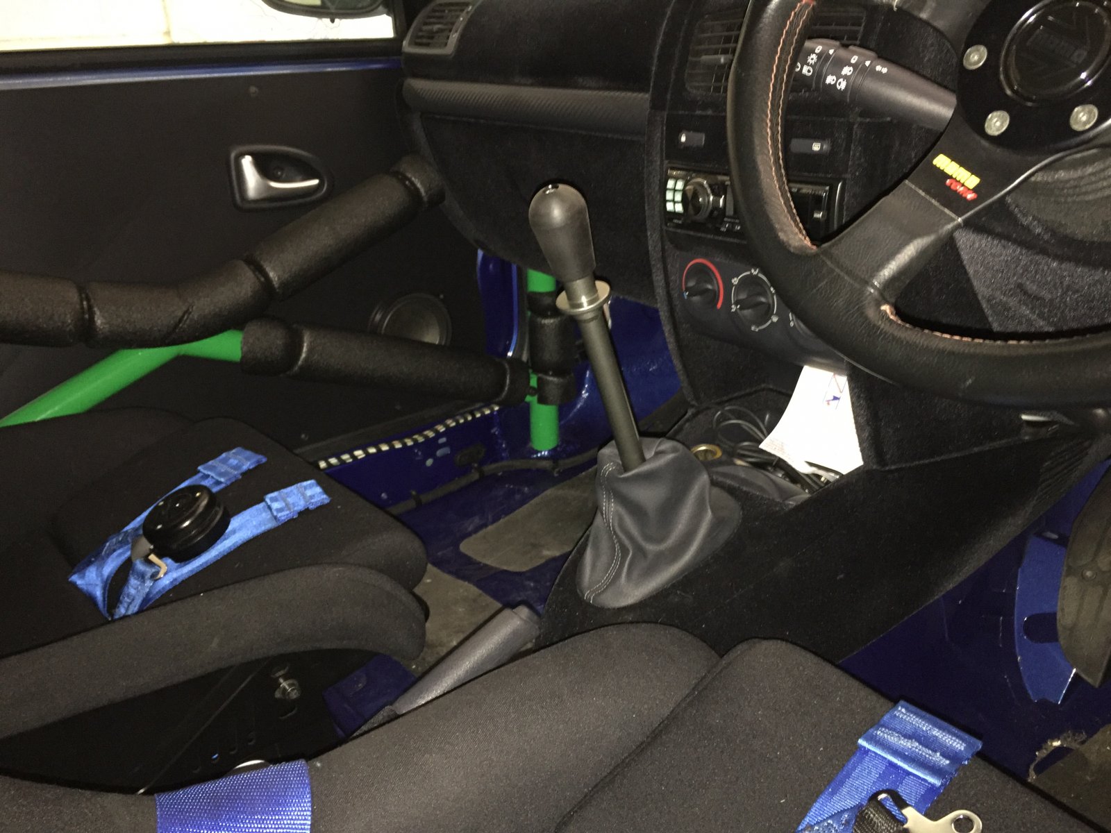

Hi @NorthloopCup.. What sort of paint did you use ? I've read somewhere that it may help with the rattle...not that it matters when giving it the beans!
NorthloopCup

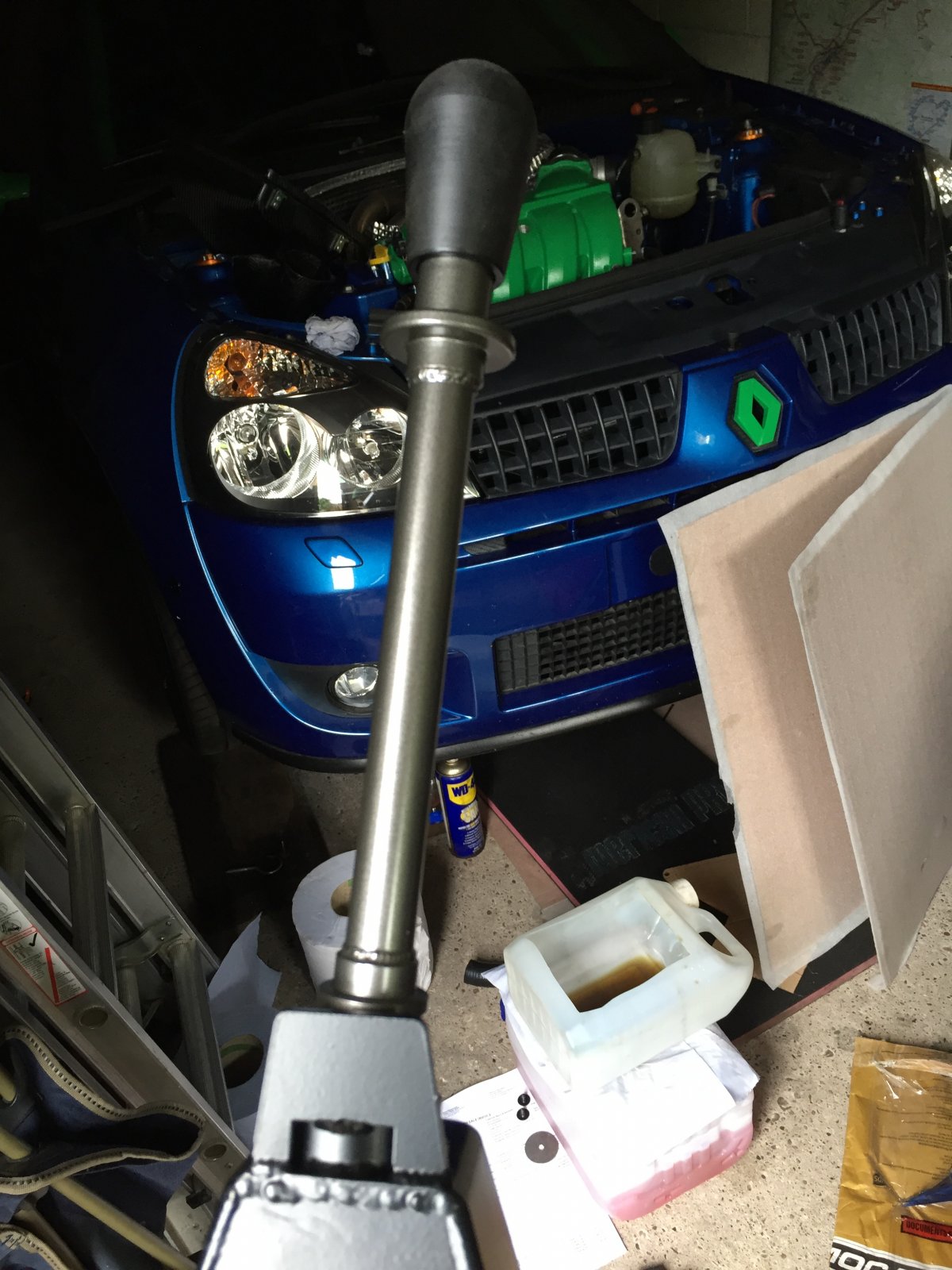

It's just vht engine enamel mate. After speaking with Nick at pms, the rattle is mainly caused by the shifter linkage at the box end. Use plenty of grease, and the rattle is reduced. Now I'm not driving it to Germany, I'm not worried about the rattle! Trailer ftw!!

That looks great Mark!
A PMS shifter is next on the cards for mine, and I've never been a fan of the zinc finish.
A colour like that would match my cage perfectly. Good shout!

Cheers mate! Yeah all the hubs I do are plated the same colour and I've never been a fan personally.
I've heard good things about the shifter, so it'll get its time to shine at the 'Ring, or it'll be moved on.

NorthloopCup
Fittings arrived today for the gearbox oil cooler lines. Soon got those made and fitted, so now it's all systems go.
Tomorrows job is to prime the system and top the gear oil up.
Jobs left to do before the 'Ring is:
Raise the ride height 2 turns on the coilovers.
Roll the rear arches and adjust the front bumper for clearance.
Carry out some geometry adjustments/corrections.
Fit the pms shifter.
