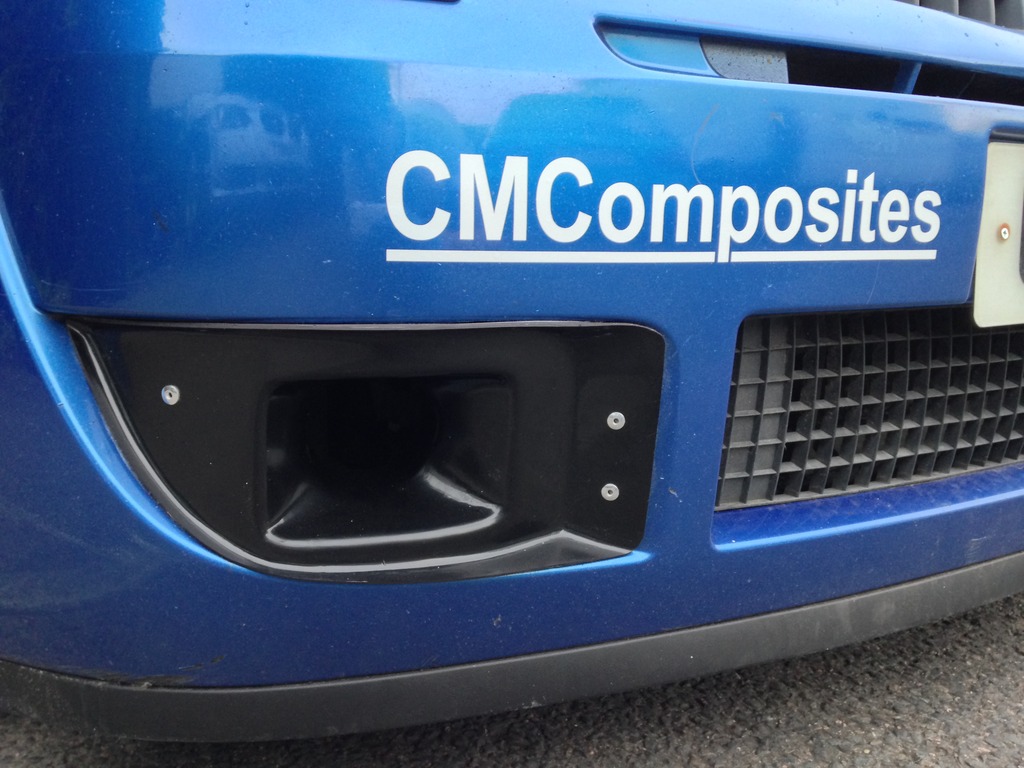

I'm sure CMComposites do just the bumper mouldings but their website doesn't have anything on there
Anyone got any ideas where I can find some or pictures of the CMComposite ones and a rough idea of cost?

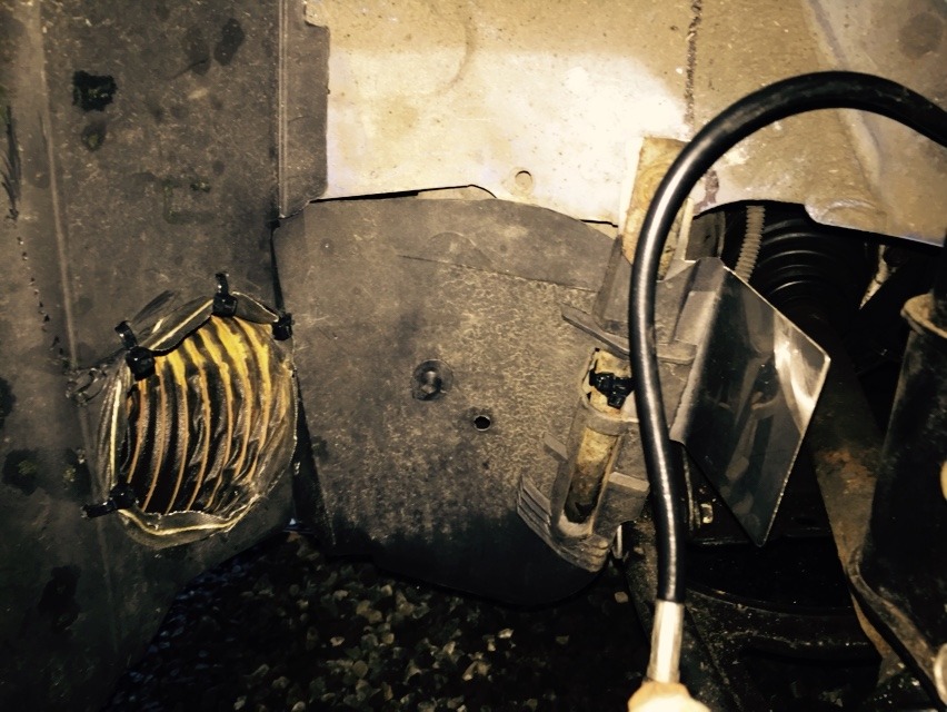

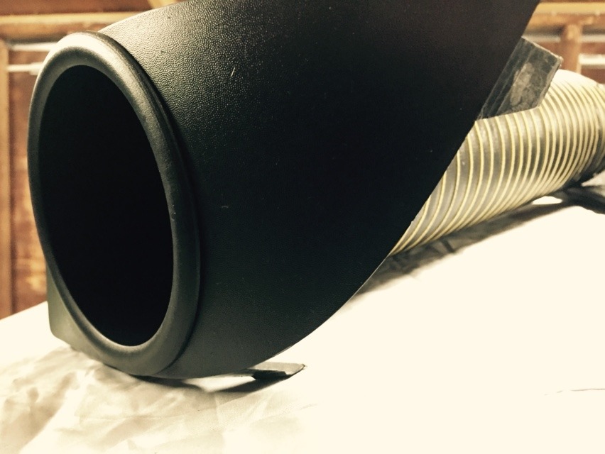

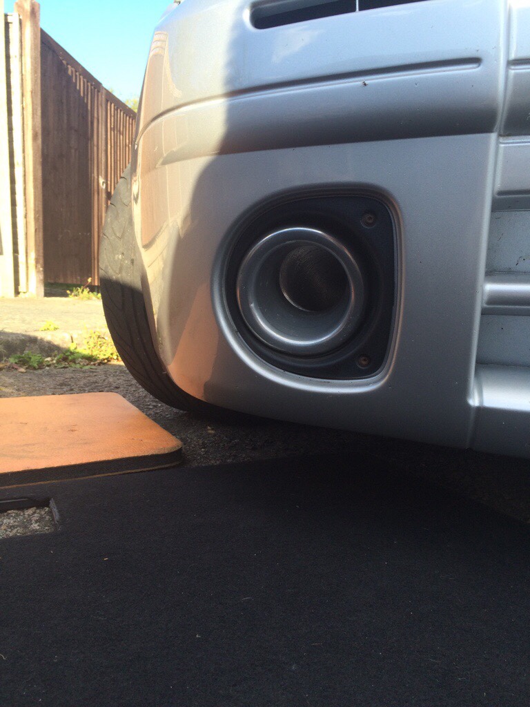

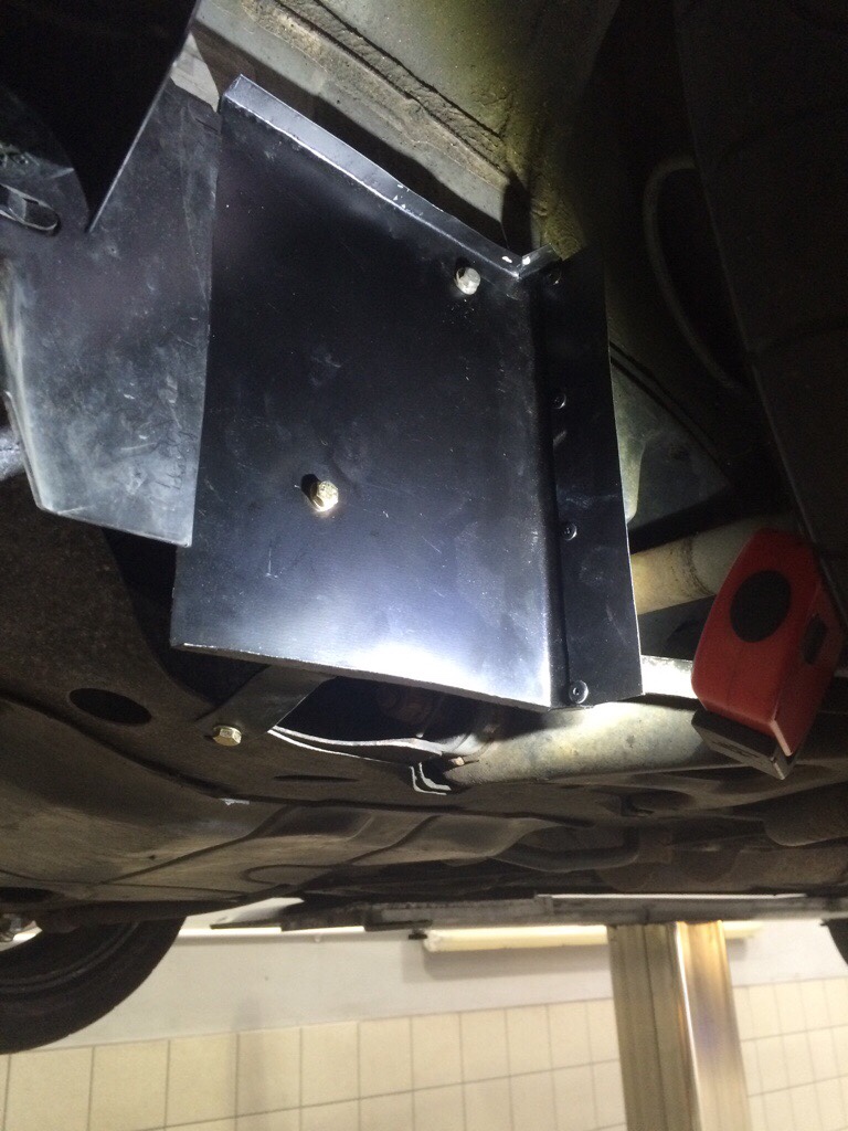

my set up cost ~£20 and works extremely well.
2x 100mm bass ports off eBay (~£4 each) are a tight tidy push fit and meter of spiral duct for a tenner. Bent two bits of waste stainless for deflector plates.
not pimp but very cheap and functional!

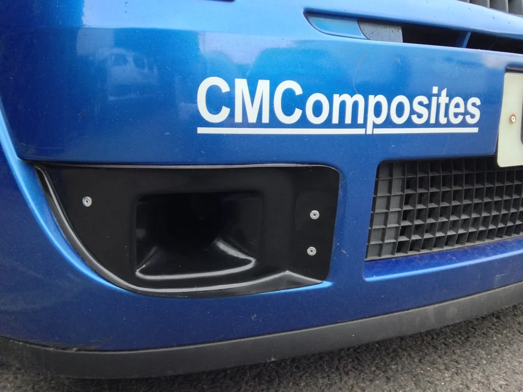

The CM Composites ones will fit very well mate. He remade them after making them actually fit a 1*2 fog light opening, unlike the original cup racer ones.
They were done with the ethos based on "looks mint from the grandstand". Lol
that looks really nice tbf where did you say you got the bass ports from as i couldn't see them on ebay ??

Can you just use a longer length of tube and point towards the brakes instead of the deflector plate? I can make a plate if need be just wondering if it's more direct with the tube pointing directly at the brake instead of the plate deflecting it randomly.
  Track 172 Cup
@StuOwen86

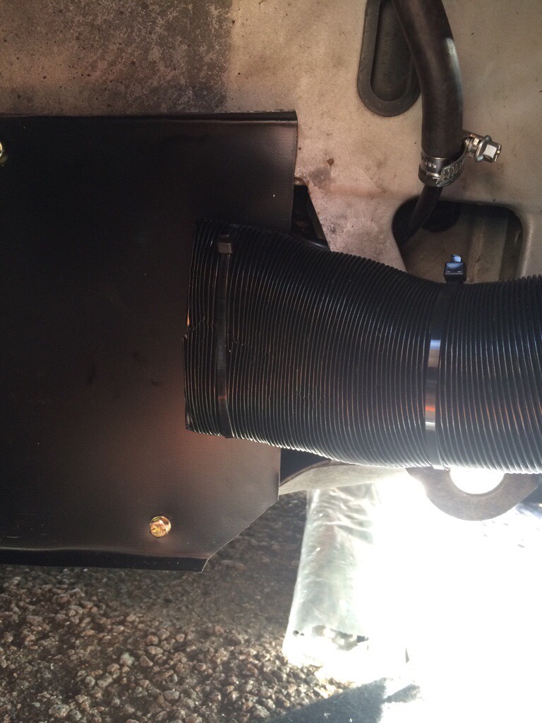

On my current set up that's what I've done. Kept my arch liners intact and bent the ducting round so it points to the calliper from the wishbone
What ducting did you use is it more rigid than like what is in markX picture? I was thinking like some hard plastic pipe or the foil type stuff. Have too move my cold air feed that goes too my maxigen filter first
Removing the arch liner completely is much easier and free. Plenty of air rushes into the arch towards the brakes that way :smile:
Just means you have to give it a rinse under there every now and again.

When I do my protect thread I'll post pictures of mine, think mine cost me about £12 and my time lol gonna use some nimbus head shield for deflectors as I've got it spare.

There are two types of CMComposite ones. Cup racer replica ones. I got these ones for £70 IIRC brand new. They fit a 75mm pipe on the back.

@GrahamS I actually prefer the other ones, the ones that are more square. Still a good looking duct though. (the ones you have)
