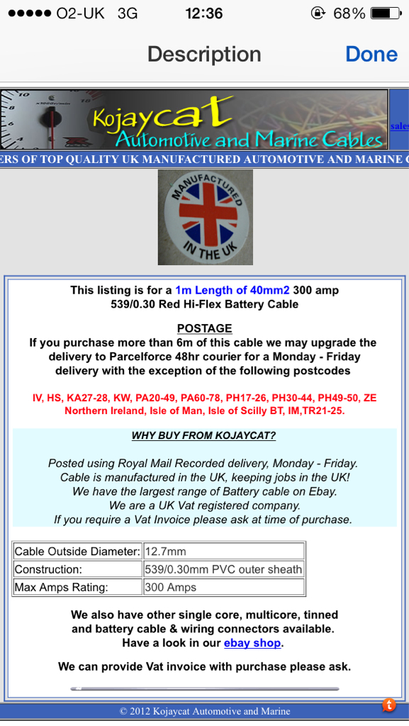

Would this cable be okay?

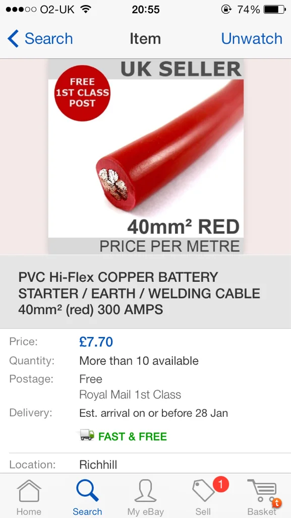

Does this mean anything to you?
I've emailed the seller to ask if it's cooper.
Why is getting cable so hard!
  Polo + Micra
40mm2 is an odd size (i would expect it to be either 35mm2 or 50mm2)
it does look decent enough

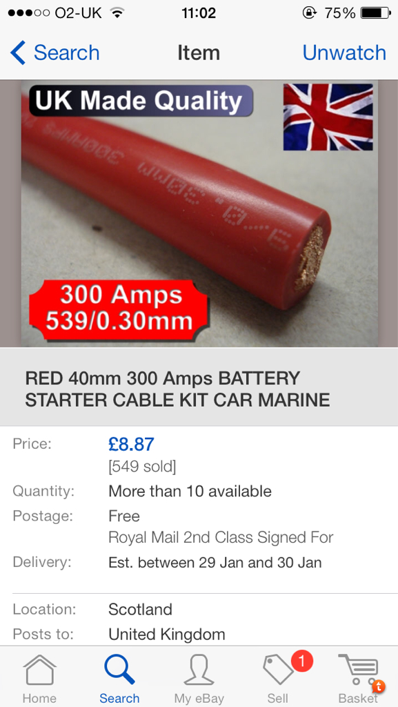

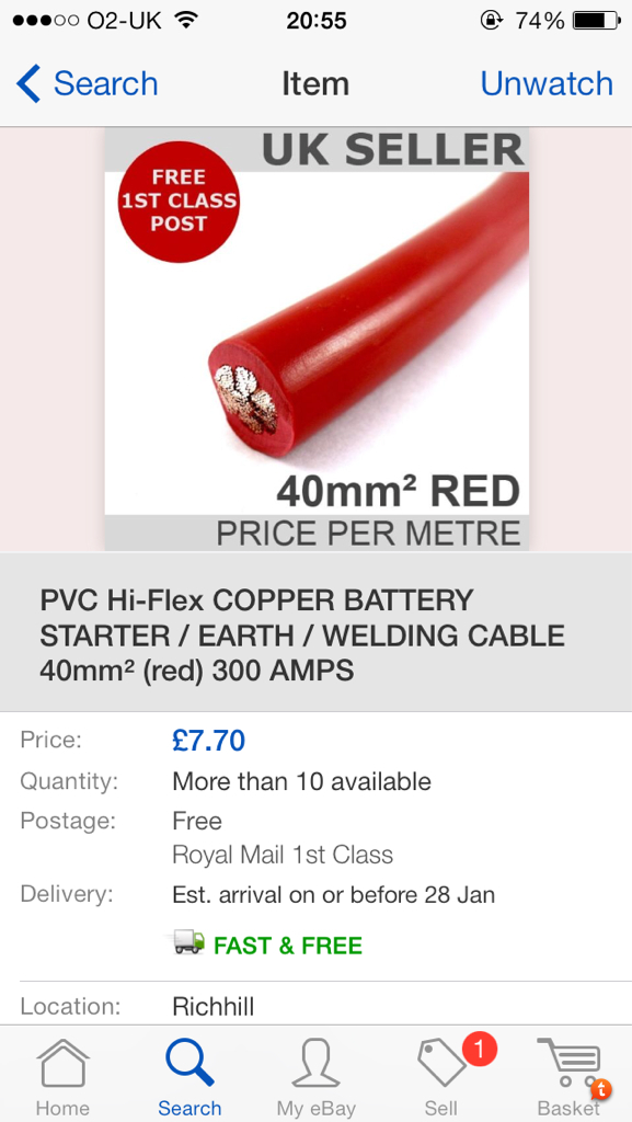

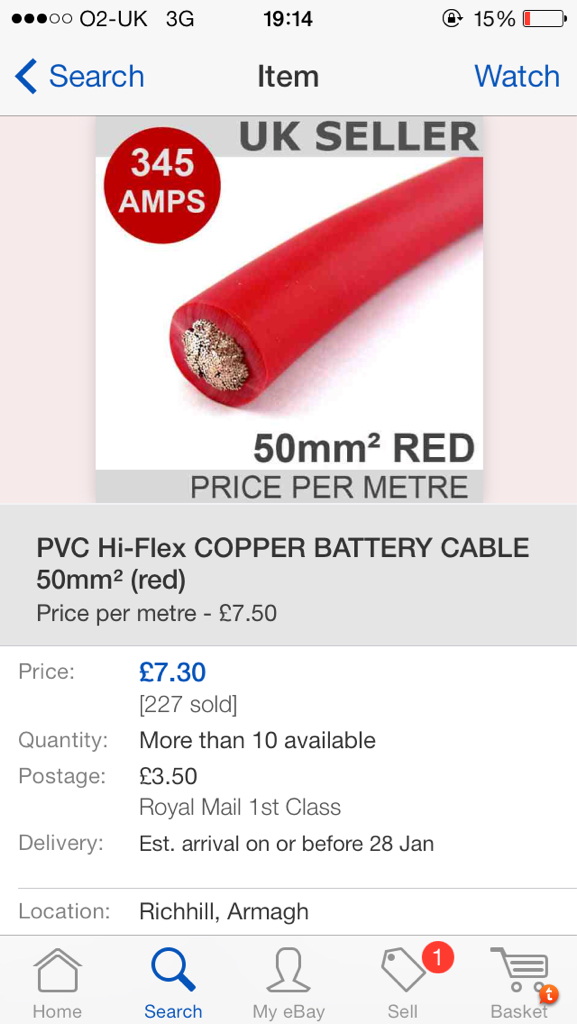

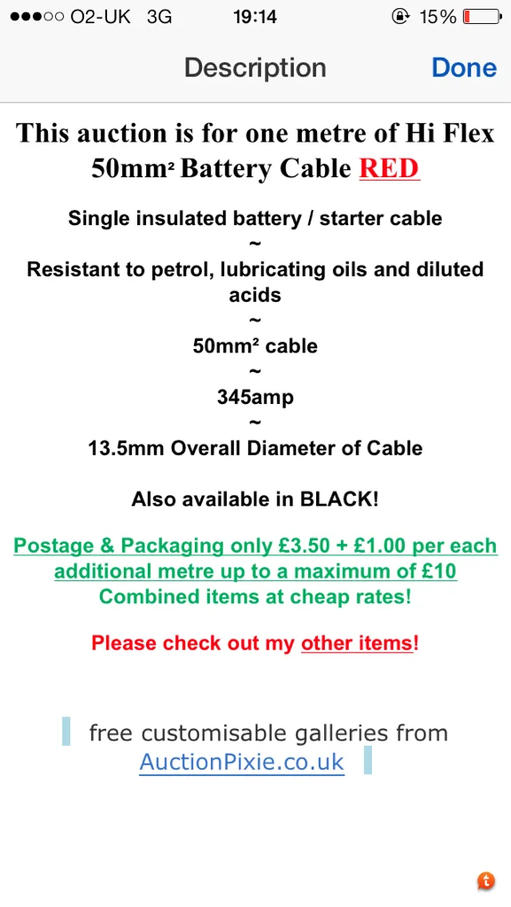

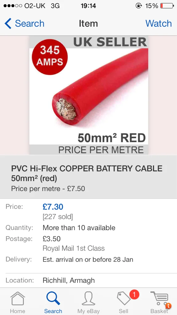

And will this cable be okay to use for the positive and the negative.
http://www.ebay.co.uk/itm/PVC-Hi-Fl...arts_Vehicles_CarParts_SM&hash=item1c3a1d95ad
  Clio Cup 172
I cannot guarantee that any of the above is suitable, I am not a car electrical specialist, but what you have listed appears to fit the bill. The only reservation that I would have is the fuse size as I have used a 300 AMP fuse as I did read somewhere that if this is too low you could blow the fuse when starting. I think its in one of the links that I posted above.

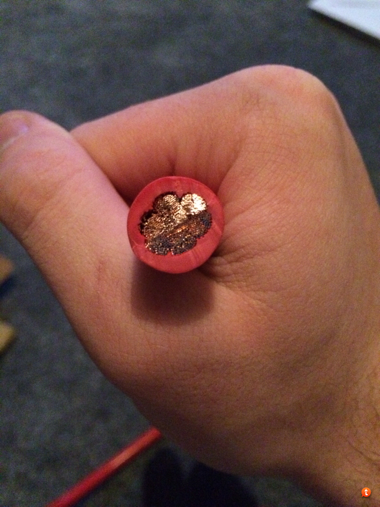

This stuff I've got is pretty thick. I really hope I will get it through the hole with the bonnet release cable!

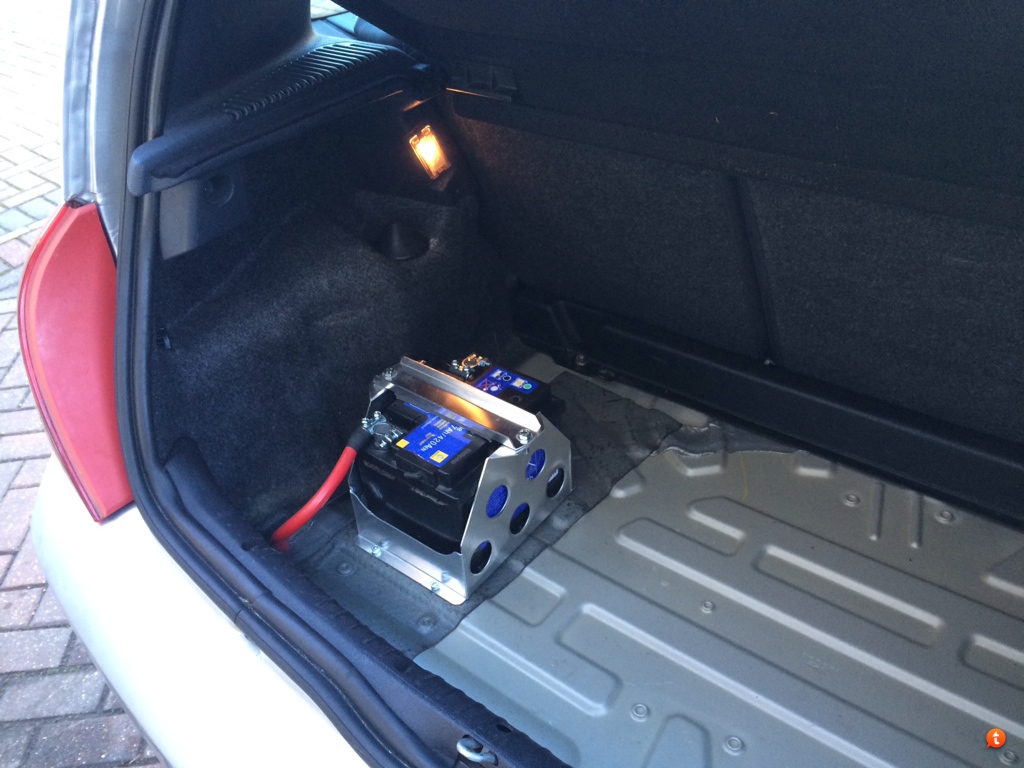

Got it all wired in today, before the heavens opened. Still need to bolt in the battery cage in the boot.
Just trying to work out the best place to bolt it now.
Starts lovely, just like it use to.

Bloody hell that cable is massive! Did you have any problems routing it through from the bay and through the inside?
Yes it's massive! Never going to have any problems with it drawing electricity on cold morning starts!
I struggled but got it through the grommet were the bonnet release cable goes through.
I did have to remove the passenger seat to get the cable through that section.

Where did you get the battery tray btw?
  Clio 182 FF
On eBay... Costs £40 but it fits the battery perfectly. Looks pretty smart to. Going to cut out a rectangle on the boot mat when I get a chance to.
