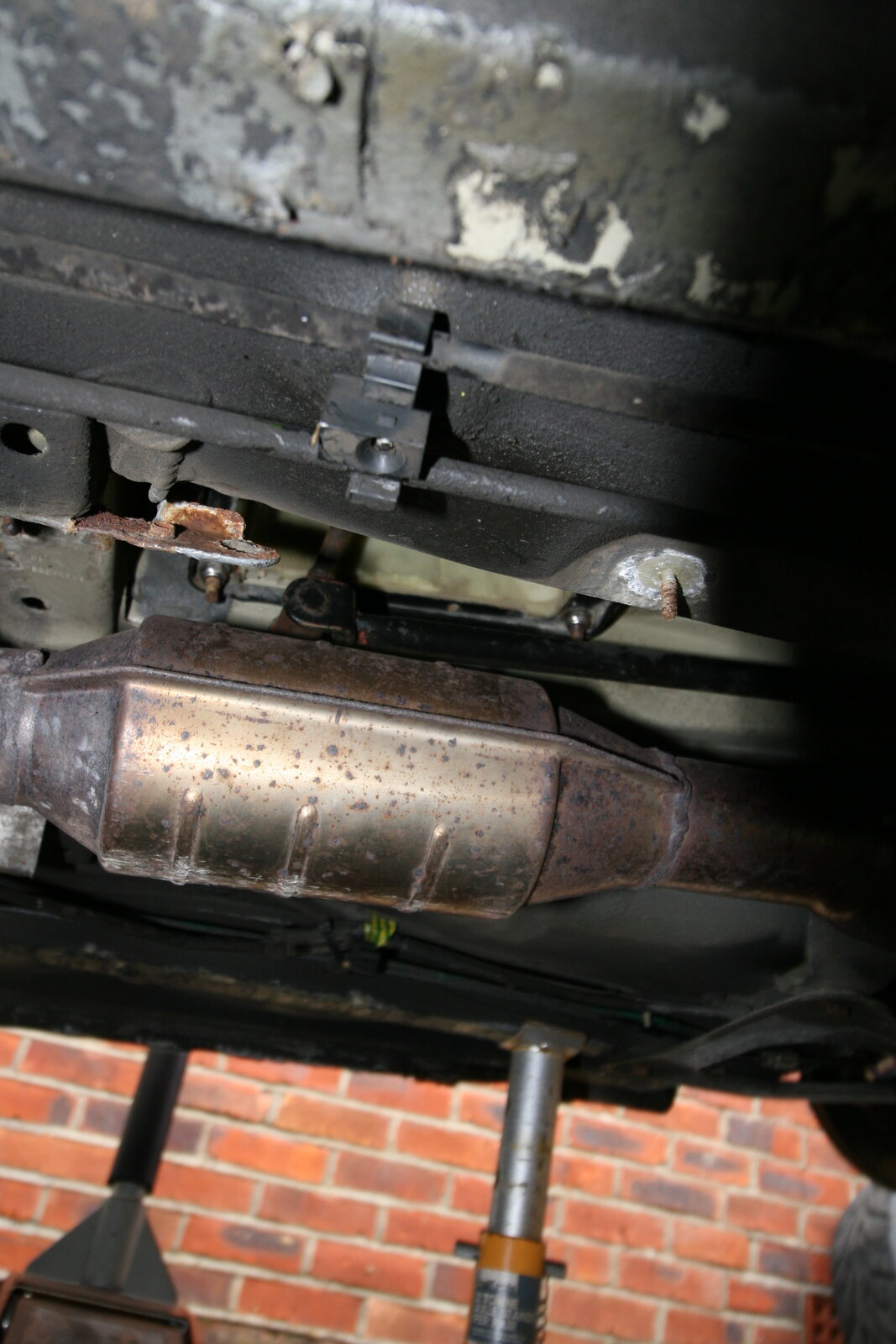

Frayz the pic above that Zach posted is of a shifter i sold him it was extended in the same way as the BMS. If your worried about clearance you could get Ash to make you one with the bottom linkage extended less, this would give a slightly longer throw but would still give the benefit of the shifter being closer to the wheel.
Another option would be to get the top side of the shifter modified by Ash, leaving the lower section standard then fit it along with a short shift linkage that goes at the gearbox end . This should give the shorter shift along with closer shift position but with no issues of cat clearance.

I found that when I fitted my cat back in place, the selector shaft rubbed. With a bit of a tweak on the heat shield I managed to get it to clear. Its tight but does work.
I dont know if I have any pics mind as I went back to a decat after a few days. I'll see if I have some.
frayz
I have 1 pic but it doesnt really show anything unfortunately. But as mentioned, it does miss but the heat should needs to be tweaked to do so.

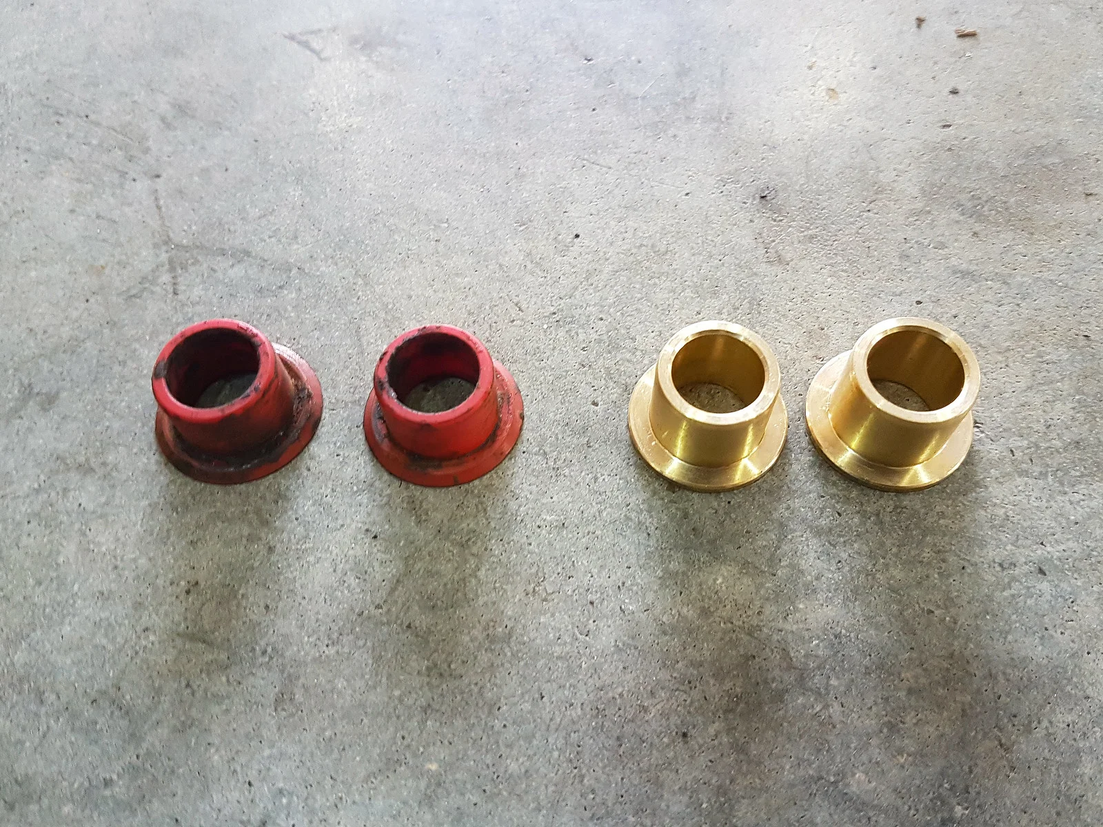

On another note, it might be worth changing the lower bushes to brass ones. Yahoo on here does them and they helped the feel of the shifter also for not a lot of money.
neil a
Ash also does the brass bushings .
Did you notice any more noise with the brass bushings over the original, im tempted to get a set before i fit my bms shifter but again wanting to minimize cabin noise.
