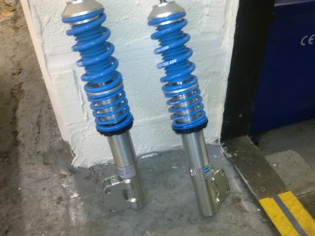

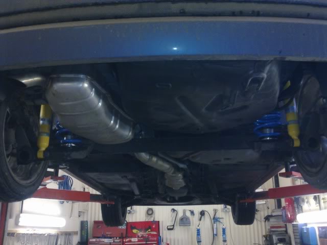

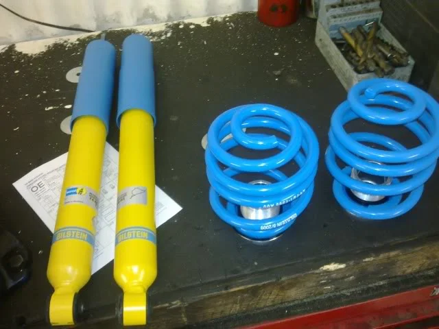

Really rate mine. Not the same as H&R (which i've had before on previous x3 RS Clios) They have different (harder) spring rates, and wont lower as much on the rear. As said they use monotube technology, so again different to the H&R''d. Very direct/pointy set up. Slight trade off is they can be a touch harsh over the rutted pot holed roads at the min (round town). But very good an A/B roads. Need to pull my finger out and get them properly set up with tracking/camber.
Few on mine,
They also still look like new. The H&R's corrode very quickly for some reason.
