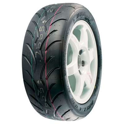

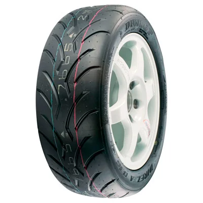

Dunlop
KumhoV70's, have you been on a wet track with them?
  V6 255, 172's, JCW,
Direzza's dry AD48 dry 888 dry damp and wet R1R's wet to very wet, wetter than a wet thing
