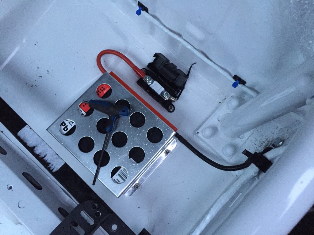

I run a powervamp clubsport with a manual Fia cut off switch, seems a decent battery to be fair and as long as the switch is left disconnected the battery stays charged, even in the cold weather we've recently had. I only use my clio on track so I only tend to start it up once a week and it's never let me down yet.
Relocated behind passenger seat with cut off switch on a dash pod, I've used a long acre bulkhead pass through terminal post to get power to the engine bay, and run a 150 mega fuse next to battery

99% certain I've used what was originally the bolt hole for passenger seat belt, where the spiral bar bolted into the base of the B pillar.
Its the first time I've done it so there's probably easier ways to do things but mine works perfectly well, does need some tidying up but that'll be done once I've finished the dash properly and put in a new dash pod for good measure (angled cm composite one)
I'd highly recommend a heavy duty crimp tool for attaching terminals, I beefed mine up by soldering after crimping too, something like this should do the trick (ebay) 221359888835

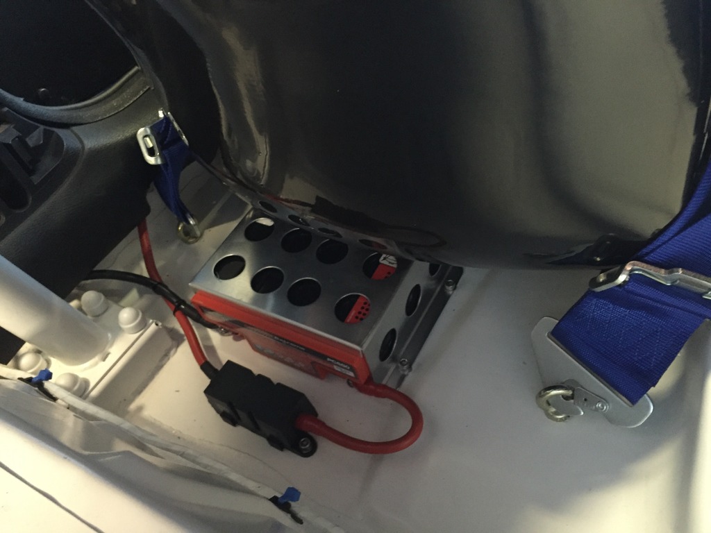

Odyssey behind the passenger seat with mega fuse :smile: Until Sunday I'd not started the Clio since it's last track day in November, 1st turn it fired, great batteries!

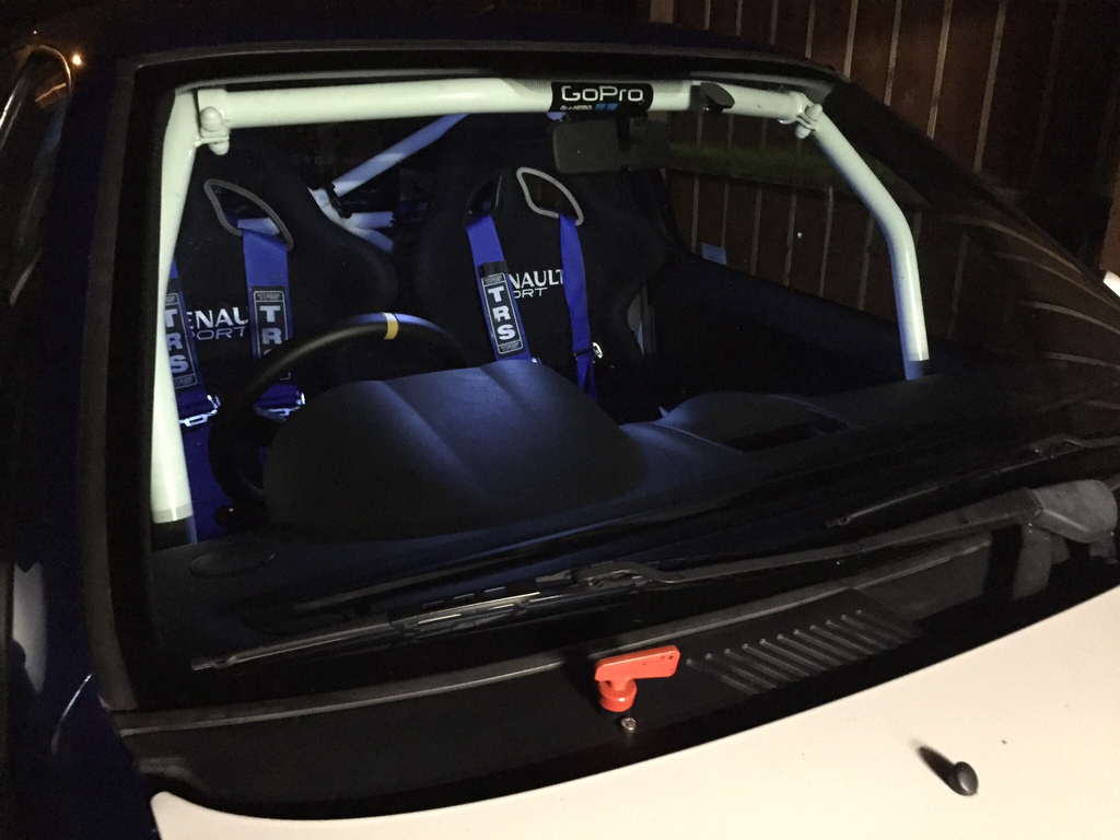

Yes Ben, still run the alarm and central locking :smile:

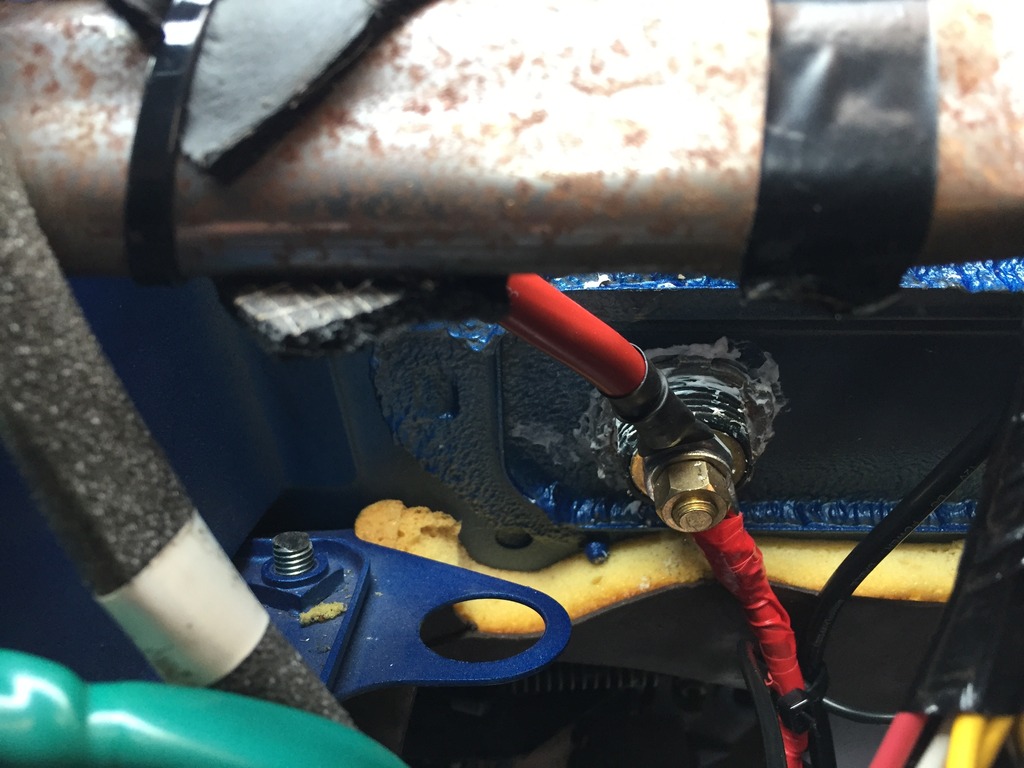

I used a longacre pass through to get the battery cable through the bulkhead behind the dash clocks and have a kill switch on the scuttle panel.
Odyssey is a PC680, I was worried it wouldn't be up to the job but it's superb :up:
Longacre

Kill switch, as much for security as safety, remove the key and stash it somewhere away from the car :)

Kill switch, as much for security as safety, remove the key and stash it somewhere away from the car :smile:

The longacre point picture is that the back of the kill switch ?

That pic is the back of the longacre from the drivers seat, cable from battery, through a 175a mega fuse to the longacre, other side of longacre to kill switch in scuttle area and kill switch down to the connector at the original battery cable.

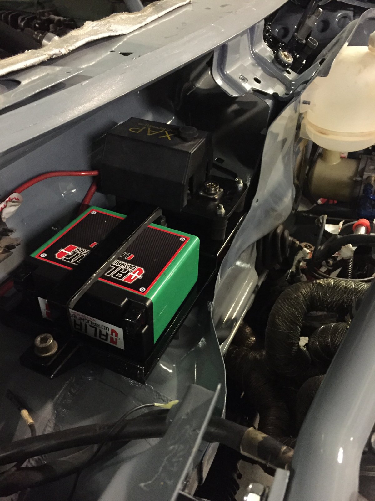

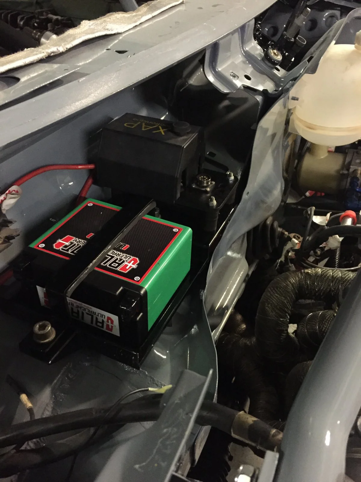

Stayed in the front scuttle with lighter battery
  Clio 182
Is that a lithium ion battery? Saw those at autosport show, looked smart and a fair bit lighter again aren't they!!?
Do they charge the same as a normal lead acid battery with standard alternator etc?
What size is that one?
  Amg A class, M3 CSL
Yes it's lithium, cars still getting built but had one on my last car and it worked well. Very light, just keep it on charge with a correct charger. I've forgotten the part number and I'm away at the moment. It's about 580 crank and 13/14 amp running

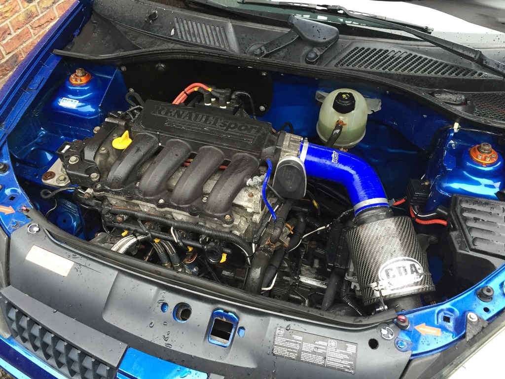

The junction box in the engine bay, it has anther red cable (that looks new) going to under the fuse box plastic tray - Is that going to the orginal clio loom for the battery? The reason I ask is because it looks brand new and in my head I would have assumed it be dirty from the existing clio loom?
AdamCup
Is there really a need for an additional fuse ? All you're doing it relocating the battery thus extending the power cables to back to the original power points, not installing a new circuit ?
No, that's going to the kill switch, then to the relocated battery :smile: the one going under the intake is the original battery cable
