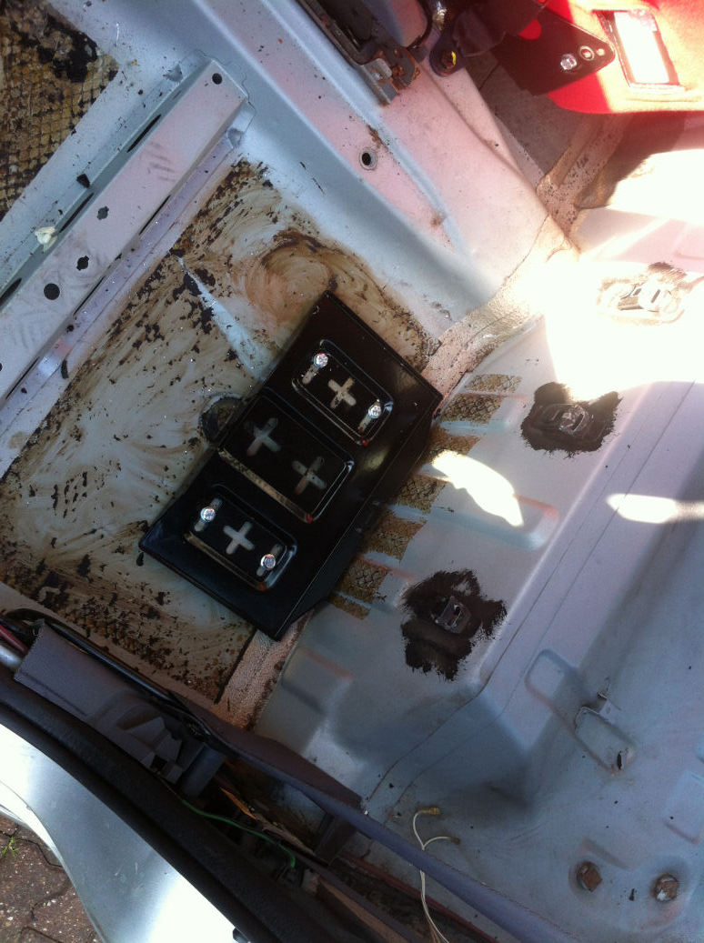

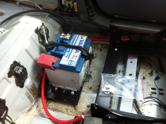

Unfortunately I bought the wrong battery tray, some universal thing. I had to put some blocks of wood in to ensure the battery will not move.
I should have just bought a proper box but was trying to save money

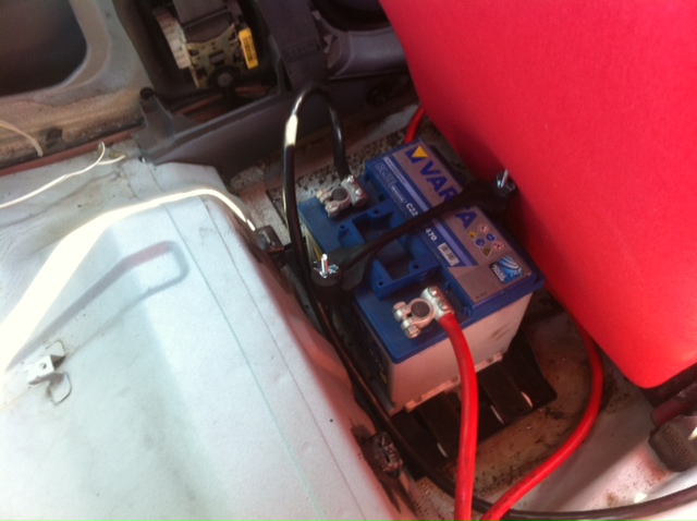

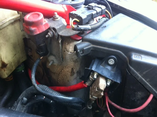

  Track 172 Cup
@Fantom do you have a picture of how its wired under the bonnet, I'm thinking of moving mine and using the BMW cable to connect it all together.
