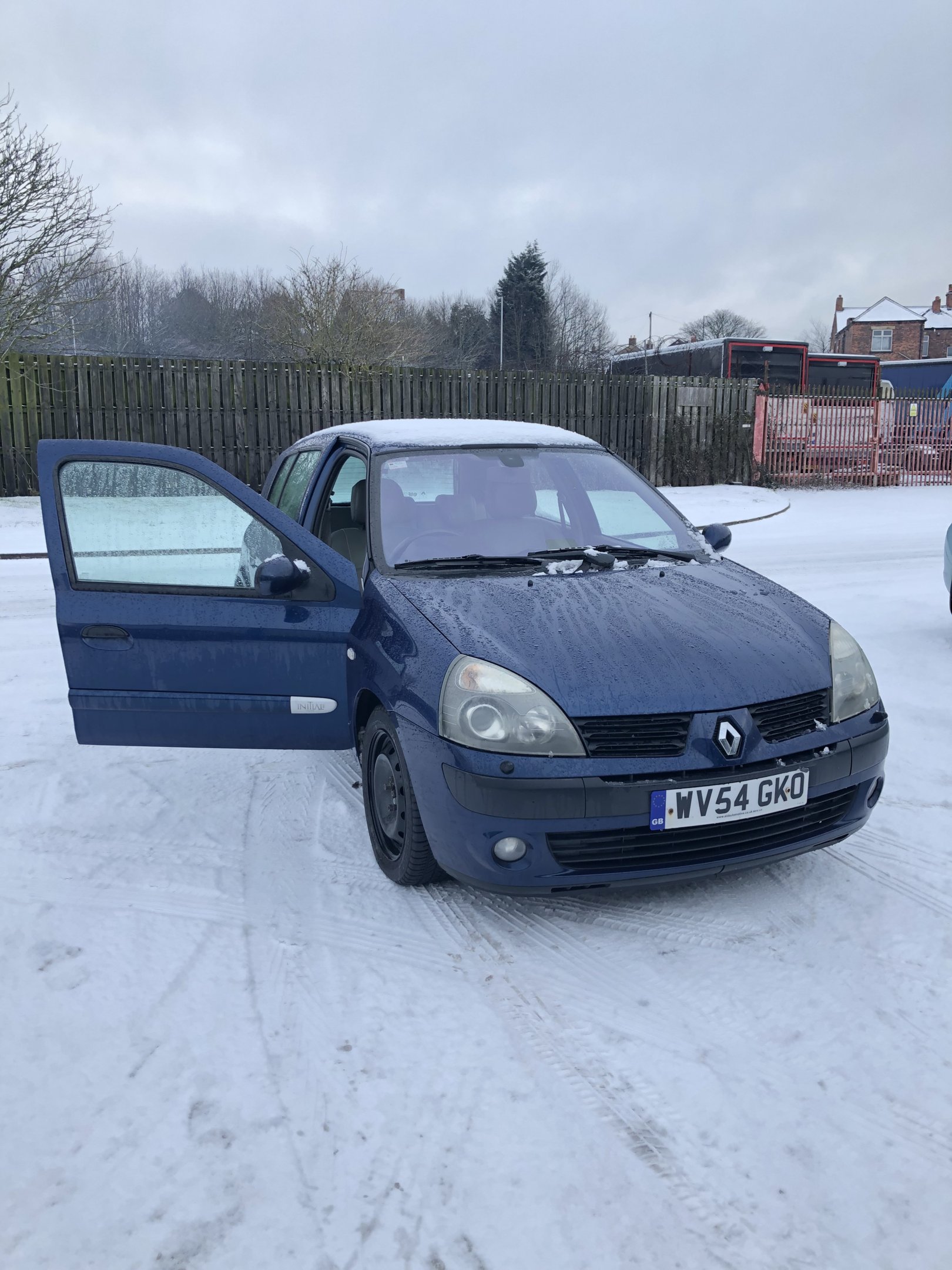

just over a week ago, I bought a 3 door dci for £675. It was rough, but it seemed like it would do the job. 20 minutes later the dash was flashing with warning lights so I took it straight back and got my money back. Such a lucky escape! I had taxed and insured it before setting off so that was a mess on to sort, but i was just relieved that I had got my money back!
So the hunt continued. Autotrader, gumtree, facebook and ebay daily still returning nothing decent, and that was hundreds of miles away! Until Saturday late afternoon.... one popped up that looked brilliant. 5 door which i wanted, Initiale model so the best spec you can get and also on insurance check it showed it was the dci 100 model! It was advertised for just £250! The advert was vague. It said sold for repair or spare but no description what was wrong orher than it only had a few weeks mot left and the engine management light was on. Pictures below from the advert...
I rang the seller, and he said he had just took it in part ex. He said it was in ok condition and drove fine, but was worth scrap value to him and if it didnt sell, thats where it wuld be going! He told me the guy who part ex’d it in had travelled from Bristol to him in Grimsby so i felt hopeful it was in working condition to travel the 200+ mile journey!
It would be a 148 mile journey for me to Grimsby, but thought it was worth a look so I agreed to travel down the next day and if all was well, i would take it away with me.

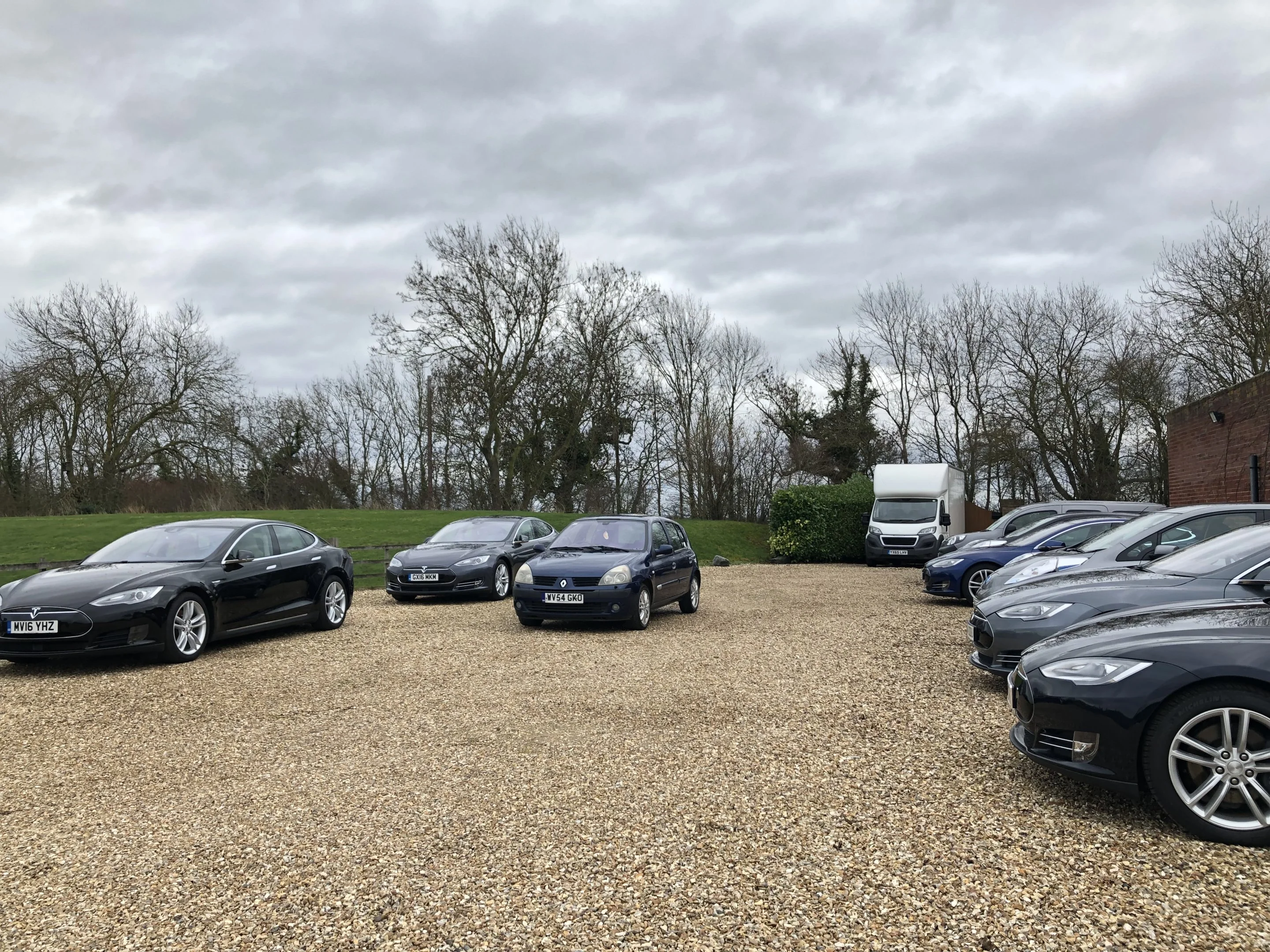

We arrived sunday early afternoon and it was parked up in the middle of his yard, within the grounds of his massive farm house surrounded by a load of Teslas. Turns out he trades in more expensive used cars and did only take this clio in as part ex, which I assume was probably so the guy picking his new car up could get there easily.
I had a quick wal around and it looked in decent condition for a 15 year old car. Had a look underneath and no obvious leaks of any kind. Sump was dry, suspension was dry but could tell it was old. One front tyre was bald on both the edges. It has the xenons which worked. The guy said there is a loud noise coming from the rear and he didnt know what it was.
He gave me the key and said take it for a drive. He was surrounded by country roads so the perfect location to test it and see if any warning lights came up when reaching speed! I floored it through all gears! No noises, no smoke and no warning lights! I was surprised at how well it drove! I knew at this point I was going to take it with me.

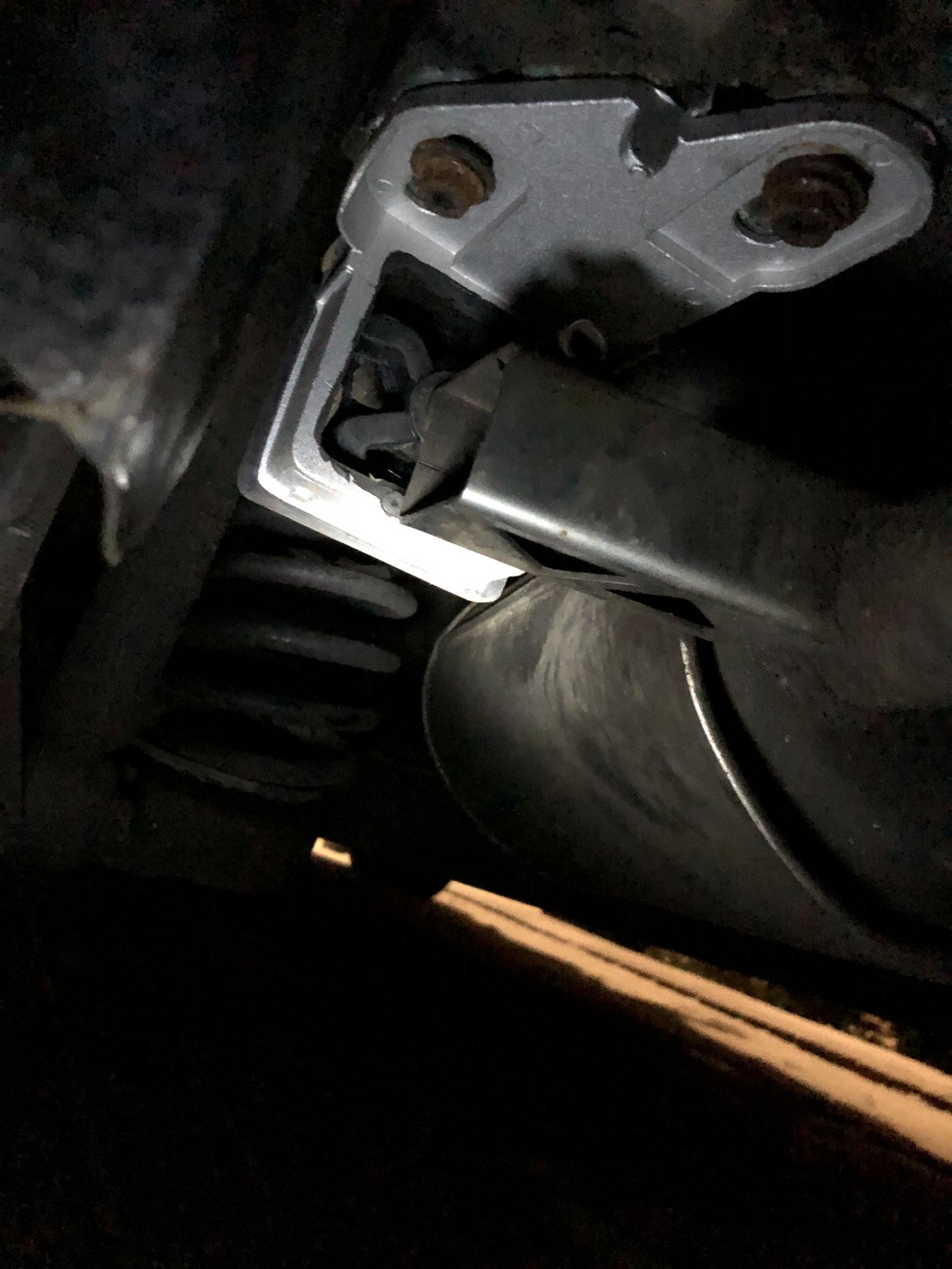

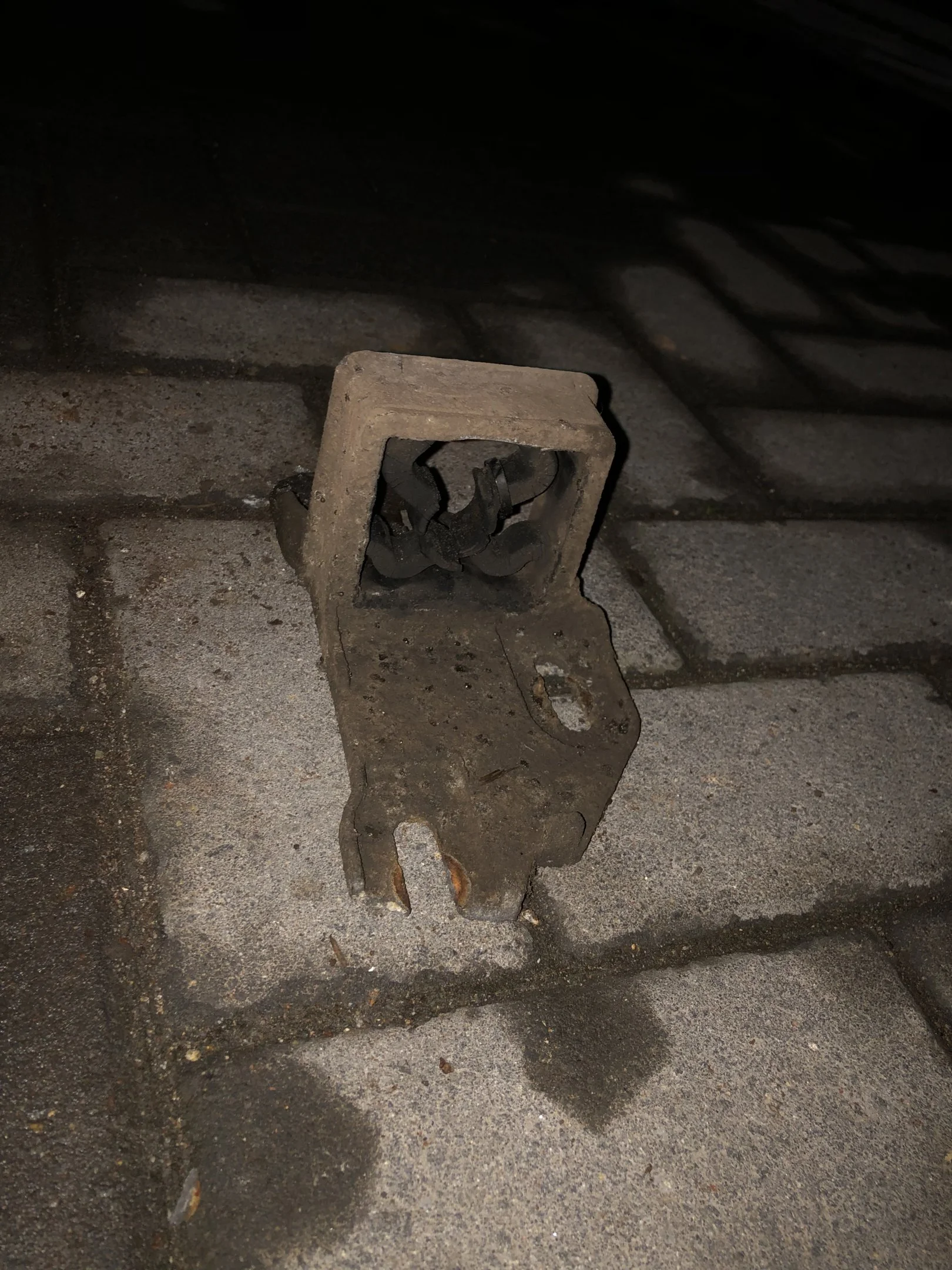

I had a look underneath the rear and as expected, the loud noise was a perished exhaust mount. Easy fix. Brakes look like they could do with being changed, but it atill stopped well enough! I put the passenger windown down just as we started the test drive and it wouldnt go up but wasnt worried as i knew it would be an easy fix whatever it was.
I pulled back into the sellers yard and told him about the window. I said i would take it away as it was of he would accept £200. (In reaity i would if paid £500, never mind the £250 he advertised it for). He said yes straight away, but said he wouldnt let me drive it away with the window stuck down so got some tools and took the switch out. A wiggle of the wire and the window button worked again and the window went back up. Brilliant, an even easier fix for me than expected!

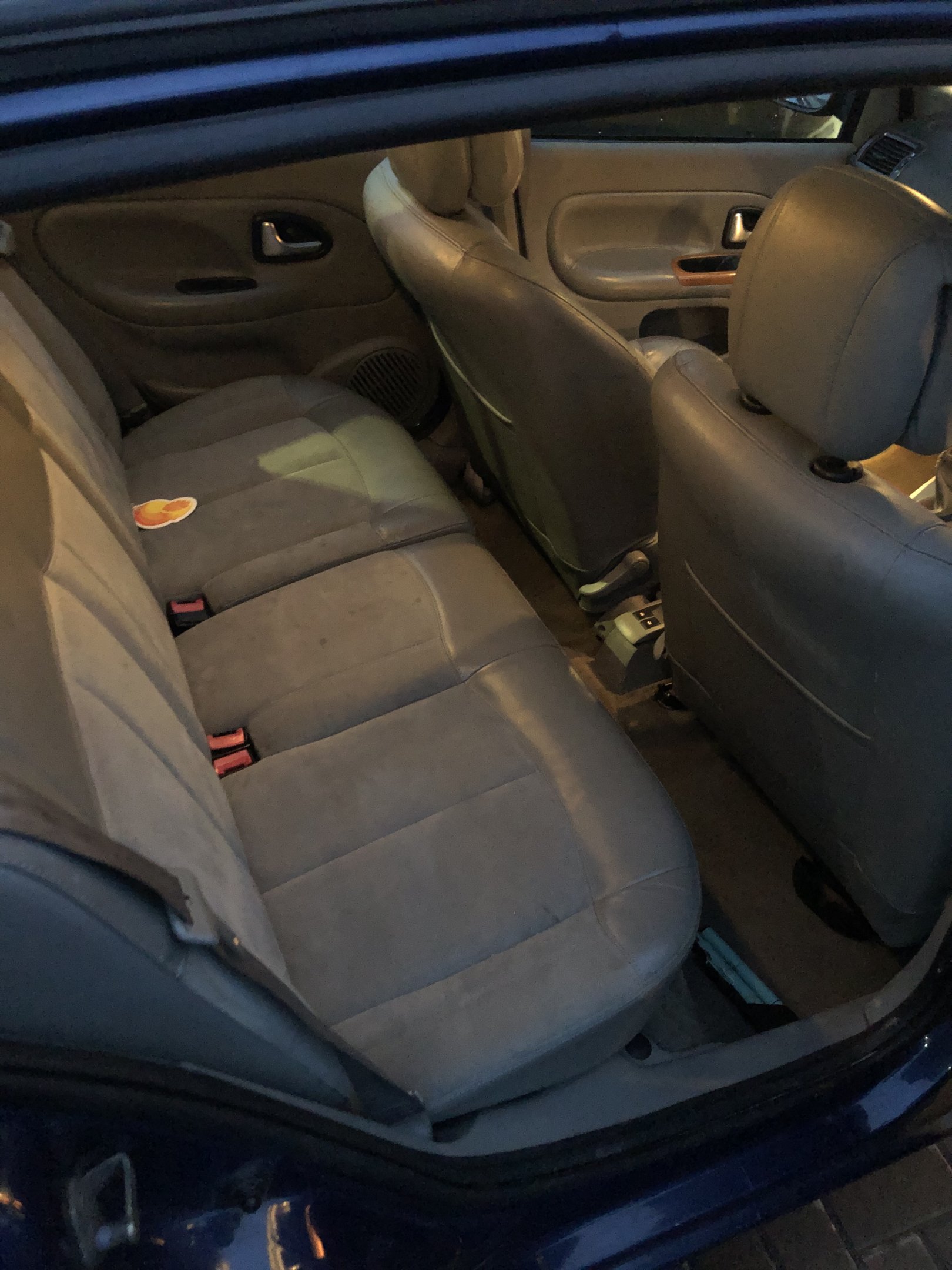

The interior is filthy! And so is the engine bay but i look forward to giving the whole car a good clean.

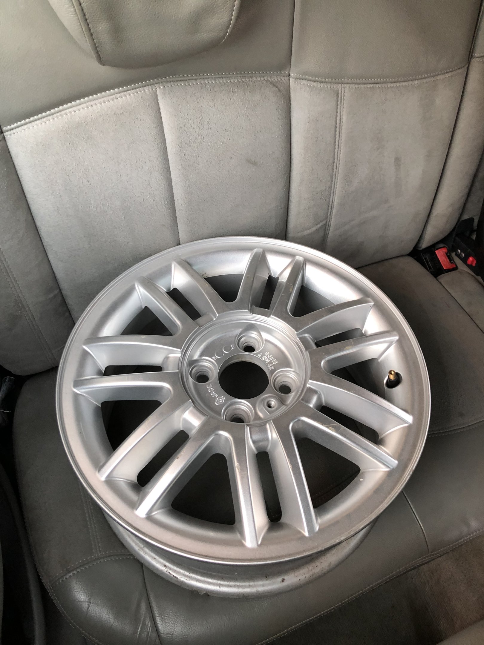

Them Jade alloys are worth more than the £200 you paid for the car mate. f**king right bargain haha

Are the alloys sought after?
YorkshireKyle
Nice one mate! I will probably be in touch at some point then. Not had a 100 before so not sure if / what the common issues are. And i will know more on Saturday after the mot.
Not sought after massively but they made very, very, very limited numbers of Paris Initiale's and only did them in dCi 80/100 and 1.6 engines for the MK2/PH2. You're lucky to find any Jade alloys for sale in Europe, I've been looking for 3 years for some for a friends dCi 80 Initiale. It took him 4 years to find a new rear bench for it😂

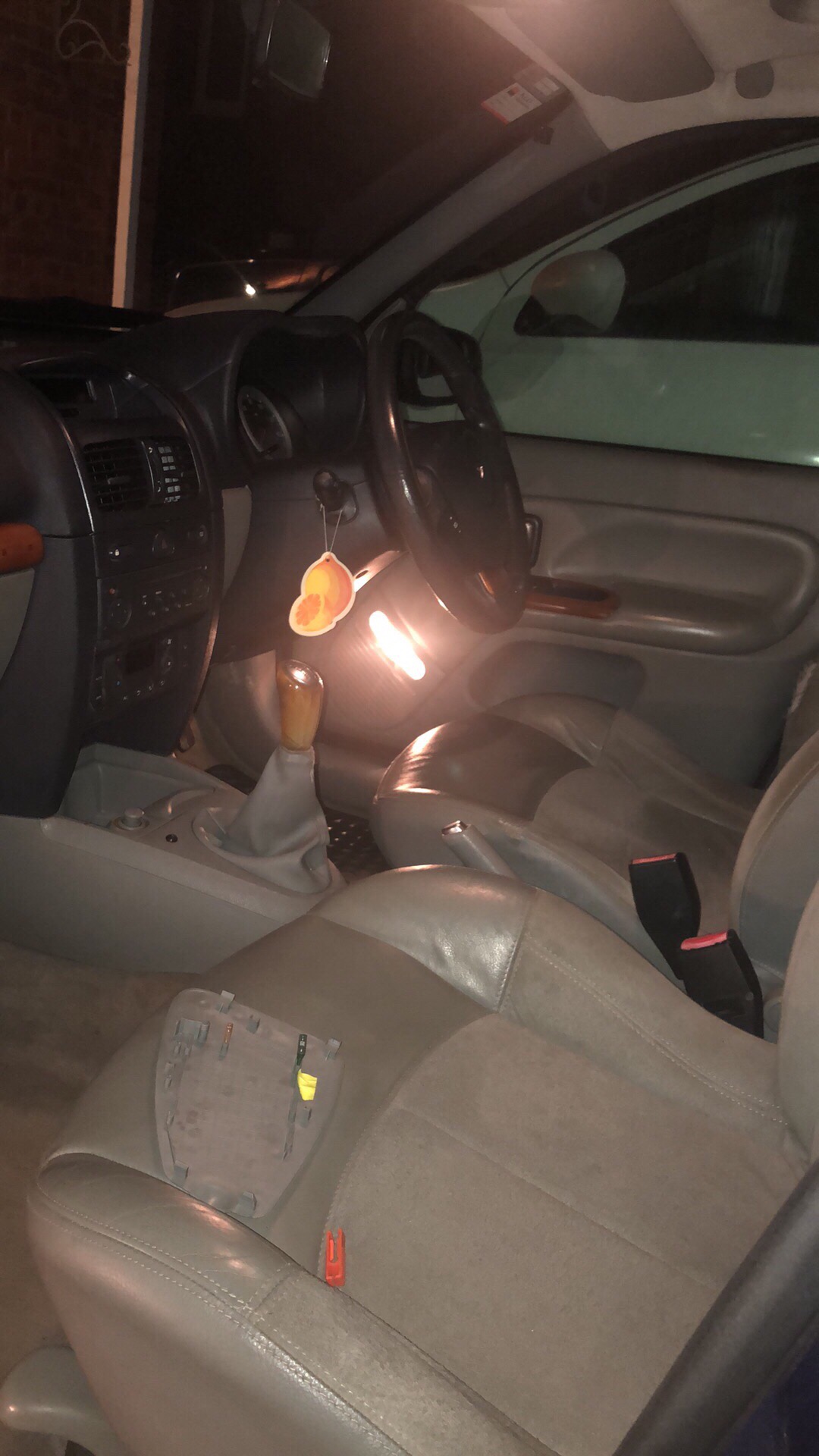

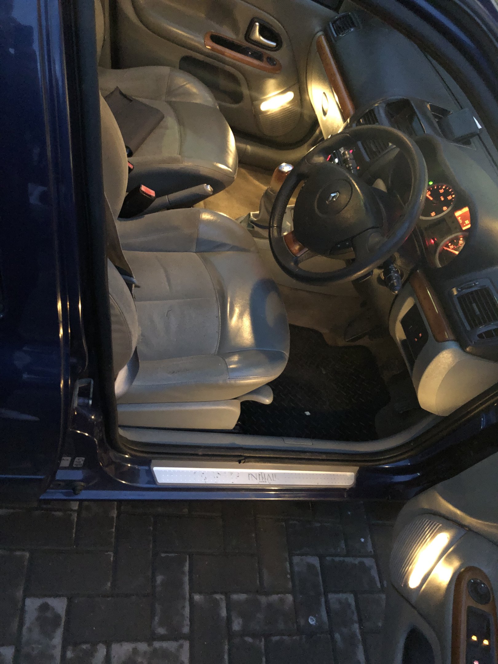

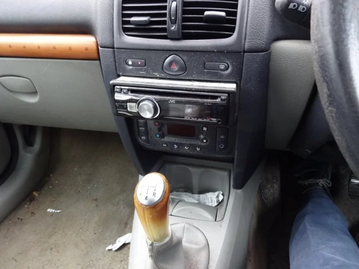

Super balla spec... ! Xenons, wooden dash trim and sport type steering wheel? rear electric windows? Or what are those switches on the console?, seat type very decent and it's colour coded with silver bullets. Looks like it had the Cabasse set up in looking at the door cards? Shame they removed the headunit. Also the door handles, whats going on??
Door card lights are awesome, I want them 😎
Yes mate it has the sport wheel with cruise control too lol. Rear electric windows but they aren't working! Need to figure out what it is.
Whats the Cabasse set up? Yes, aftermarket cd player is shocking! I have a tuner list on its way in the post to replace it.
It has a 6 cd changer under the passenger seat but i cant work out how to get thing thing out.
Haha! Door handles have the same wood effect that the dash strips and wheel insert has!
I agree, the door lights are really good!!

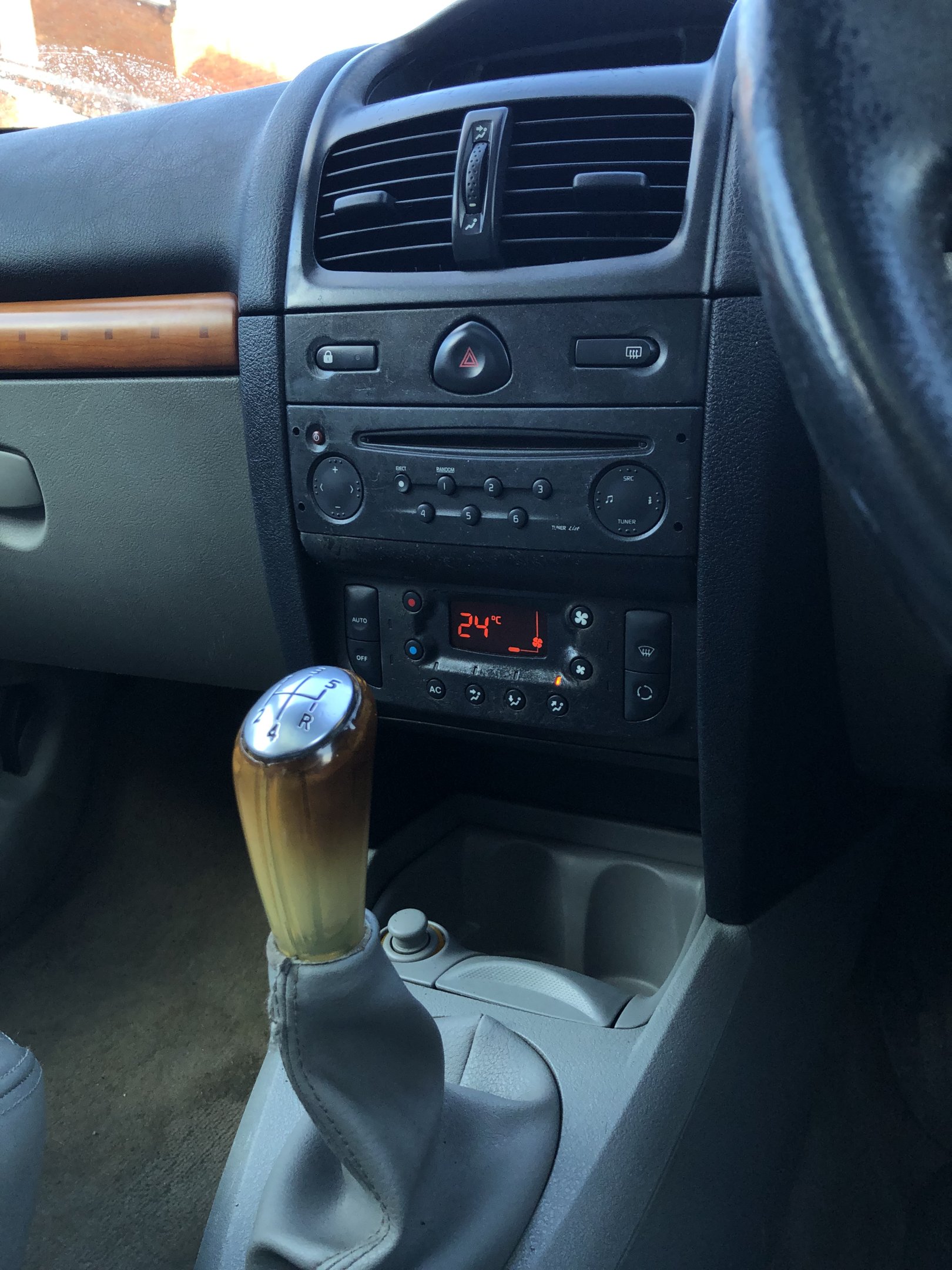

6 Disc won't power up until it's got the OE headunit in. Slide the lid across and press the button. They are Alpine I think?
On the speaker grills does it have little Cabasse emblems? Under the lights on yours? Looks like it in pics?
My 5 door looks poverty compared with this ! Same two tone dash though
First time I've seen the dCi 100 sex toy knob in wood trim too... got wood indeed, ha !

Haha its horrific tbh mate. I know its 15 year old, but was wood trim even a thing back then? I thought it was at least 30 years ago style ha ha!
The gear knob is so strange! Its massive! And also reverse is not in the usual clio position, next to 1st? Its as if it is in the space for a 6th gear. Do you know why?
Yes it does have that emblem on the lights. What does it mean? Just upgraded speakers?
Ah ok, yes its Alpine. Hopefully the tuner list will make it work...
The interior is filthy though! Would look quite smart if it was clean. I will get the carpet clearner onit all but need to wait for warmer weather otherwise it will never dry!

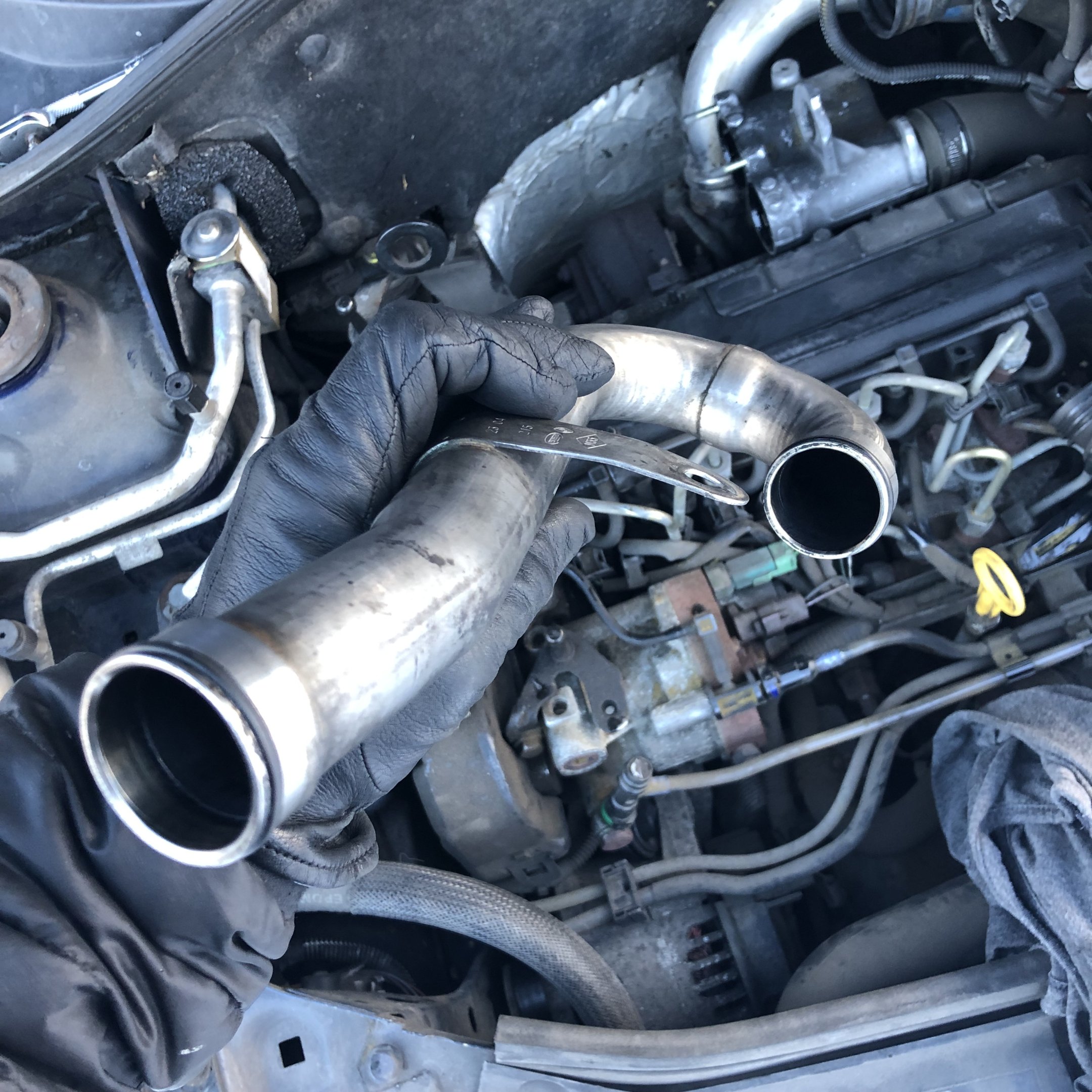

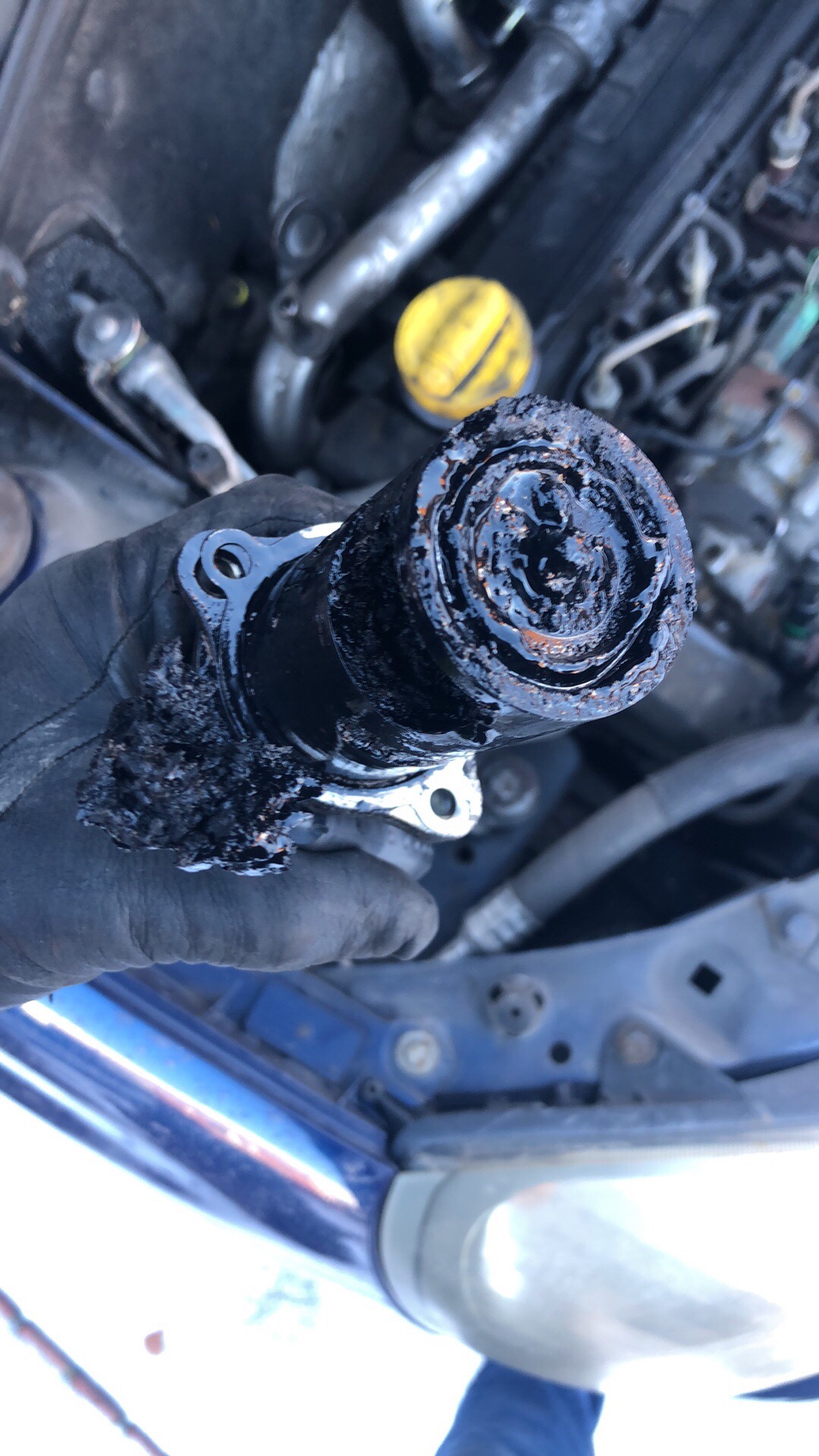

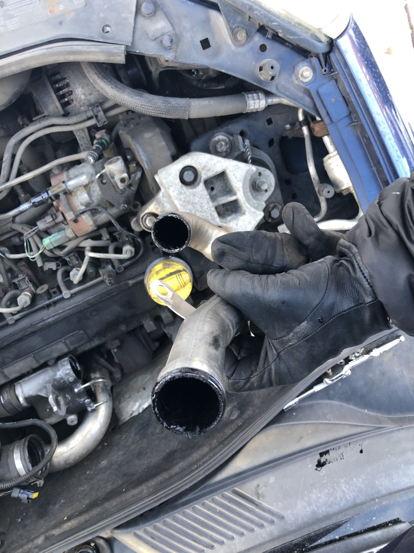

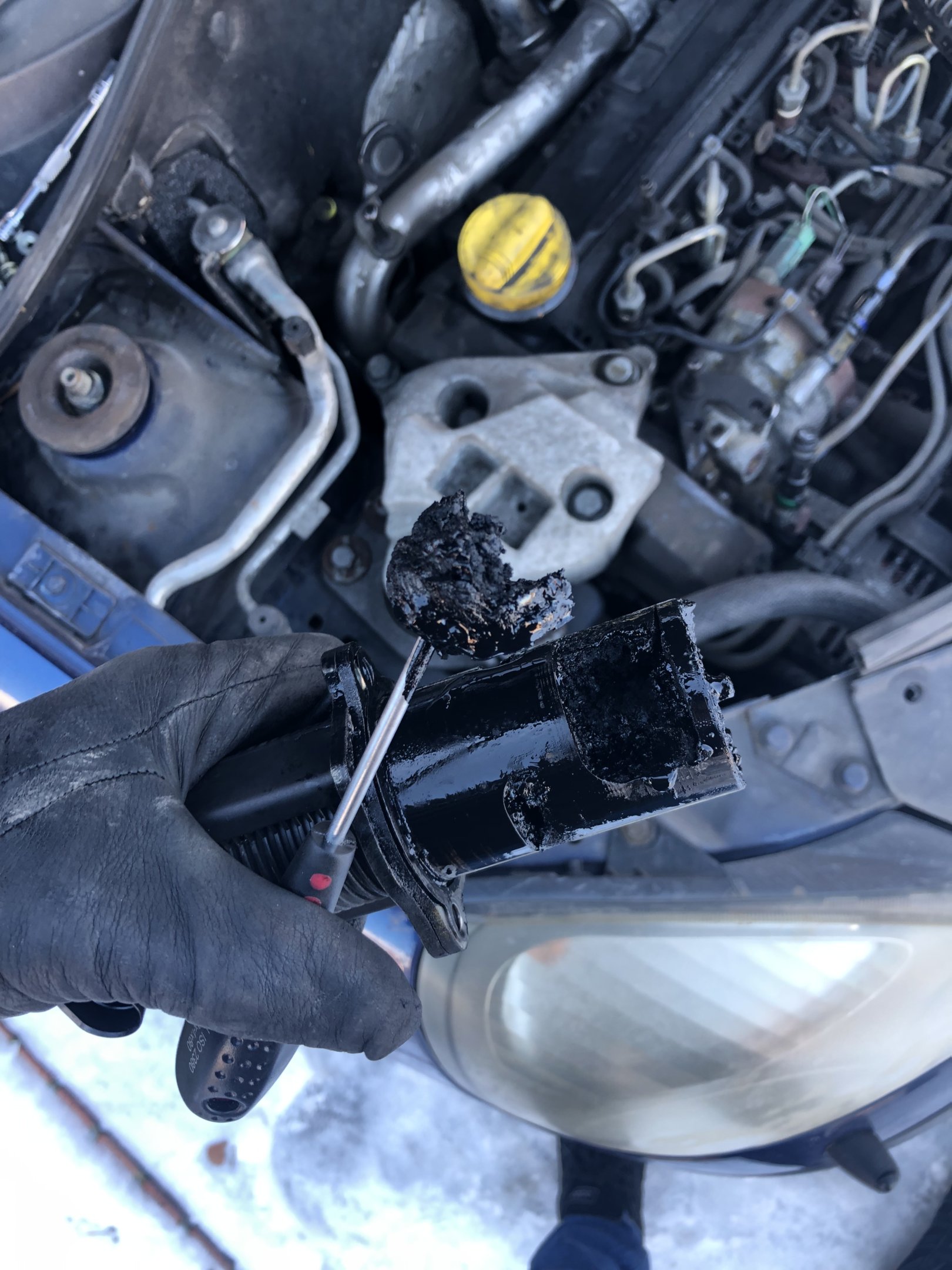

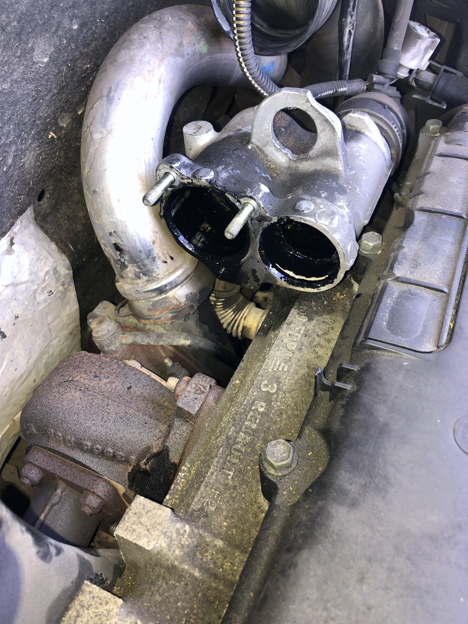

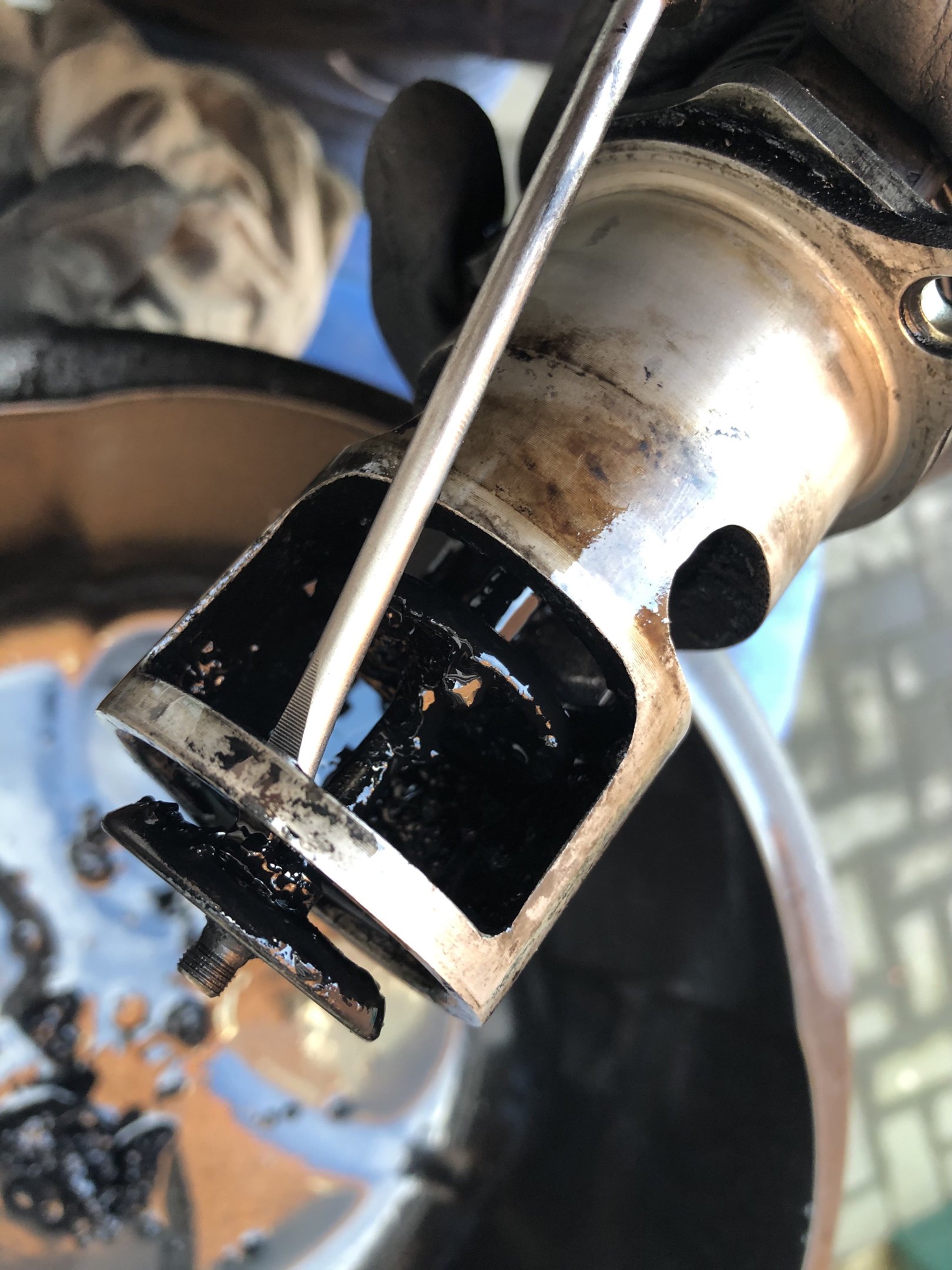

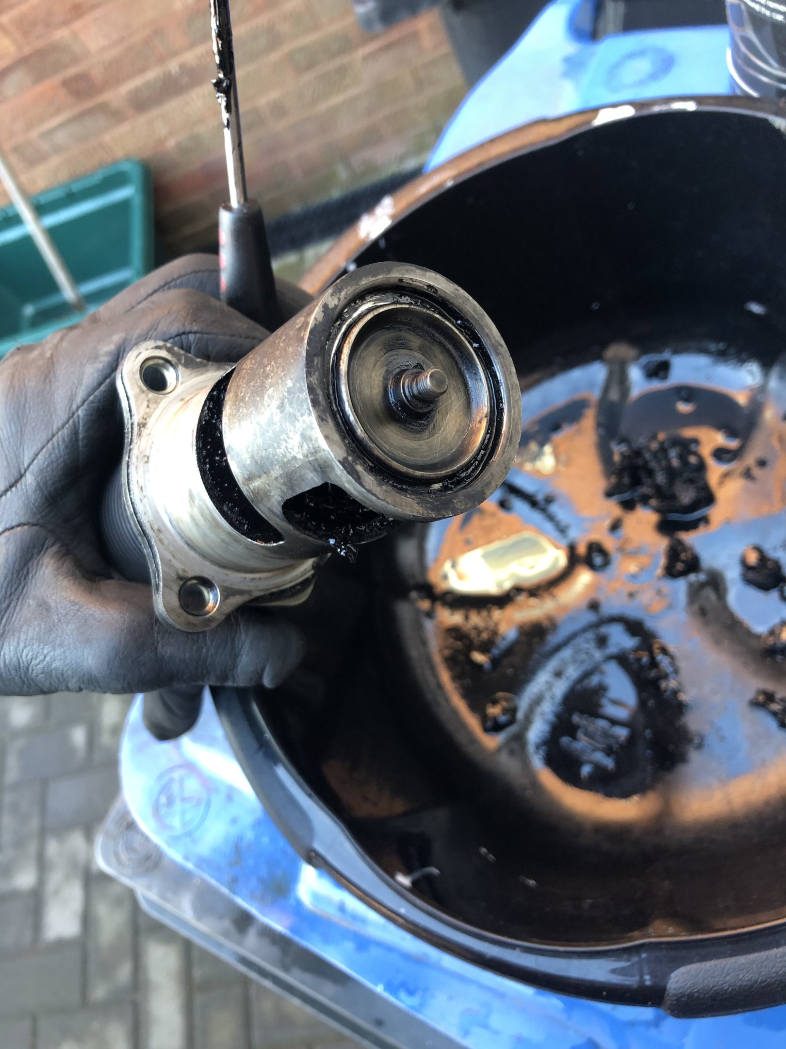

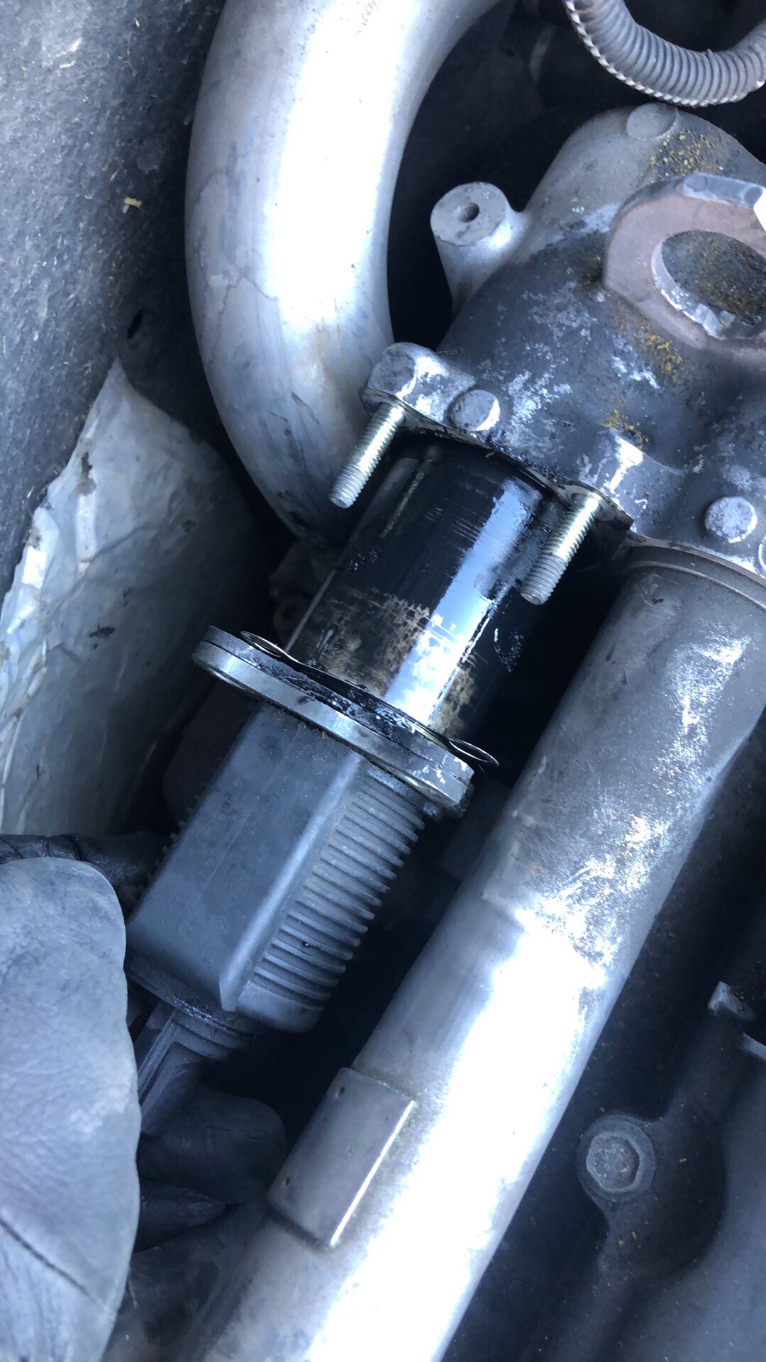

I decided to see what the egr valve was like and give it a clean. Massive thanks to @Brigsy who pretty much talked me through it step by step via messenger 👍🏽
It was straight forward when i understood exactly what i needed to be removing. The valve was covered in thick gunk. The shaft part was also really oily and when previously watching youtube videos on this, i think this may be a bad sign as it should be dry and not wet?
The pipe wasnt anywhere near as bad as i thought it would be after seeing the egr. I still gave it a good clean before putting it back on.

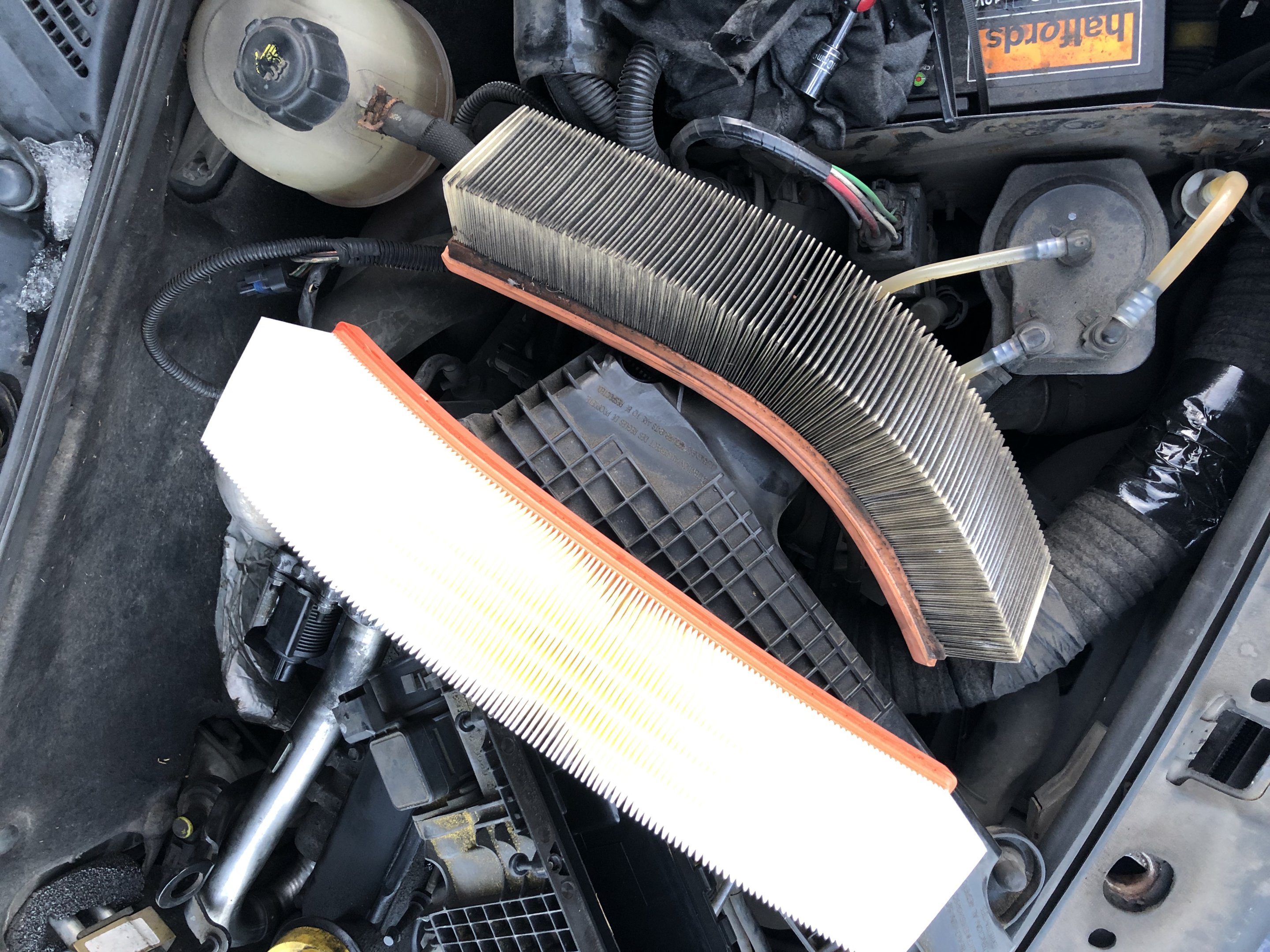

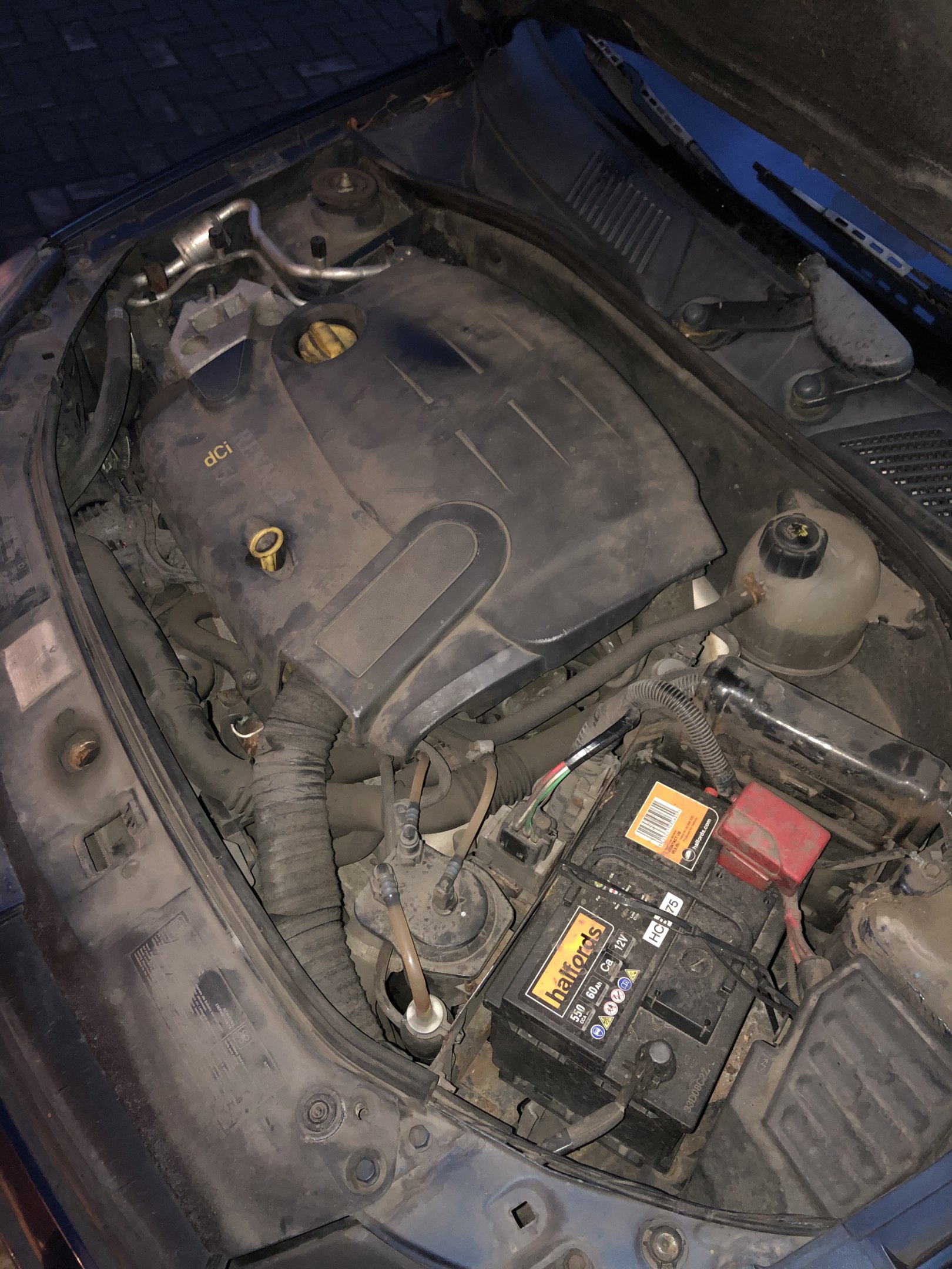

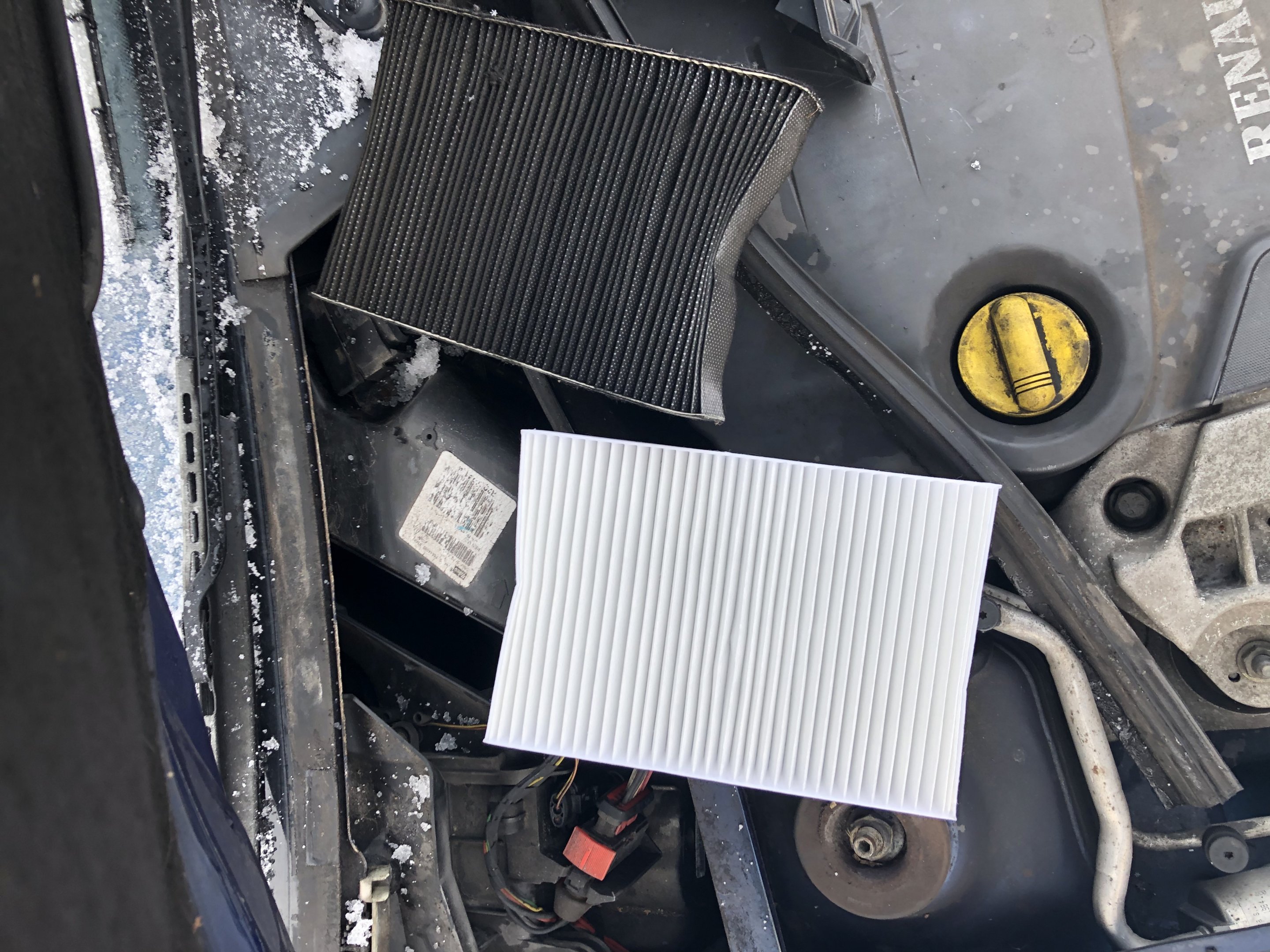

I picked up the service parts and made a start on that. I have changed the pollen filter and air filter. I will do the oil and oil filter tomorrow. I also bought 4x new glow plugs and will be getting a Delphi fuel filter.
You can see it has been a while since it was last serviced by the look of he filters!

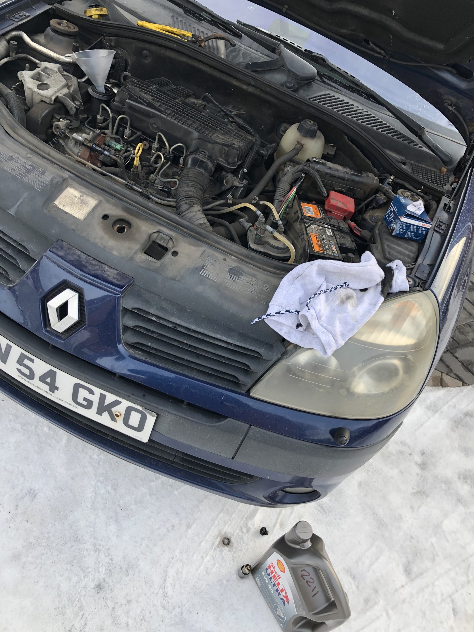

I changed the oil and oil filter on sunday, have a delphi fuel filter on the way to me in the post and have 4x glow plugs but im scared to change them as i have heard they snap easy!
Although i dont know when the cambelt was last changed, im sure it needs doing as the aux belt looks really old with visible cracks in it! I will get a price for this from a garage for this to be done.

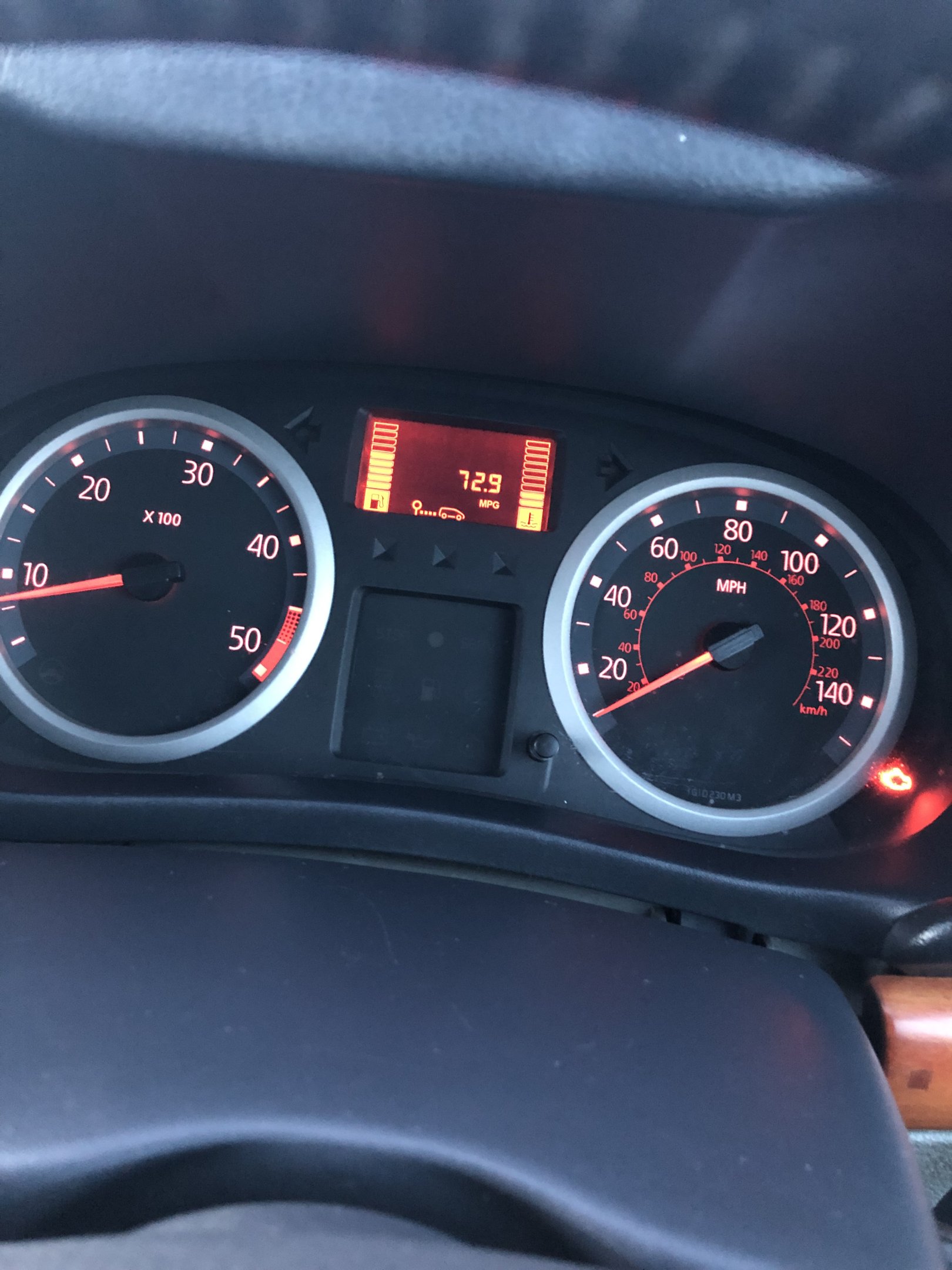

On my commute to work on Monday it saw upto 74mpg driving very carefully. Since then im averaging 58mpg which is still great.
I had a look online for the jade alloy wheels after hearing how rare they are, and i could only find one single wheel for sale which very strangely happened to be 2 miles from work! It was on ebay for £40 but he agreed to £22.50 after making a few offers. Thought it cant harm having a spare as if anything was to happen to one of the wheels it would be difficult to find a spare and would result in having to buy a full new set of a different type of wheel.
