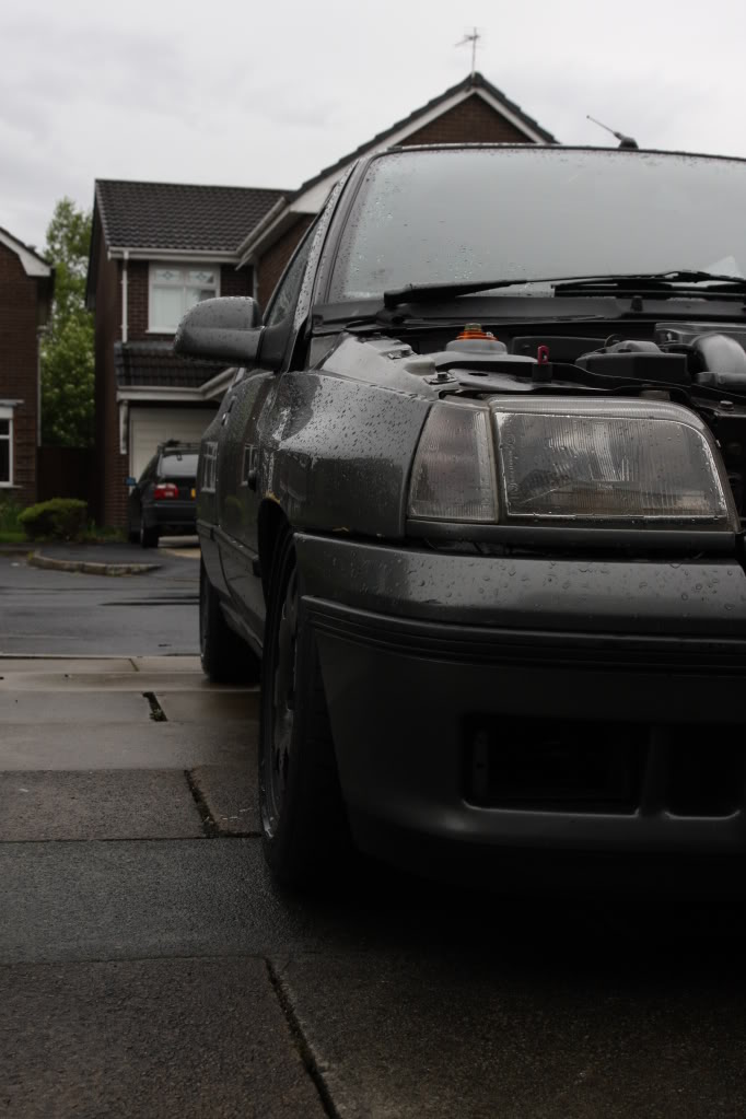

F0xy, can you tell us what the level of camber adjustment was for them on the Mk1?

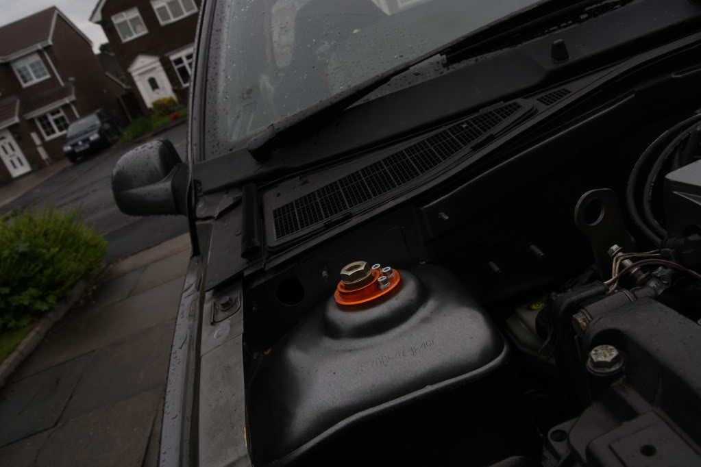

No idea on values...but to give you an idea.... My top mounts were set to MAXIMUM camber, and the shocks (FK Highsport/Slotted Holes) were set to MINIMUM, and it had this much (quite a lot!)...
I tried to set the shocks to MAXIMUM too, but it wouldnt go all the way as the wheel was touching the shock!
Jack car up, leave wheel on. Undo 3 allen keys and turn the top mount wit h a spanner, you can physically see the camber and castor change

The top pic, in my mind on how these work, is actually the minimum camber setting as the three bolts there would set the strut to be as vertical as possible, and for negative camber you want the bolts to be on the outside of the engine bay.
Thanks for the info f0xy. Northy on WC has been asking repeatedly how much they give hehe :)
Now youve said that I cant remember lol.
The shocks may have been on MAX and the top mounts on MIN....it was one way or the other lol!
  Clio Williams & 182
Haha! Well If you look at your setup there, and use logic to work out how camber is adjusted with these then the pics show you with pretty big camber but the mounts set to minimum camber so it must have been the slotted bolts holes dialing in the negative there :)
