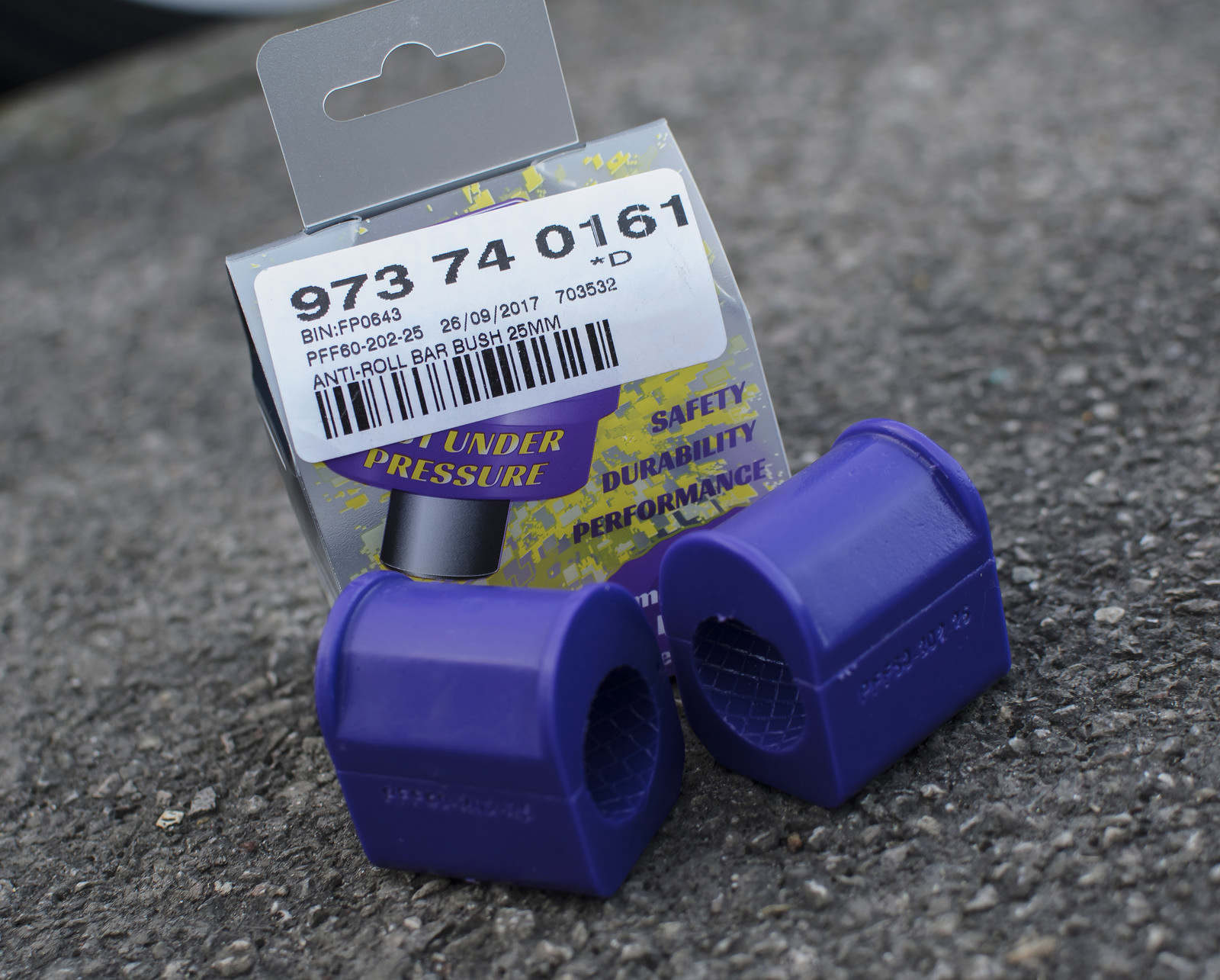

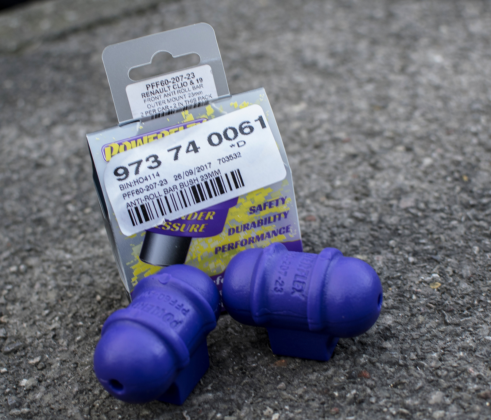

Outer ARB 23mm - PFF6020723 (ECP Part Number - 973740061)
Inner ARB 25mm - PFF6020225 (ECP Part Number - 973740161)

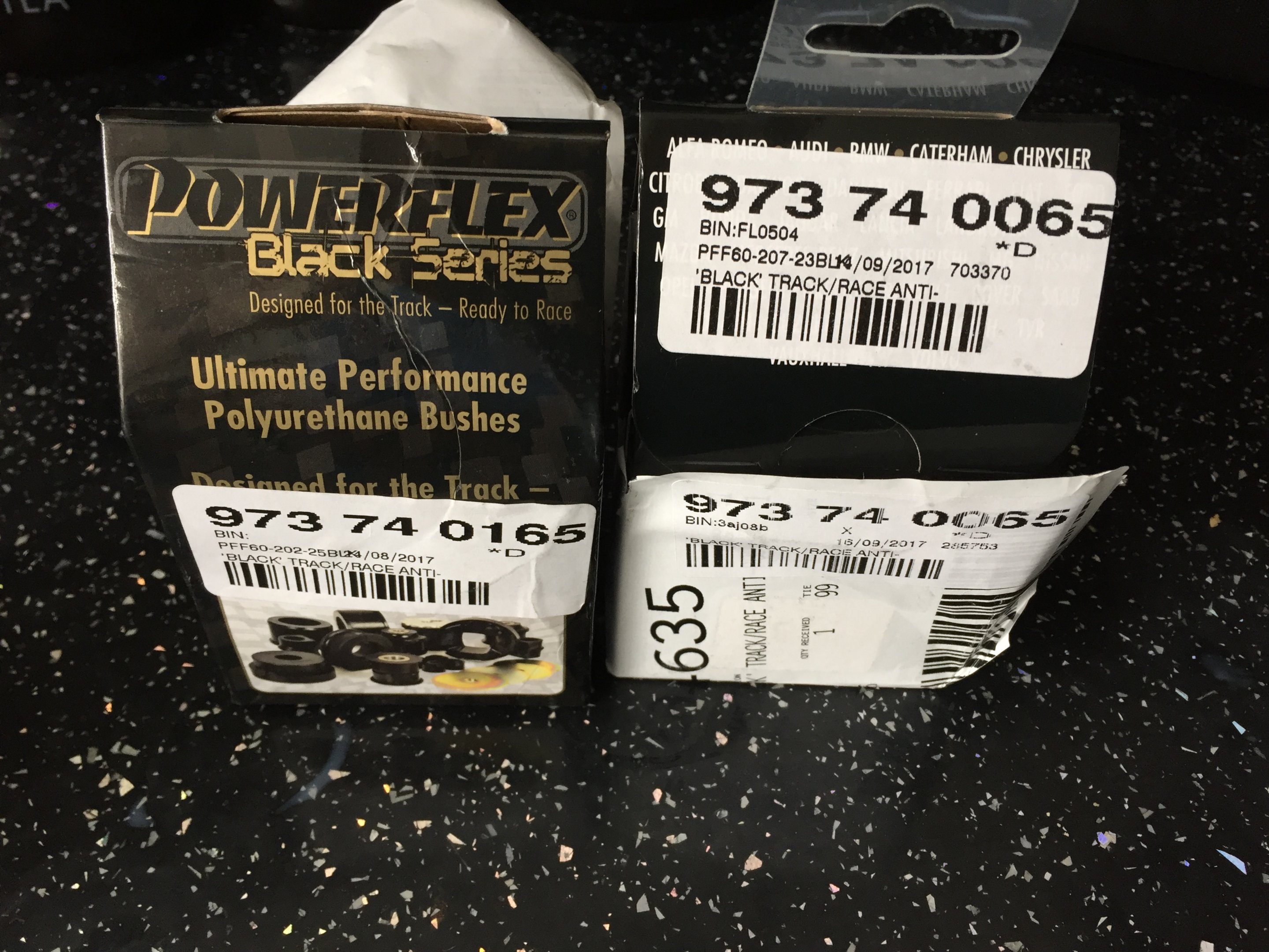

Black Front ARB Bush 23mm Outer - PFF60-207-23BLK (ECP Part Number - 973740065)
Black Front ARB Bush 25mm Inner - PFF60-202-25BLK (ECP Part Number - 973740165)

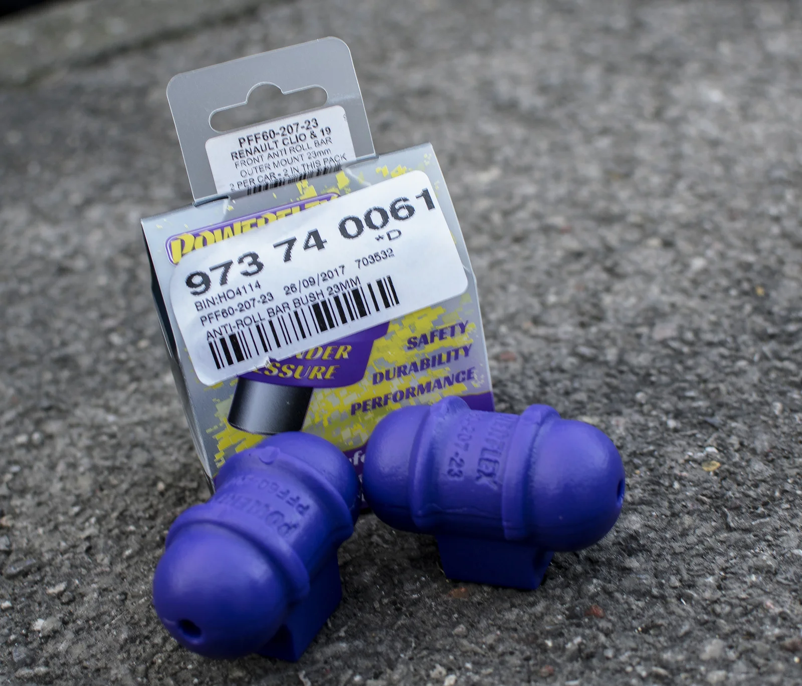

Rear Upper Shock Bushes - PFR60311 (ECP Part Number - 973740271)
Black Rear Upper Shock Bush - PFR60-311BLK (ECP Part Number - 973740275)
Same numbers for ph2 172 & ph2 172 Cup.

25mm inner
23mm outer
For a FF 182.
