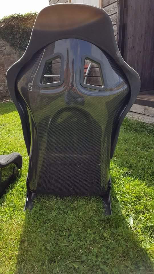

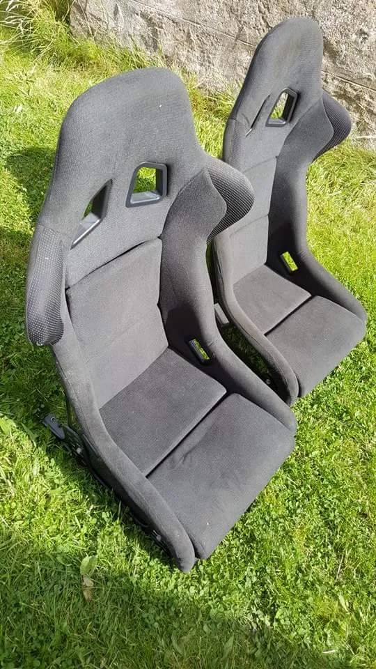

Hi all, I'm looking at buying a set of buckets this weekend, the photos look to be real carbon fibre but there's no make on the seats.
I've had a look on Google and come up with these, they're very similar and the patter on the back of the seat is identicle.

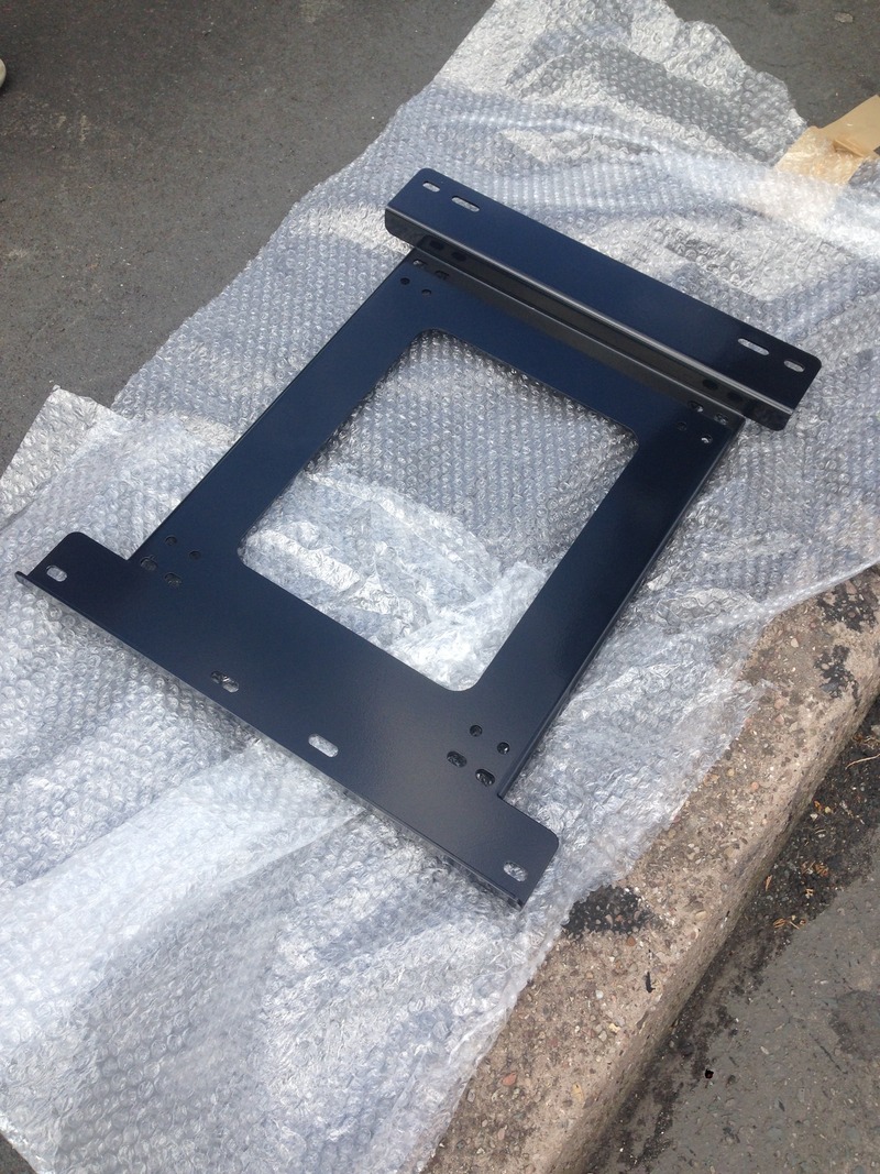

You also need clio specific subframes. That link says the mounts are available separately too. GSM in Nottingham have a great choice of seats and iirc a special package that is Clio specific with all you need. Sportsseats4u.co.uk
JON FOZ
  EVO 6
The sidemounts are not included with the seats.
You will need sidemounts and subframes.
I have my VBD X-Low Clio subframes in the group buy section on here.

Sorry I meant that I've already got a set of seats lined up and they look like the ones in the link above. Didn't type it very clearly.
The seller says he has a sparco mount and an OMP one. Guessing ill still need the clio subframes to go with those yeah?
