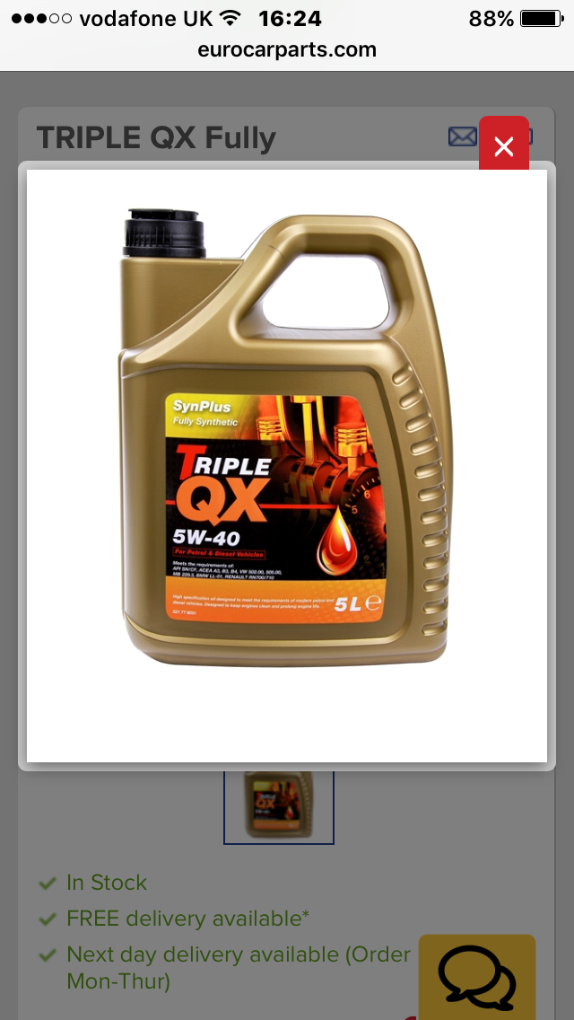

Usually £25-30. Have a quick browse, the TripleQX stuff is mega cheap and actually quite decent stuff.
will of probably been around £13-15 then on friday special, might check tomorrow. had the petronas a few times when it's been on friday special, been a bargain.

Anyone been using this oil?.ive been using it for a while from ECP.
Best oil to get from ECP is Gulf or Shell do you think?.
