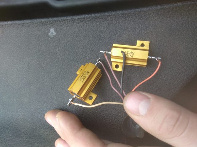

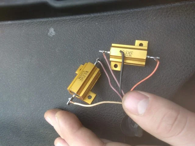

Alright, quick update to the thread, ordered some resistors and have soldered them in - I also got the airbag ecu fault cleared, but it looks like it might have returned.
Can someone confirm I've joined the correct cores? I definitely didn't mix up the purples, I cut off the plugs one at a time
