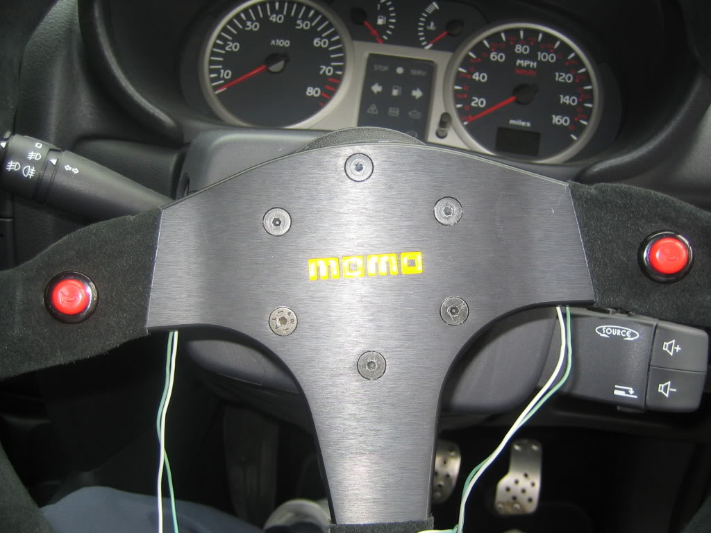

I ended up making a little switch panel for mine and fitting the buttons richy found back on p1. just need to wire it up now but not going to have chance for a while.
Excuse the poor quality phone pics:
  My trusty lil 182 :)
3mm perspex. I might redo it I think; because the buttons are smaller than I thought the panel looks a bit strange. Any luck on wiring your's up yet?

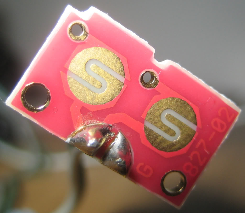

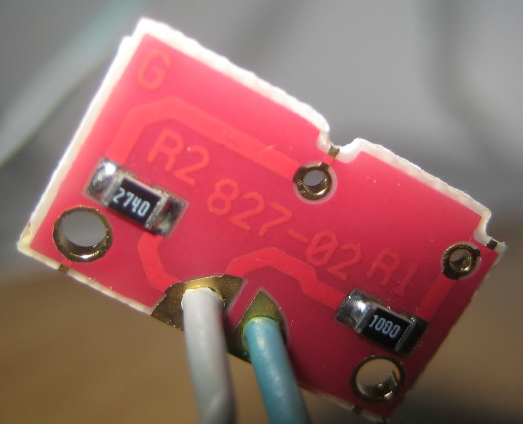

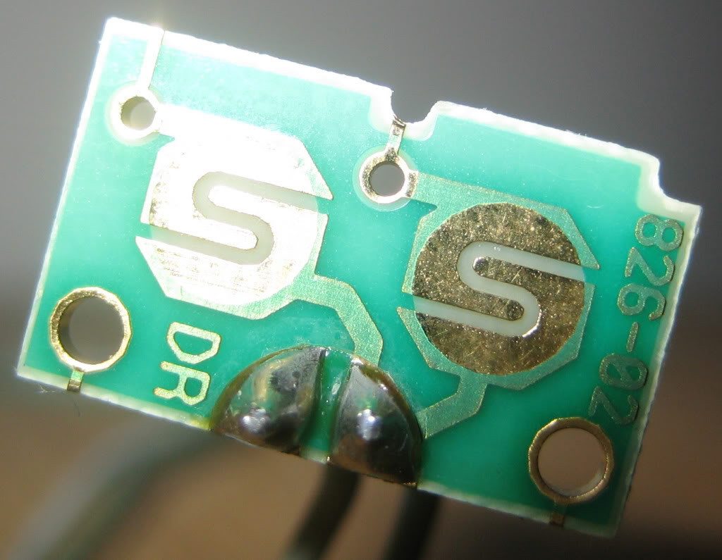

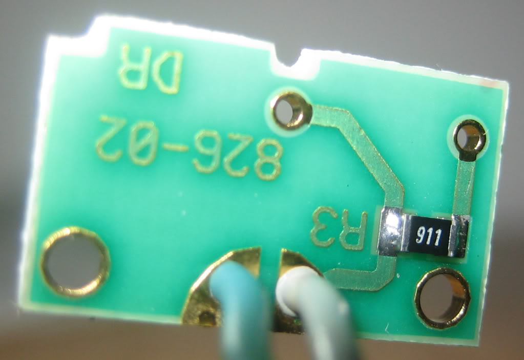

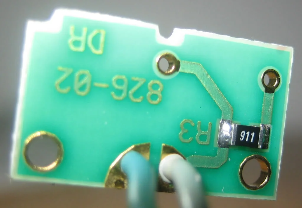

My electronics friend had a look at the set up for me tonight, he wasn't 100% on the circuit boards so wanted to see what was on the back of them, so out they came. The green is the R/O switch, the red is the +/- switch...
Both circuits are different and they appear to have resitors in them. He's pretty sure that he can make it happen, but he's going back to have a think before we move things forward. Keep you posted.
  Bumder With A Buffer
Ahh all the resistors are doing is pulling the voltage down to ground it seems. They are different because the ecu will be looking for different voltages to. The R/O is like an on/off yes?? Hence why that one shares the same value resistor.
The Red one has different values as id imagine the ecu take below 6v for speed up and over 6v for speed down (or something like that)
The thing that interests me is on the bottom picture above... all of the holes and the 2 vias (smaller holes) have a track on them which looks like it goes around the board to the other side..but they dont! Where do they go? In fact its the same on the green pcb.

Speaking of resistors...
On a serious note if you wanted to send me the stuff id whack it all together for you? Wont charge you anything for it.
i've still not got my old wheel off :eek: If the offer still stands when I eventually get round to it I may well take you up on sorting the electrics :)

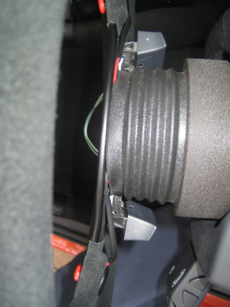

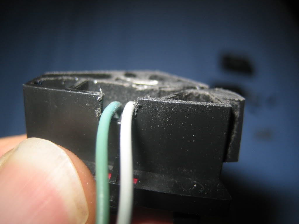

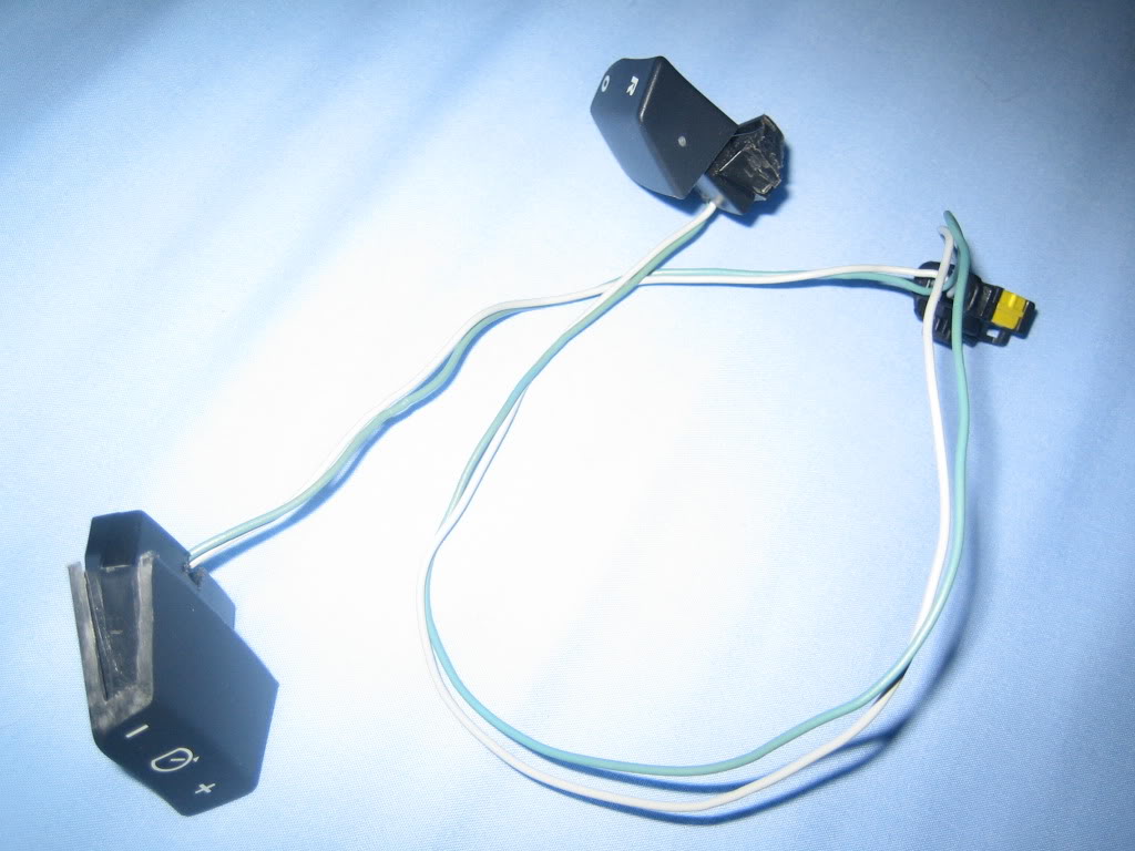

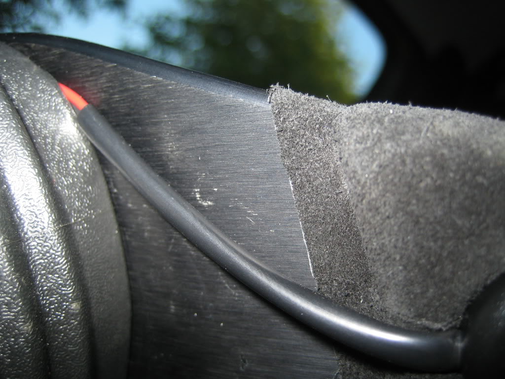

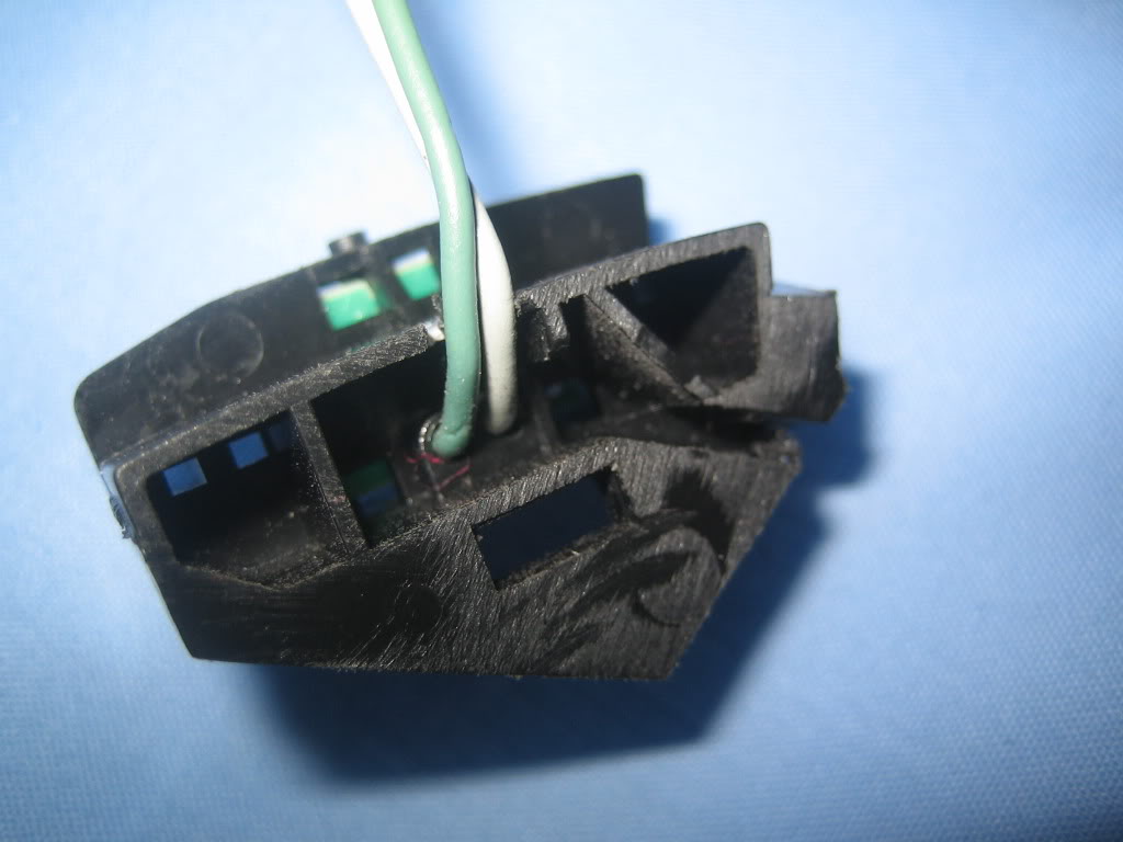

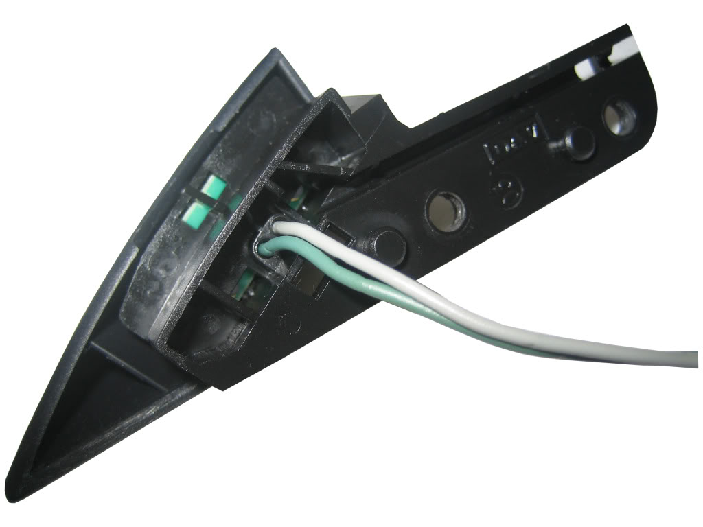

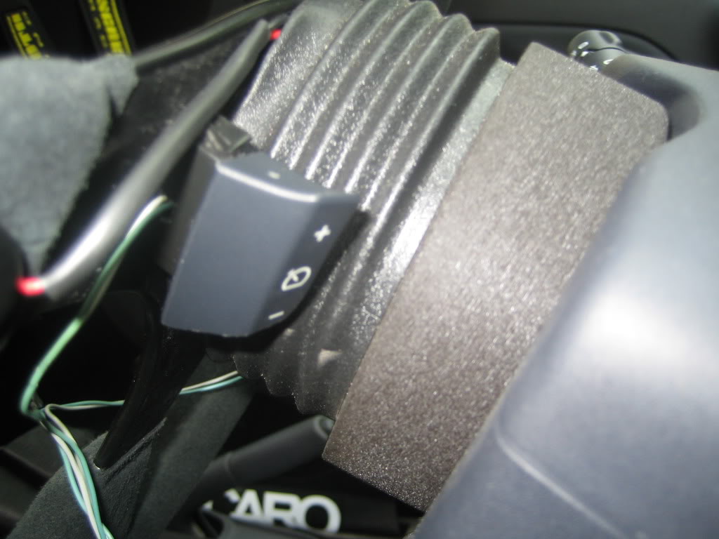

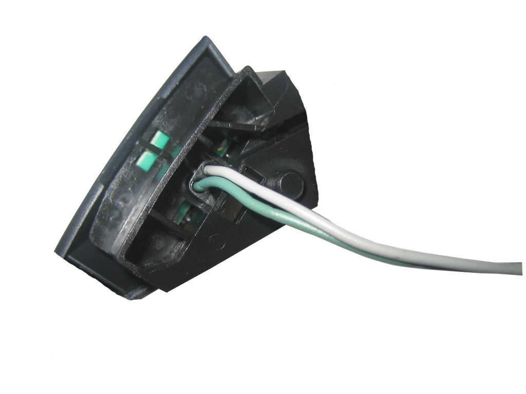

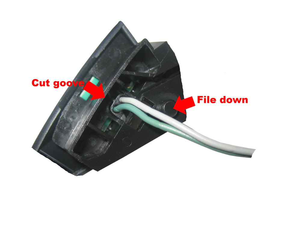

Indeed. And now I think I may have an even lazier plan. It goes a little like this...
Take the large OE unit...
Trim the body and the switch cover to make it more compact...
Cut a groove for the wires to sit in, and file down a circular section to make it flush...
And mount to the rear of the wheel...
Then all I'd have to do it mark the front of the wheel with decals so I know what the buttons lurking behind actually do.
I'm pretty sure it wouldn't be seen at all when in the driver's seat. The only downside is that they won't be in very easy reach, but for the amount of times they are used I don't see that as an issue.
Now all I need is a good way of attaching the plastic mounts to the metal wheel. I'm thinking the only option would be to bond it with some sort of adhesive?

It's getting closer. I've been off sick(ish) and therefore there is progress.
The brackets have been re-shaped:
And it's been trial fitted for positioning behind the wheel:
Now all I need is some epoxy adhesive (I think), some electrical tape to tidy up the wires, some decals made up (post-it notes will make do in the mean time!) and to remove the wheel for fitting.
Before I mount it permanently I'll be testing all the functions again on the road. So maybe this could be up and running in a week or so (hangovers dependant).

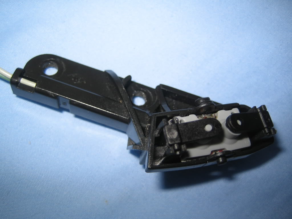

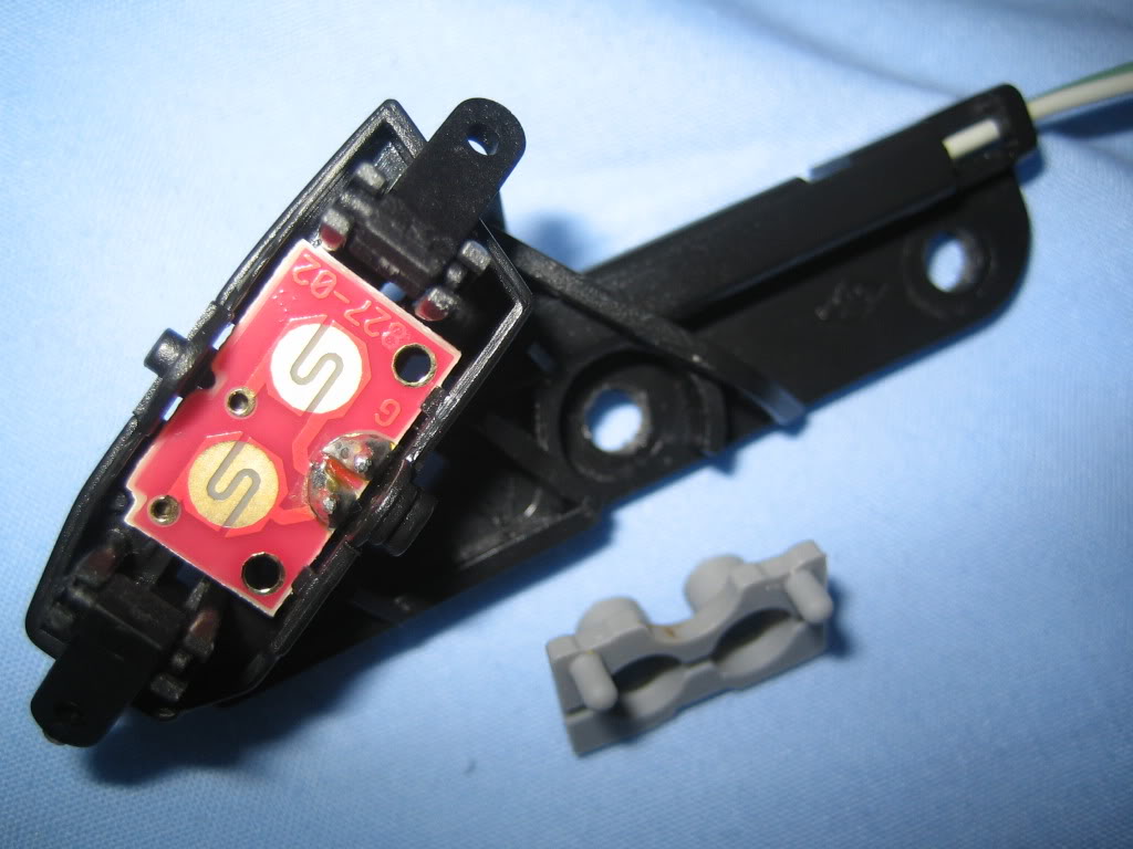

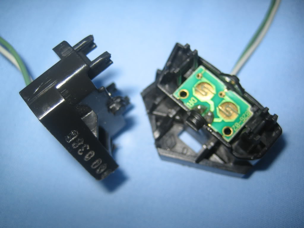

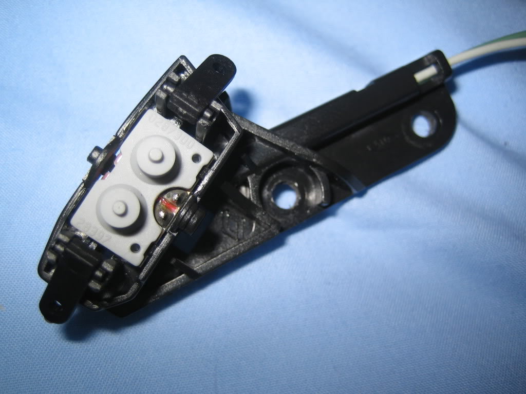

What makes contact with the pcb? does the switch just have an in-built spring mechanism each end to self level?
I was thinking about this the other day... might knock something up on CAD and then get it prototyped. Wouldn't cost much as it's a small lightweight component!
  182 Cup
The little grey rubber membraine makes contact with the PCB and also acts as the spring mechanism, the small black arms are to maintain position. See pics...
Not entirely true about the grey membrane bit (well in a way iit is!)
Inside the grey switch membrane is a black conductive disk (cant remember what its made of!) that when pressed down onto the pcb makes the contact and is picked up by the ecu.
Like you knew though you can use any form of switch in place of those ones providing its a momentary switch. You could knock that whole set-up into something easily...you just have to use the correct resistors ,as each signal is different.
Interestingly after re-looking at the pics with the resistors showing I think I could draw up a schematic for this in about 5minutes when I have time/can be arsed! People could use and make there own??
Although I would like to get my hands on the whole loom so I could be sure of whats going on.
