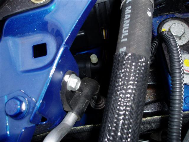

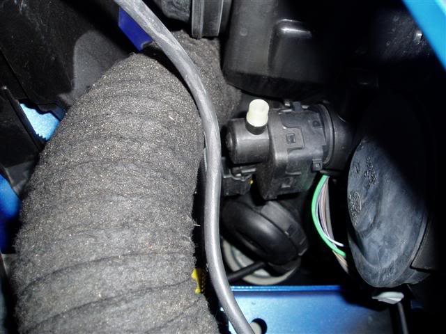

Adjust them with the white allen screws with the engine running , if you don't when you turn your engine on they will adjust themselves back again .

adjusted them last night and they seem ok now can actually see the road put about one full turn on them which has made a pretty good difference without blinding the world... will drop it to my mates garage and use his level testers wall thing and get them set right soon...
thanks guys
oh 6mm allen key for your info
