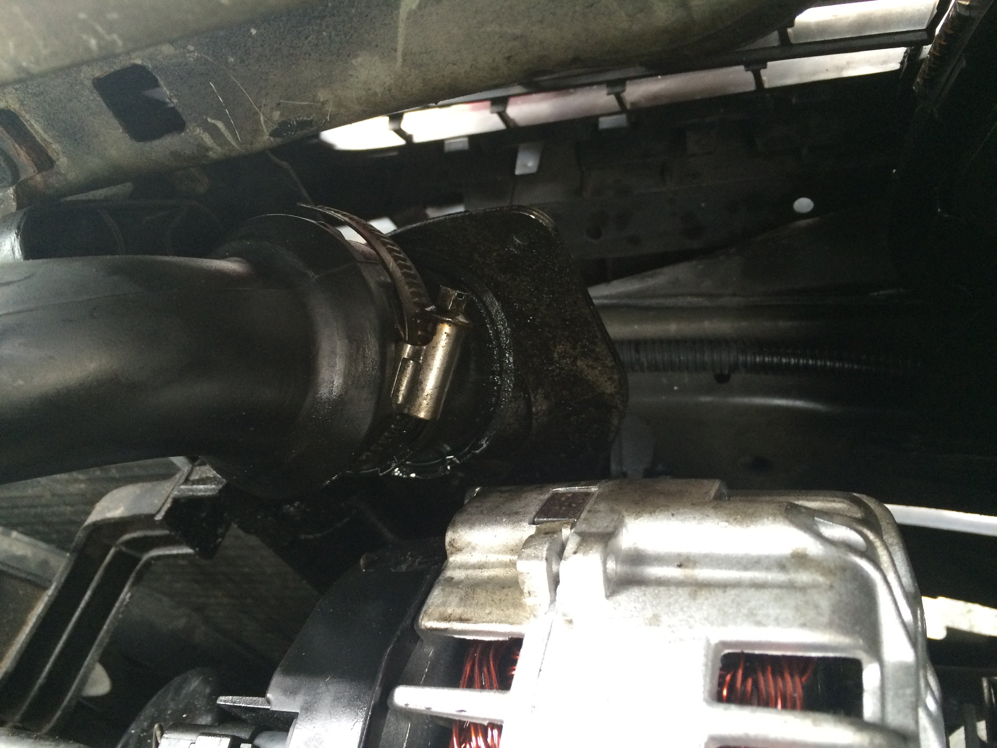

This is where it was detached:

Update: Seen by another motor mechanic. The pipe needs to be reconnected to the IC with a new seal with all the oil and muck cleaned up around it. That should stop the hissing noise when turbo kicks in.
One question I have to you guys is whether there is supposed to be some oil circulating through this pipe into the IC? The oil which you can see in the image above much have originated from the pipe. If its not supposed to have oil, then it means the turbo is on its way out? But if its normal to have some oil circulating through this pipe and the IC, where does it get collected?
Diesels will naturally breathe a bit of oil mist into the intercooler pipework. I'd say if the pipes are a bit wet its not really anything to worry about but if there's actually oil pooling in them and enough to drip out an unconnected pipe then that's a problem
Well, I was driving the car without the pipe connected to the intercooler for a while until we discovered that was causing the power loss. I don't think its leaking any oil now, but the pipe needs to be secured on properly (it was simply moved and locked into place at the garage). I think getting new seals and cleaning it all up is in order. I just thought that it might not have been normal for oil to pass through these pipes, but if it is I'm a little relieved. So does this oil get fed back into the engine presumably, or collected in the IC?
