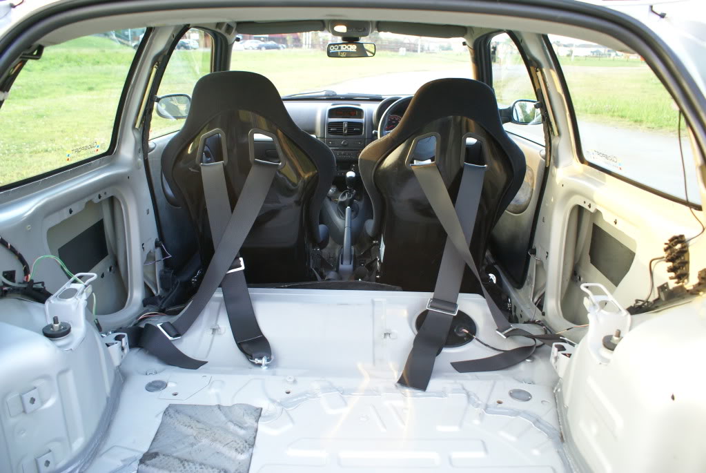

I have a 4 point harness (with Bimarcos btw). I mounted the front two points in holes I drilled in a good spot just behind the seat.
The rears were easily mounted in the holes that the ISOFIX bar attached to.
All were secured using proper spreader plates etc

This is where i mounted my harnesses.

Chrispy.clio, any more pics in detail of where you mounted those?

My rear ones are the same as Chrispy's.
I'd watch the front ones though, I WAS going to mount them in the holes where the seats came out but I think they were too far forward to work well.

every one i know with 4 point just use the iso fix bar mounts,
and the bolts where the clips bolt to the floor plan
