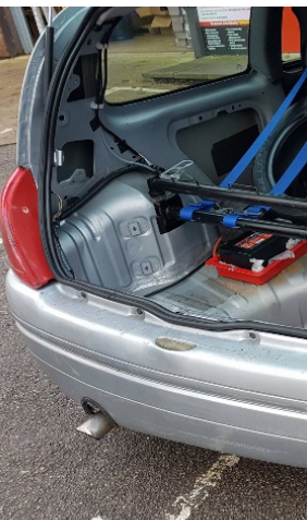

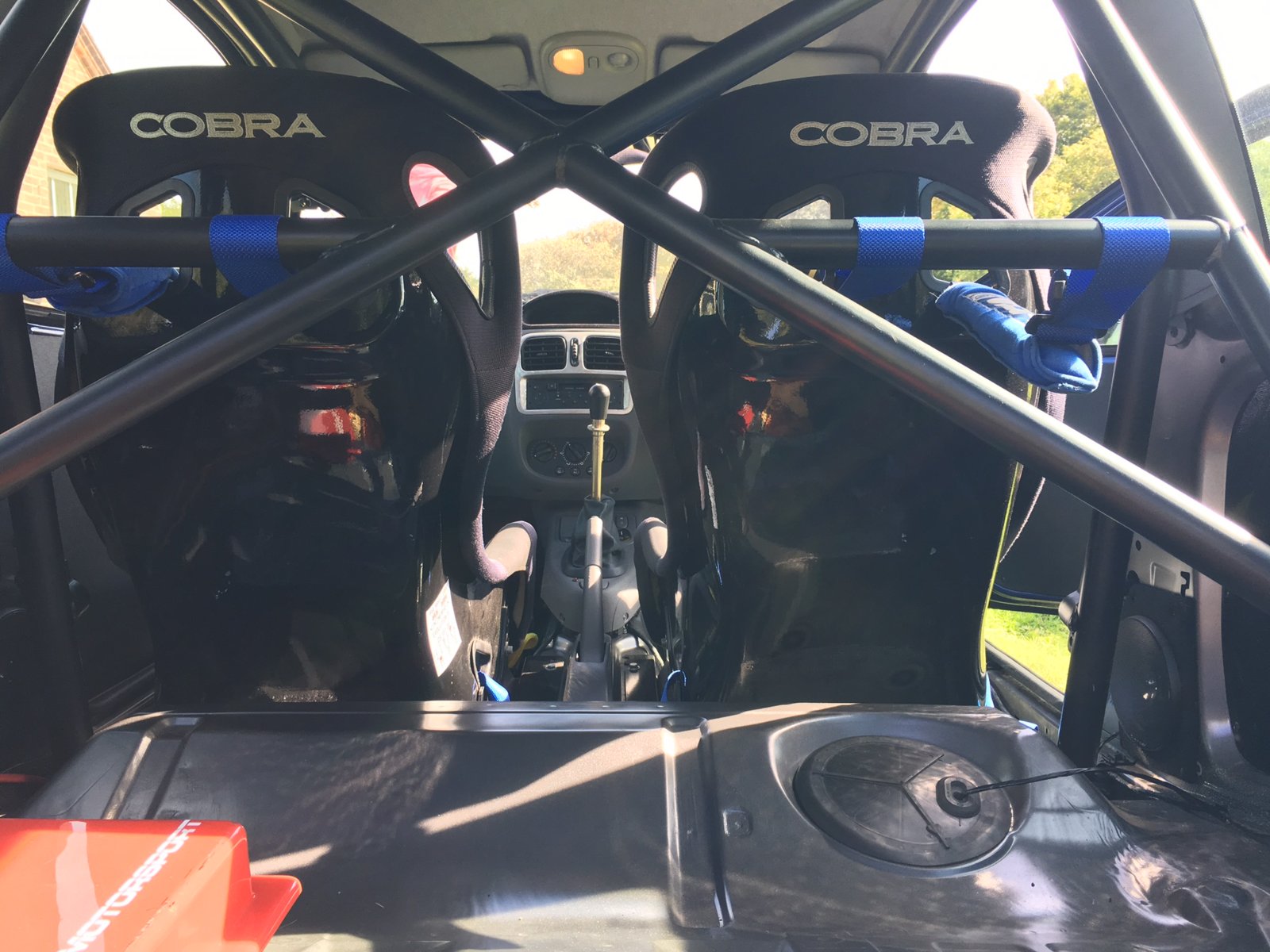

  Hi comp phase 1
This is my old shell with a harness bar welded in...only pic I could find after I wrote it off:cry:.
When I got the seats and harness I thought using the existing seat belt points was a bad idea so I got a roll cage company local to me to do it....it served me well for a few years...even when I crashed!
Since then my new shell got a proper(bolt in) cage and they are well worth it..not just for the harness bar but a stiffer shell.
I did wait for a second hand one to come up for sale. I just had to get the weld in towers from Safety devices.
