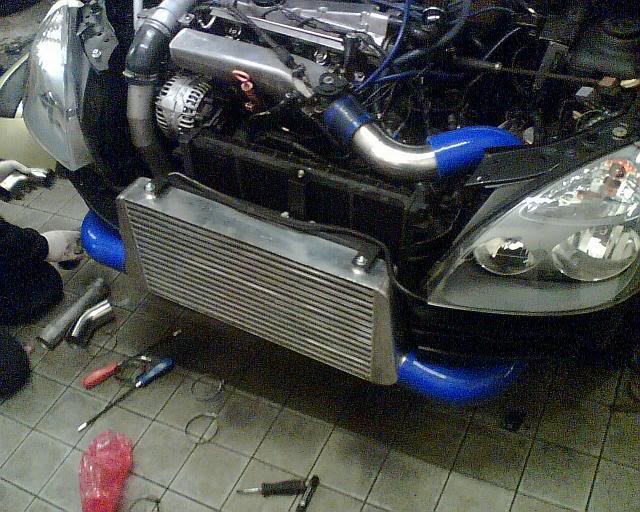

at the moment the car is in a sad way. The 20v engine is in place with mounts made.. but thats it. ane even there in the wrong place. Ive told Dave (floddie) that im starting again from scratch.
not 100% settled on the spec yet but it should be 300ish bhp on a td04/ihi turbo with std internals, Emerald ecu, evo intercooler, 440's and a few other bits.
should be ready for a few track days next year.. hopefully?

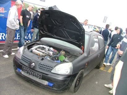

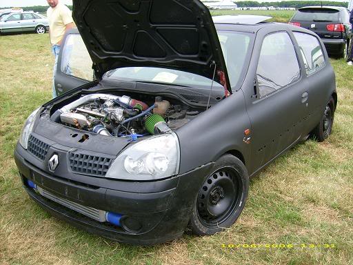

No they wont - the original Clio TT i built in 2004 was running over 400 bhp in a 750 kg car.......
I used to pull up at GTI international and nail most golfs and audi's running the same block.
My pal jordy is running nearly 700 bhp in his car now and his quickest time to date is a 10.07 @ 141 mph.

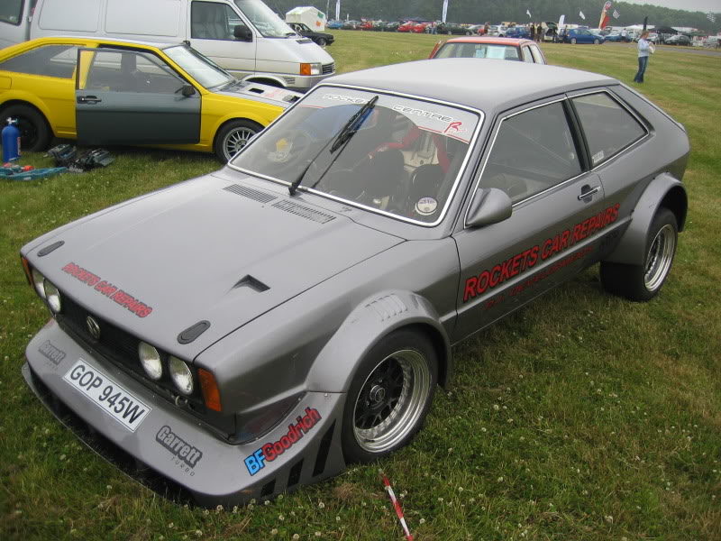

Unusual choice of turbo ?
The scirocco is now fully built and raced at a few events last year.
