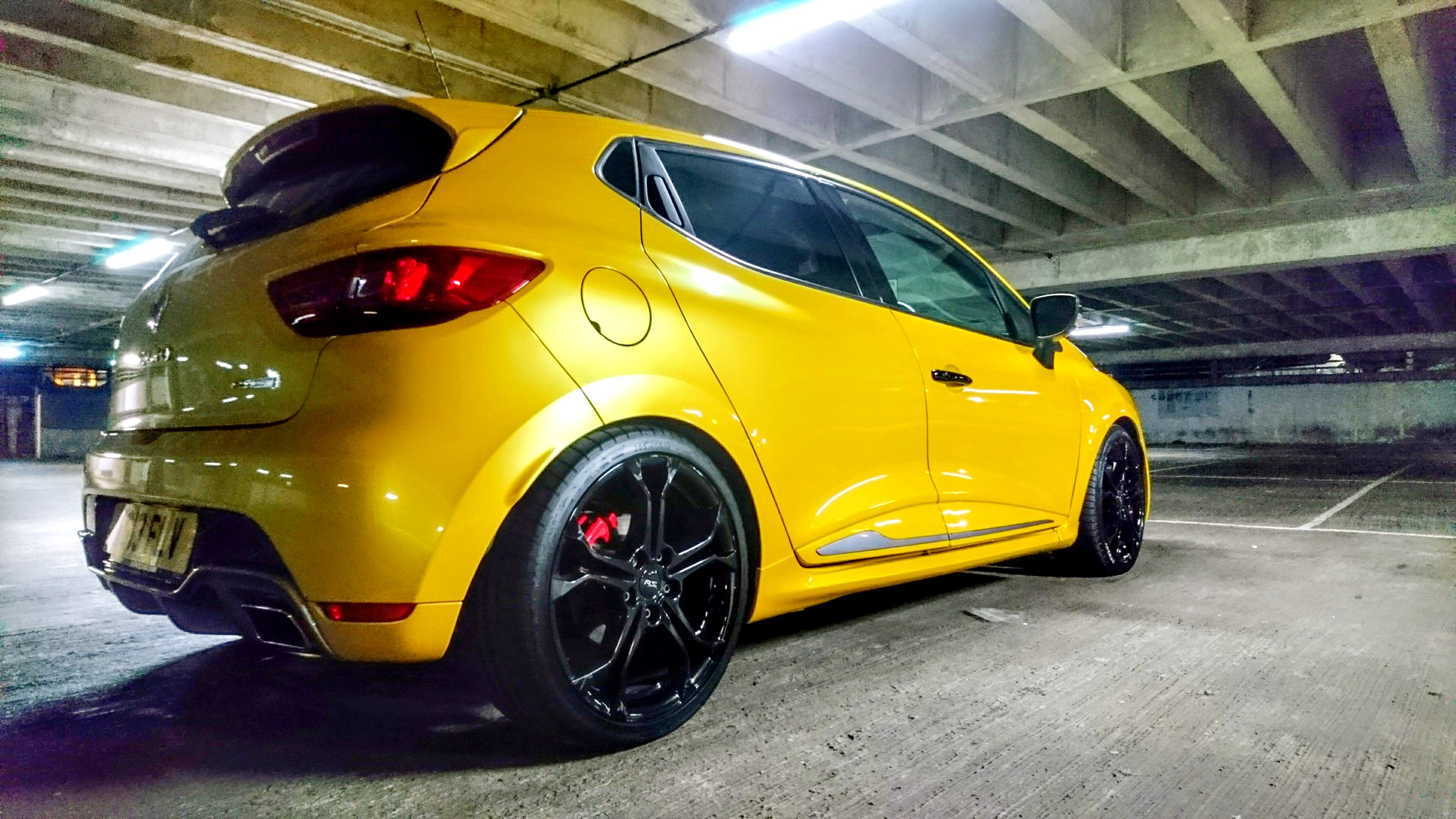

I'll be honest the wheel IMO won't want spacing out that much, the rears are already close to the arch edge more so than the fronts. The rears maybe 5-10mm, fronts 10mm maybe 15mm max.
Again, based on my findings just lowering on Cooksports makes a difference by filling the arches and giving you a much better look.
BUT if you're looking to space out then it's a 5x114.3 stud pattern and 66.1mm centrebore. Anything over 5mm you'll need longer wheel bolts.
Try Googling TT Tools or on Facebook, they custom make spacers to any requirements.
OE wheels on Cooksports
