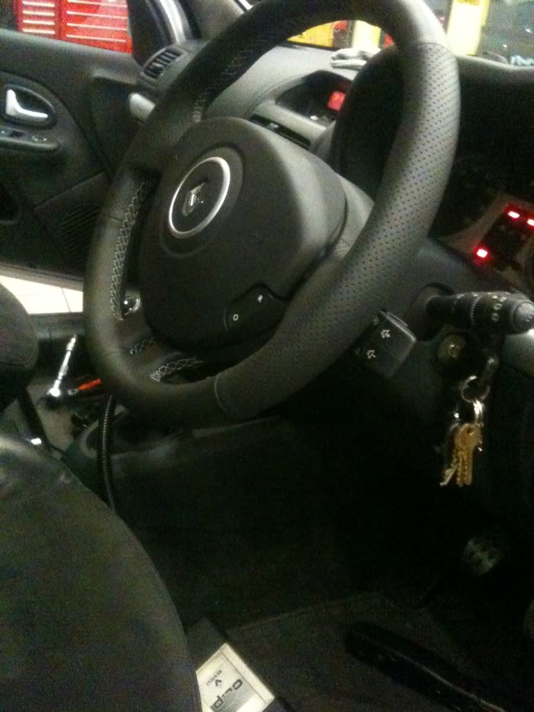

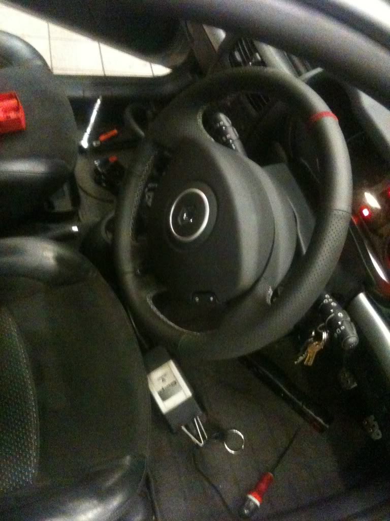

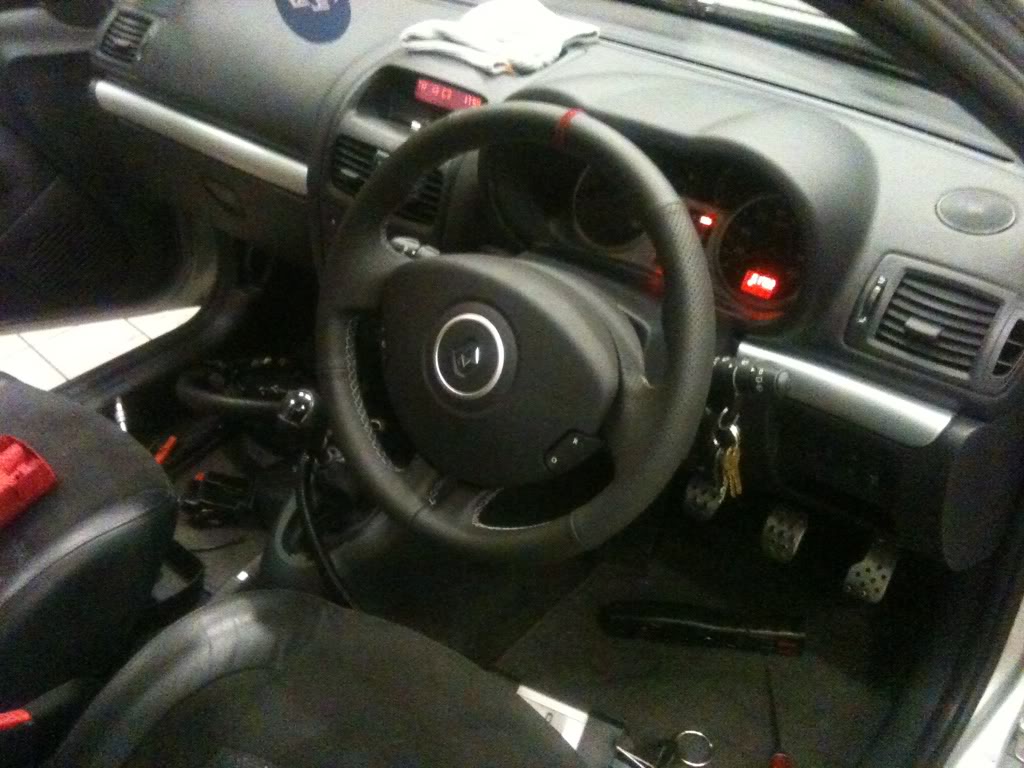

Right....Tonight after work i fitted my bargain of the century brand new 197 wheel and airbag.
Tbh its not exactly clear on here what it takes to make them fit. So.....
The 197 wheel bolts straight on, same splines etc... the wheel does rub and doesnt self centre atm but its gradually becoming better and it appears to be rubbing away the cowling which i think is causing this.
Cruise control... Requires the 182 block connector cutting off and fitting to the 197 CC loom. (green wires to yellow, darker wires to each other) Hey presto cruise control working.
Airbag....Requires some "modification" to the n/s "orange" connector to get it to fit into the bag, the o/s "green" goes straight in. Airbag values checked on CLIP all seem ok.
The only difference is the 182 airbag seems to earth through the column via the wheel where the 197 wheel has a separate plug this needs adding in.
Unlock airbag computer via CLIP, no airbag lights on voila! although i will be configuring it without a drivers airbag as a precaution.
I would advise only fitting this if your are competent and have done something similar before. And of course to make sure your airbag computer is locked when doing anything airbag related.
Follow this "guide" at your own risk!
