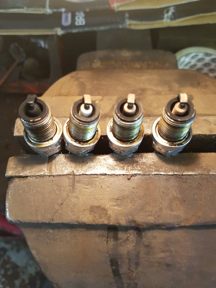

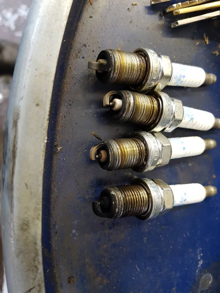

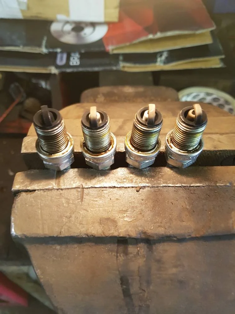

Just changed the spark plugs on my 182, they've been changed last year but wanted to see if anything stood out and it did.
Any suggestions on my next step?
This is cylinder 4 (belt end) with the black deposits

Injector... have it running with the misfire and fuel rail guard removed, unplug one injector at a time (not the injector itself, just the plug), it should run even worse until you get to the faulty one which will make no change to the running. Mine was injector 1 near the belt.
Done this but nothing stood out

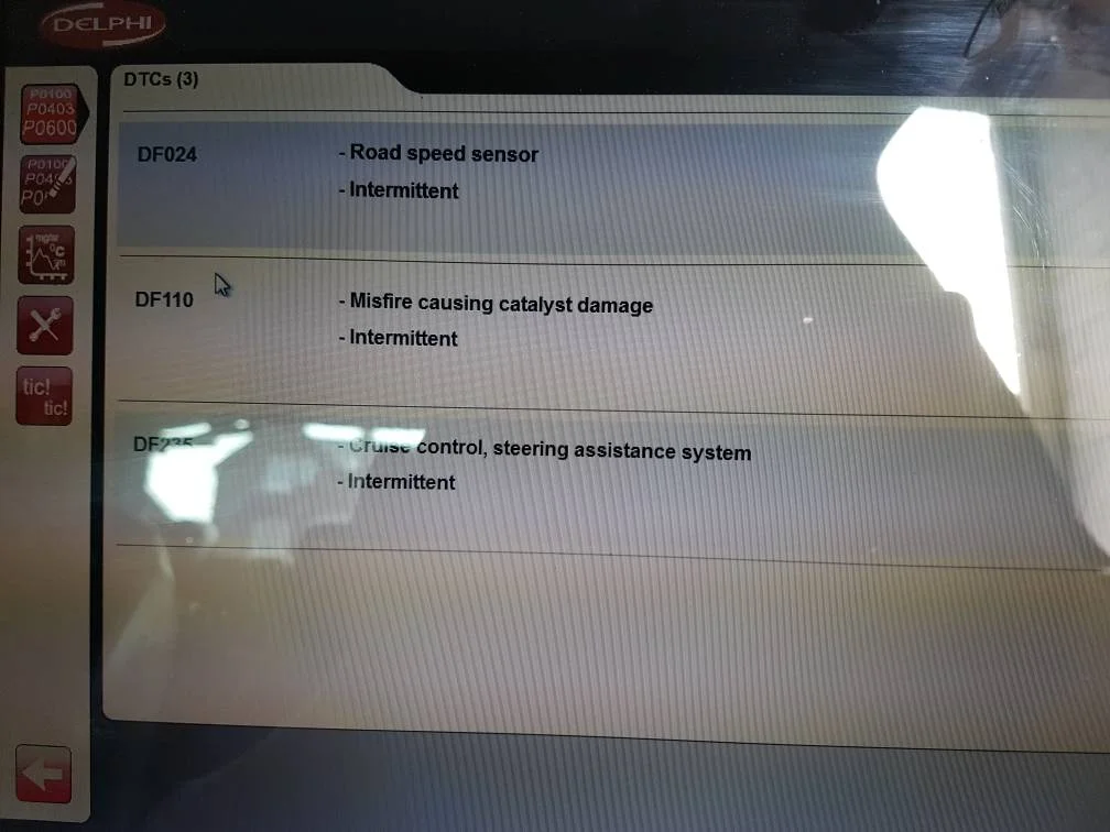

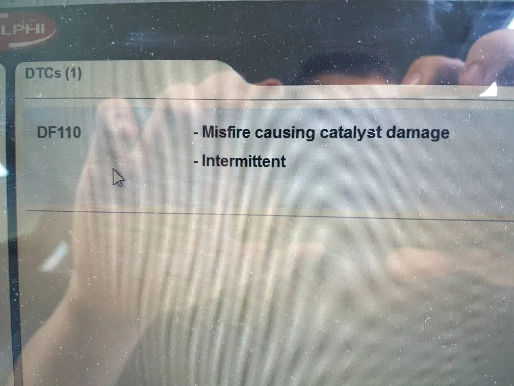

looks like injector, surprised delphi didn't bring a code up but the plug is the give away :wink:
you can check resistance on them if you want.
