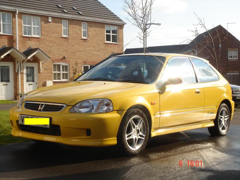

slighty off topic, but can i see some pics of your jordan?
Thanks for the replies...
Here's one......
