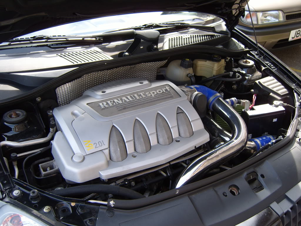

Just got my 172 back from KTR after it's stage 2 turbo conversion (300 bhp) Currently running in on low boost, still feels quick when turbo starts producing boost.
Has anyone else got a turbo 172/182 and can offer any advice or comments.

Yes the standard 172 gearbox's arnt the best in the world, im on my second.
  R5GTT, 2L turbo
the jc5 is definatly not that tough really, nor are any of the jb3 range. the shorter jb5's are even weaker.
I had experience with a 2L high-boosted turbo engine, it broke 3 gearboxes in all, it made alot of torque. for this reason I fitted the shorter 83.5mm crank to my 172 turbo engine so I have 1794cc's. It means I can make much the same power without the mountain of torque the 2L would have made, I just have to rev that bit more. It gives my gearbox and clutch a fighting chance. I still manage to overheat something in the gearbox after 1/4m runs, it often locks me out of gears until I've coasted down the return lane for 30 sec or so. I have a feeling the box will not last much longer :)

change the gearbox oil more regularly (possibly every oil change while your at it anyway) and be slow and gentle with the gear changes and it should be ok.
id avoid full throttle in first gear too (probably useless with that sort of power anyway!)
