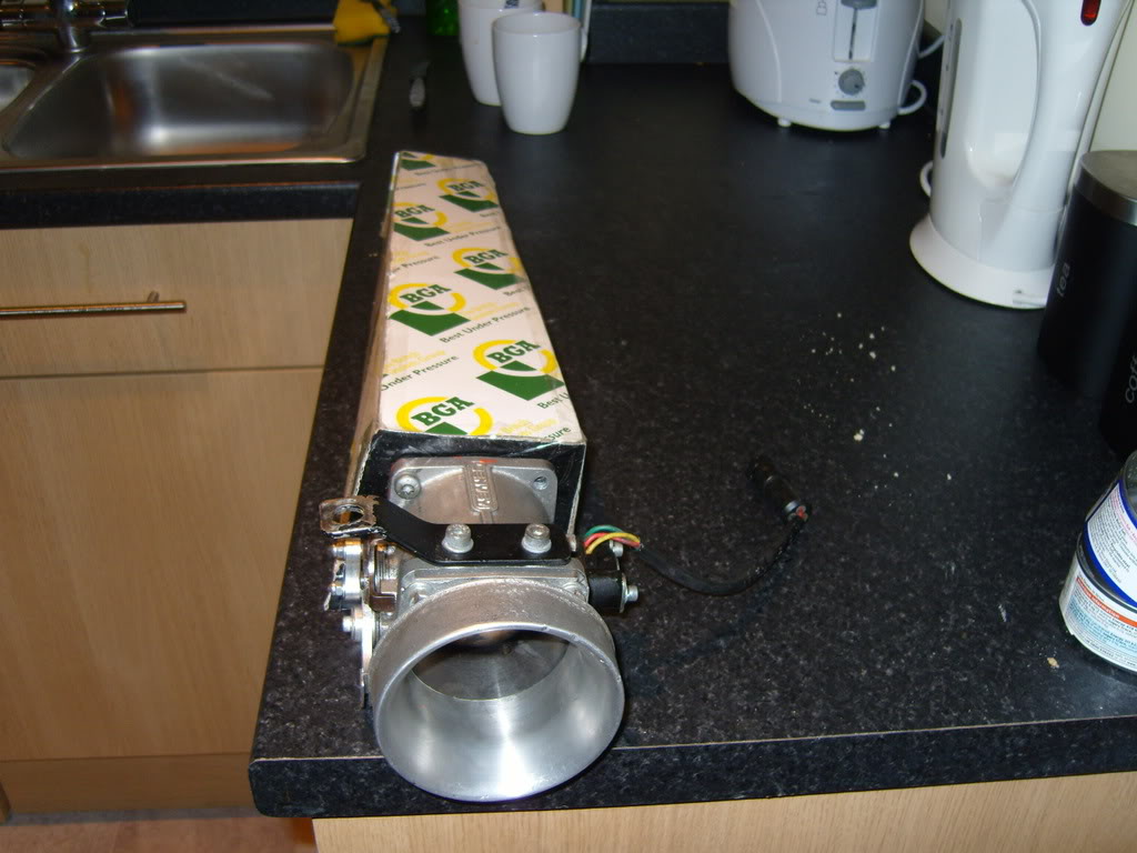

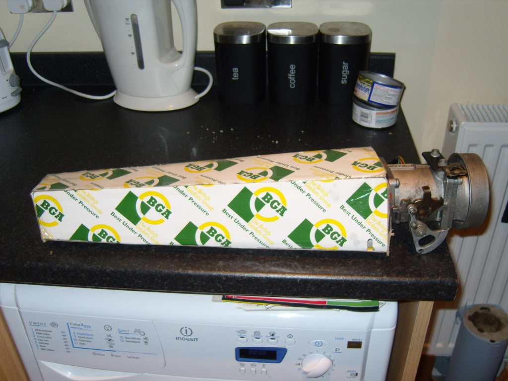

Something i've quickly knocked up, good theory?
  2005 Nissan Navara
Volume wise I'd make it as large as you can physically fit... definately more than 2 litres.
Have you thought about throttle plate size?

In this instance, the plenum dunlop mocked up, the taper will proove not beneficial, hence my comment, also I would consider the volume too small.
Taper can prove beneficial, but I think many are missing the point and best way to use a plenum. IF your plenum is small, if it is straight and ESPECIALLY dependant on the exit of the throttle body and its distance from the major plenum volume, then a taper can 'fix' some of the issues you might run into.
