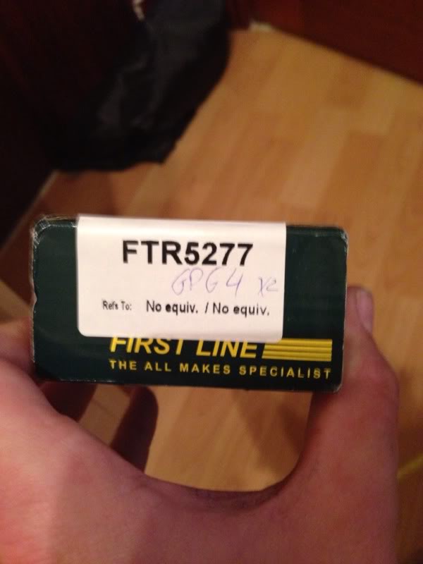

As said firstline is one for sure but I can't remember the others know, mine are still okay. And they ain't dear, £12 I payed for mine.

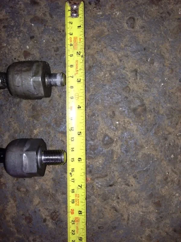

Make sure you check them before booking it in somewhere or go to do the work, I had two different threads on the knuckle, they were In the same boxes with same part numbers. FYI its the finer thread you need.
they have cocked that up, one of those isn't for an SMI rack
  Cup In bits
^^^^ yeah as said its the top is for cup's. They were packaged wrong at the factory afaic as the boxes were all new and never been opened, another was sent out which confirmed my thoughts.
