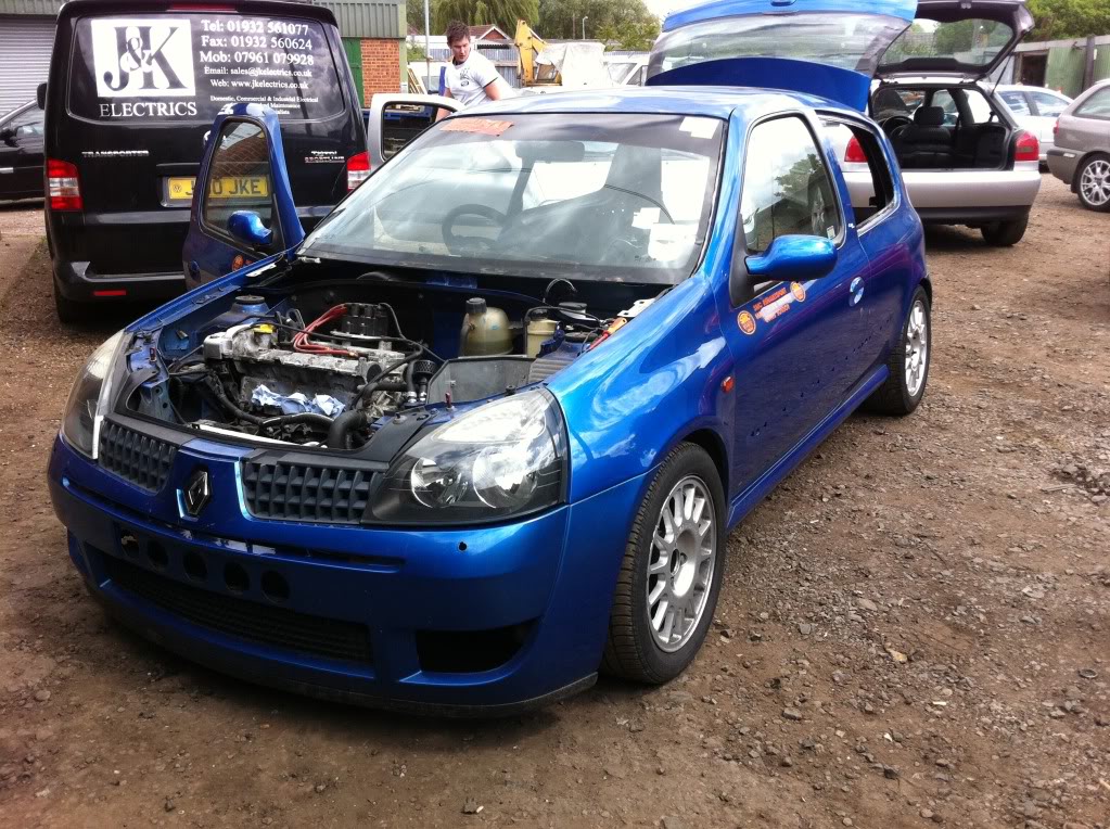

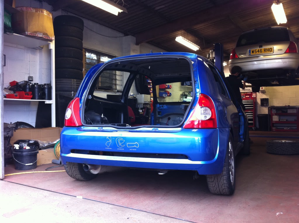

Been down a JMS HQ pretty much every night for the last week and a bit preping the car to go to the Rollcage Fabricators. Suprising how much time it takes to get it all sorted and ready, though tbf I have been a bit lazy/tired from work so wasnt thrashing it out! Anyways some pictures from throughout the week...

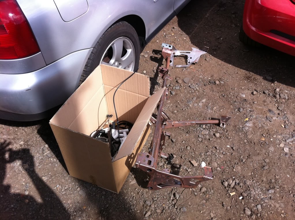

So the start of things, havent got any pictures of all the brackets etc I took out. Took a few big ones out but there is more to do once the cage has been put in.

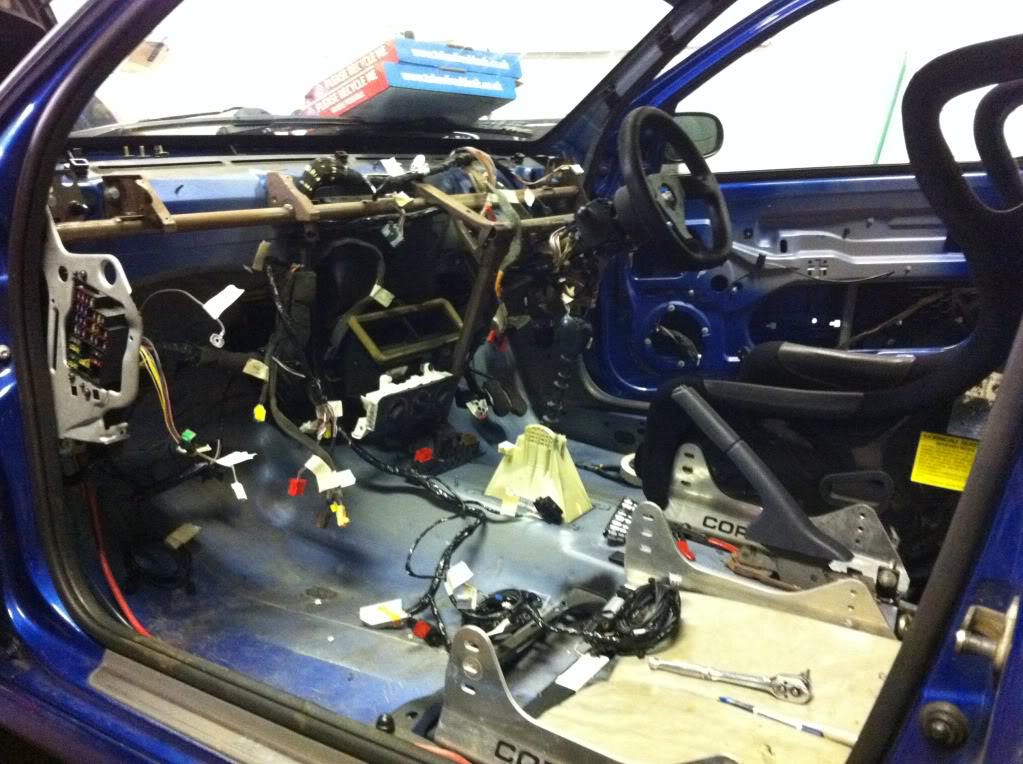

Dash out and labelled up loom for 'trimming and thinning out'
Unneeded brakets/bit of loom so far...

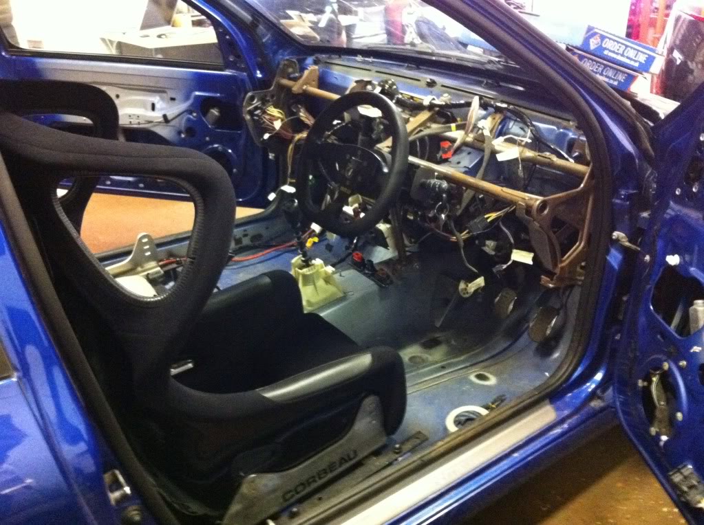

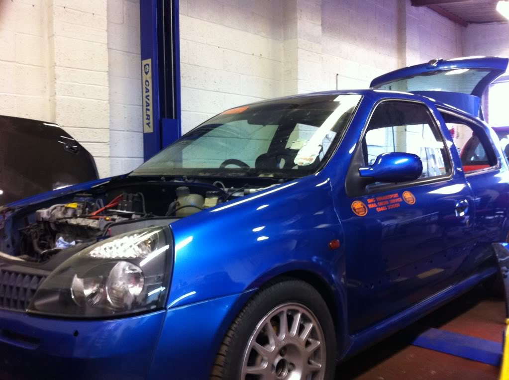

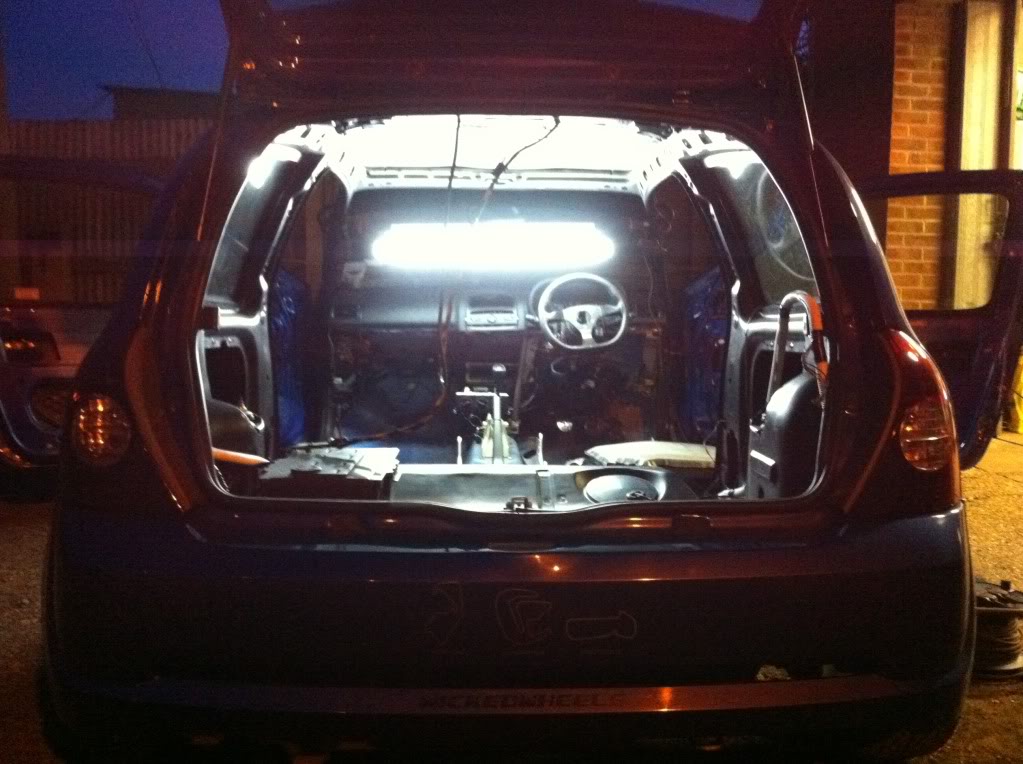

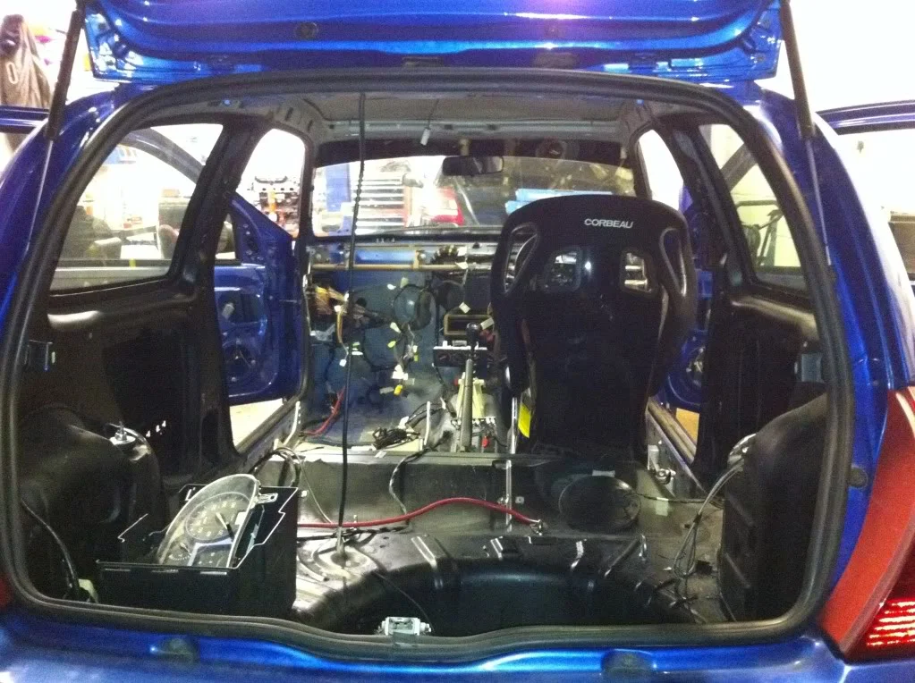

Windows out.
More crap!

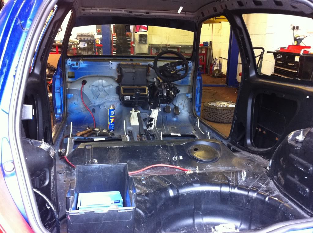

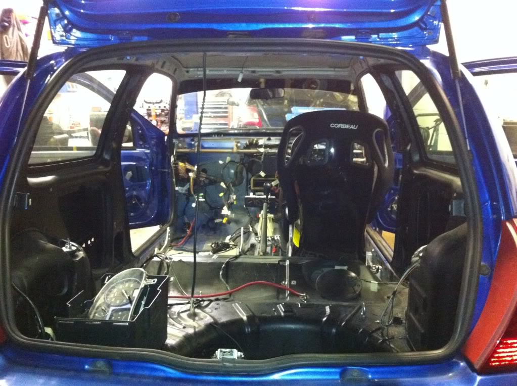

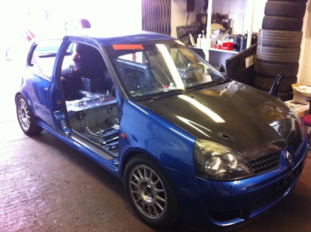

All loom, seats, windows, doors and bootlid out and ready to head over to the Fabricators.
Getting a little bit excited now, always wanted a cage in any of the previous cars i've had so roll on 2 weeks when she'll be done! :)

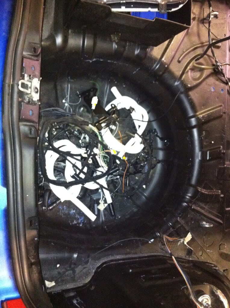

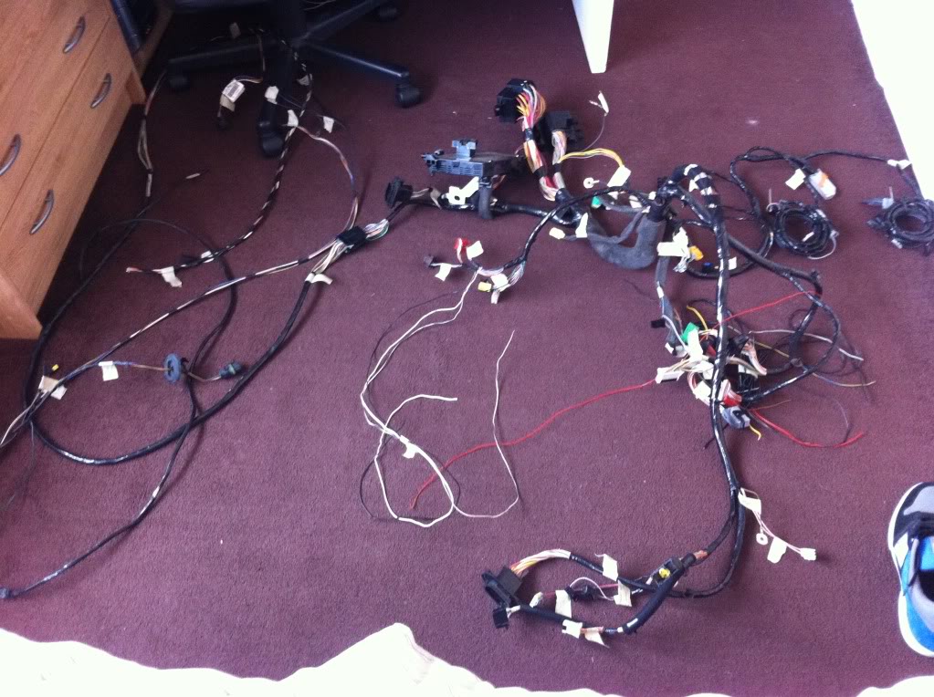

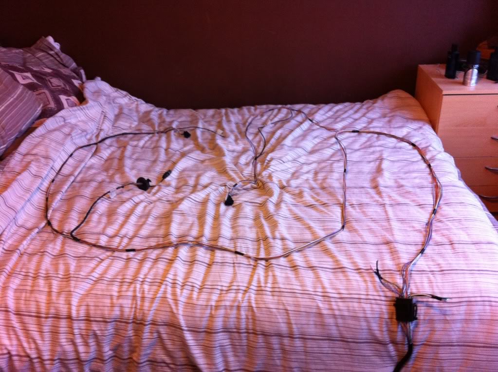

Started on thinning out the interior loom this evening starting from the rear of the car, not too hard of a job really just being patient instead of being chop happy makes things easier in the long run!
The start...

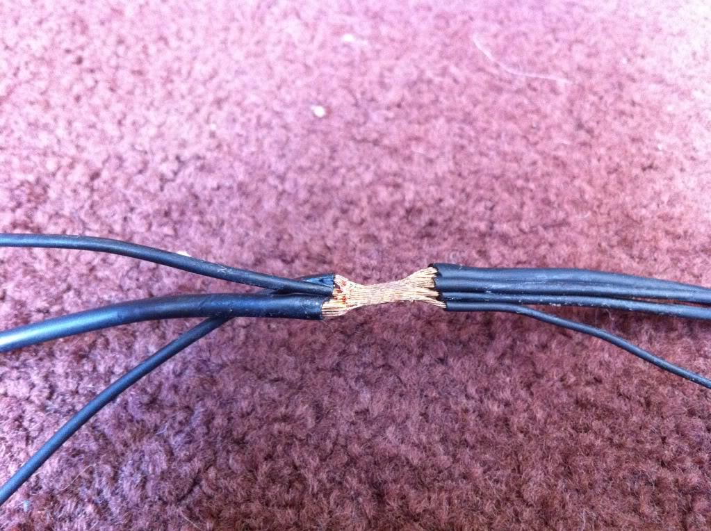

Came across this 3 times in just the rear part of the loom, Renault are pikey as f**k! Just a bit of tape over them as well!
The rear loom finished for this evening, much tidier and surpised how much you can shift and i've been pretty sensible!

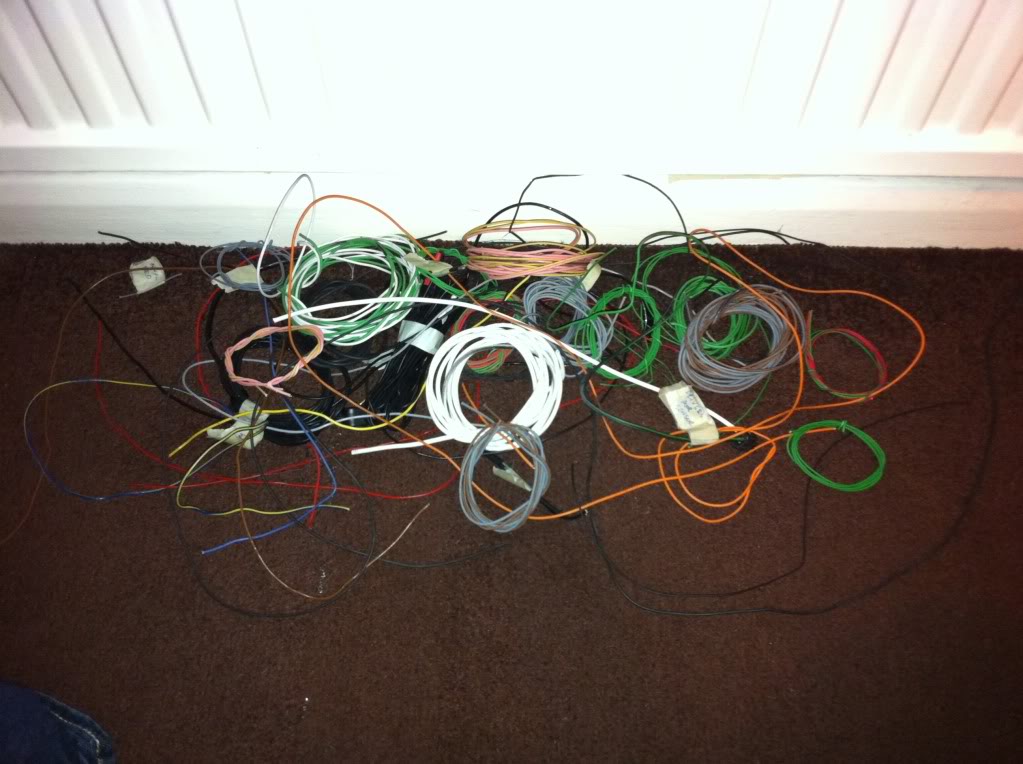

And the scrap from just this evenings work!
I'm just doing a little bit a night with the loom, pretty relaxing tbh though to be fair being a Fibre Optic Jointer I untangle and mess about with Fibre in a similar way but less than half the size normally so this is pretty easy!

As above, are you working to wiring diagrams or off the cuff?
Cheers, not following any wiring diagrams at all. Before I took the loom out I just labelled every plug/wire in the car and things like sterio/boot loom/airbag wiring+pretensioners etc etc can go. Anything to do with the clocks/lights/stalks/engine are all being left, just being careful to trace every wire to where they go before I cut them incase they run to something important! lol
