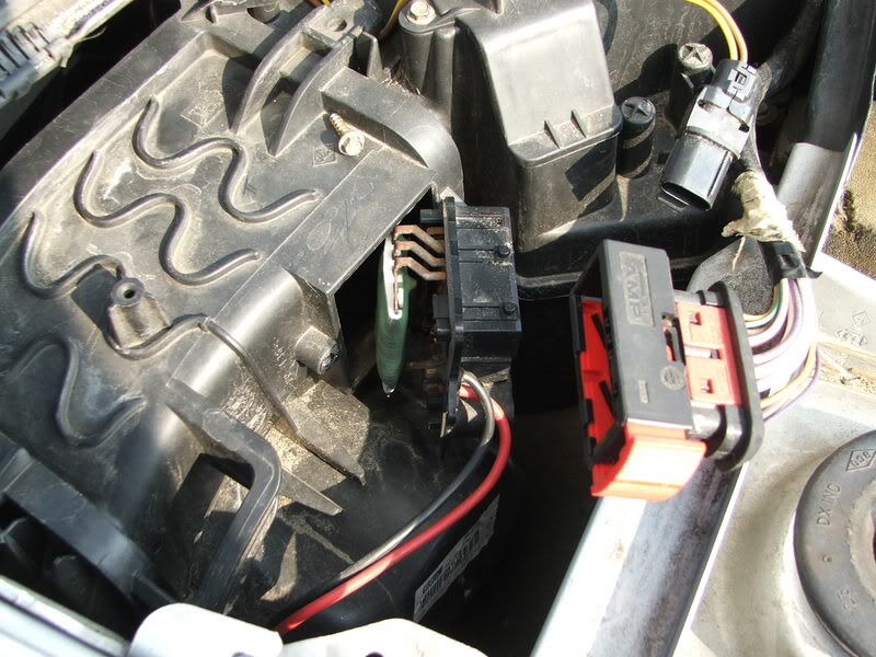

On my 2001 clio ph1 the fan blower working only on 4 (full power)
I read at the forum and saw its a problem from the part above.
I dont find the part, Only the part for ph2.
If someone can give me the part number or the right name/ebay link i'll thank him very much :smile:

Problem solved, i update the details for who that will got the same problem.
Correct part number for my clio was:
7701206104 (Valeo)
There is 2 more p/n, Maybe for other clios/kangoos/megane/snic
7701050900 (valeo)
7701206199 (magneti mareli)
check buy pictures on google and your exist resistor what's the correct part for you (it's have slightly diffrence)
easy fix
G Hut
  ph1 172, V90 T8
Mine has failed and just called Renault,
172 Ph1 part 7701206104 (Valeo) is now obsolete
This Valeo part number and still available 515136
